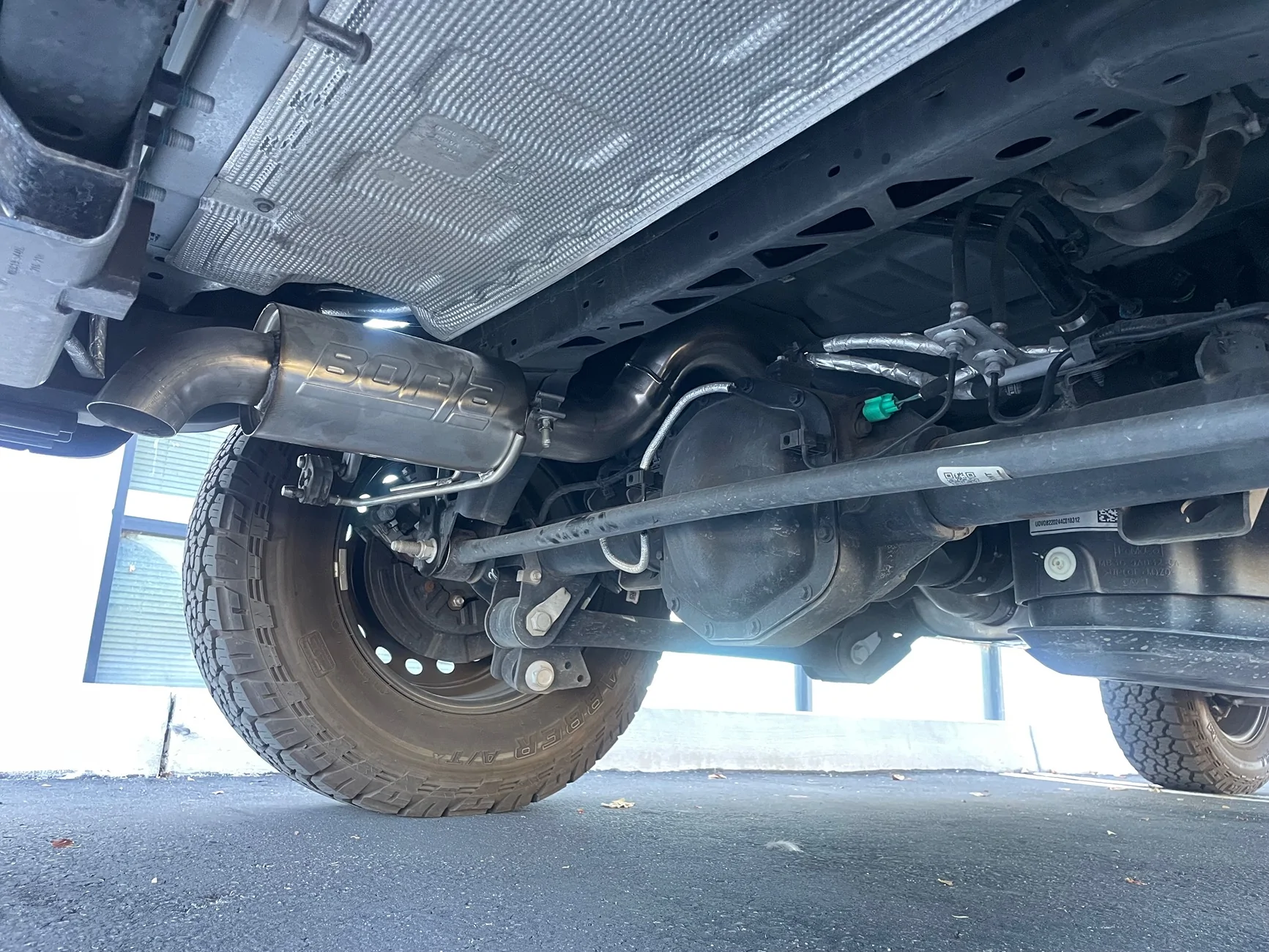

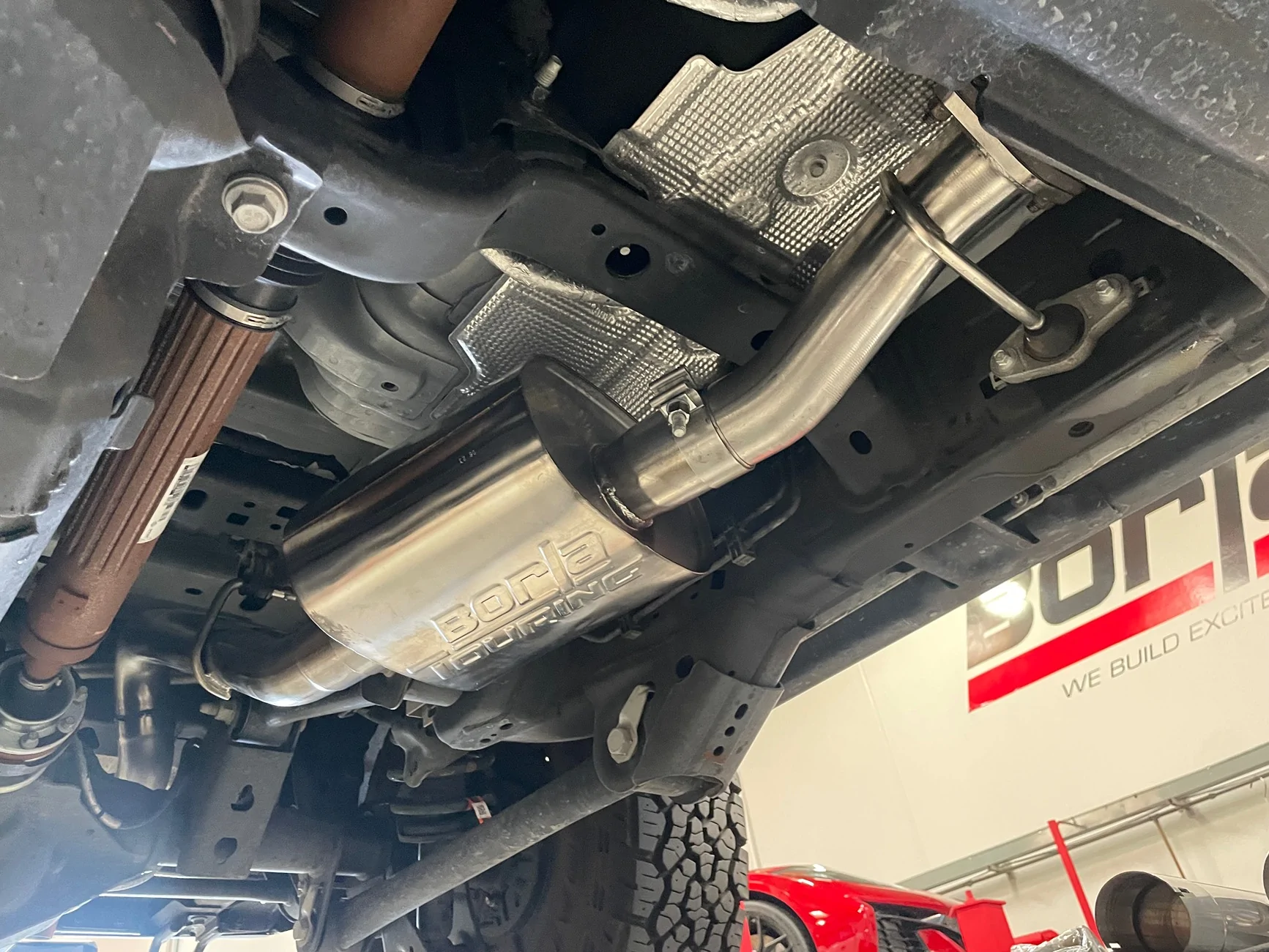

The 2.3L Ecoboost engine doesn’t sound great but it’s also too quiet for me. I also enjoy the engine sound when rowing through gears. For 1-1/2 years I’m happy with Borla 140897 Touring catback with 60725, a short rear muffler that fits both 2.7L and 2.3L Borla catback systems. I wanted a deeper note slightly louder than stock and zero drone which is what I got. The larger than stock 2.75” tubing is perfect (not 3”) for slightly louder sound and less restriction. I’ve seen many highway trips of +22mpg on 87oct @70mph.

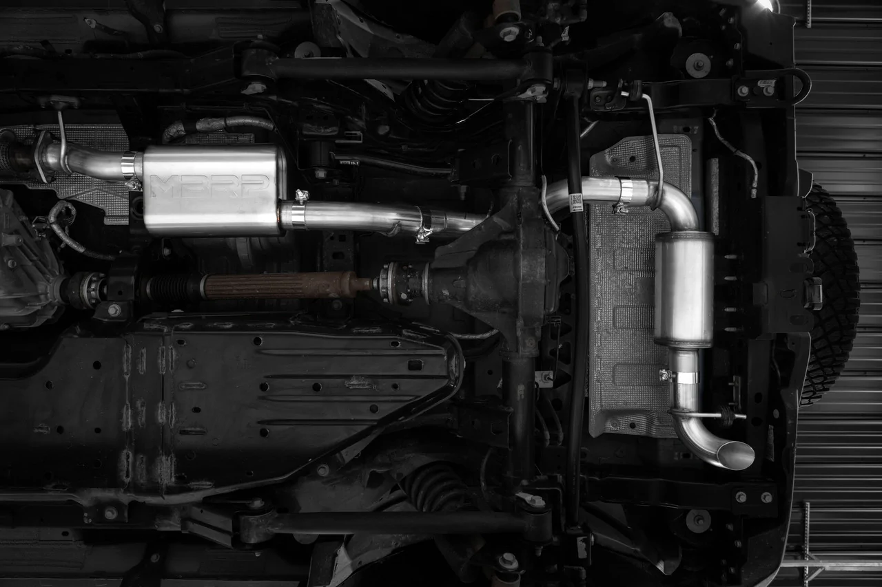

I've mentioned it before but I think an exhaust with a muffler and resonator is the best setup for the Bronco. That usually means you lose out on the dual tips if that is the look you really want. Several companies make the muffler/resonator setup which tends to be quieter than just a muffler and also gives you no drone. I have the MBRP 3" on my truck but I would think the other brands are similar.
