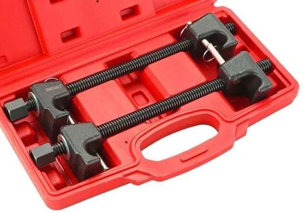

With other vehicles I've always used free loaner spring compressors from auto parts stores to remove springs/struts. Why is no one using those in this case? Is it because the compressors tools will not fit in the tight space of the Bronco? I'm talking about something like these shown in the photo below:
With the LCAs loosened (not removed)this is what I used to get the new coil overs installed. As you say, it's a pretty tight space...they just need to be positioned just right. Worked fine for me.

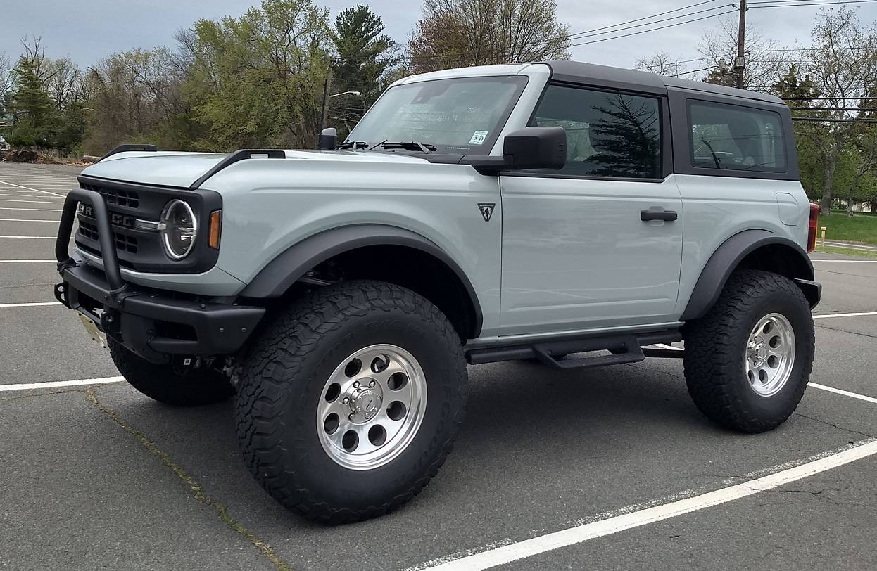

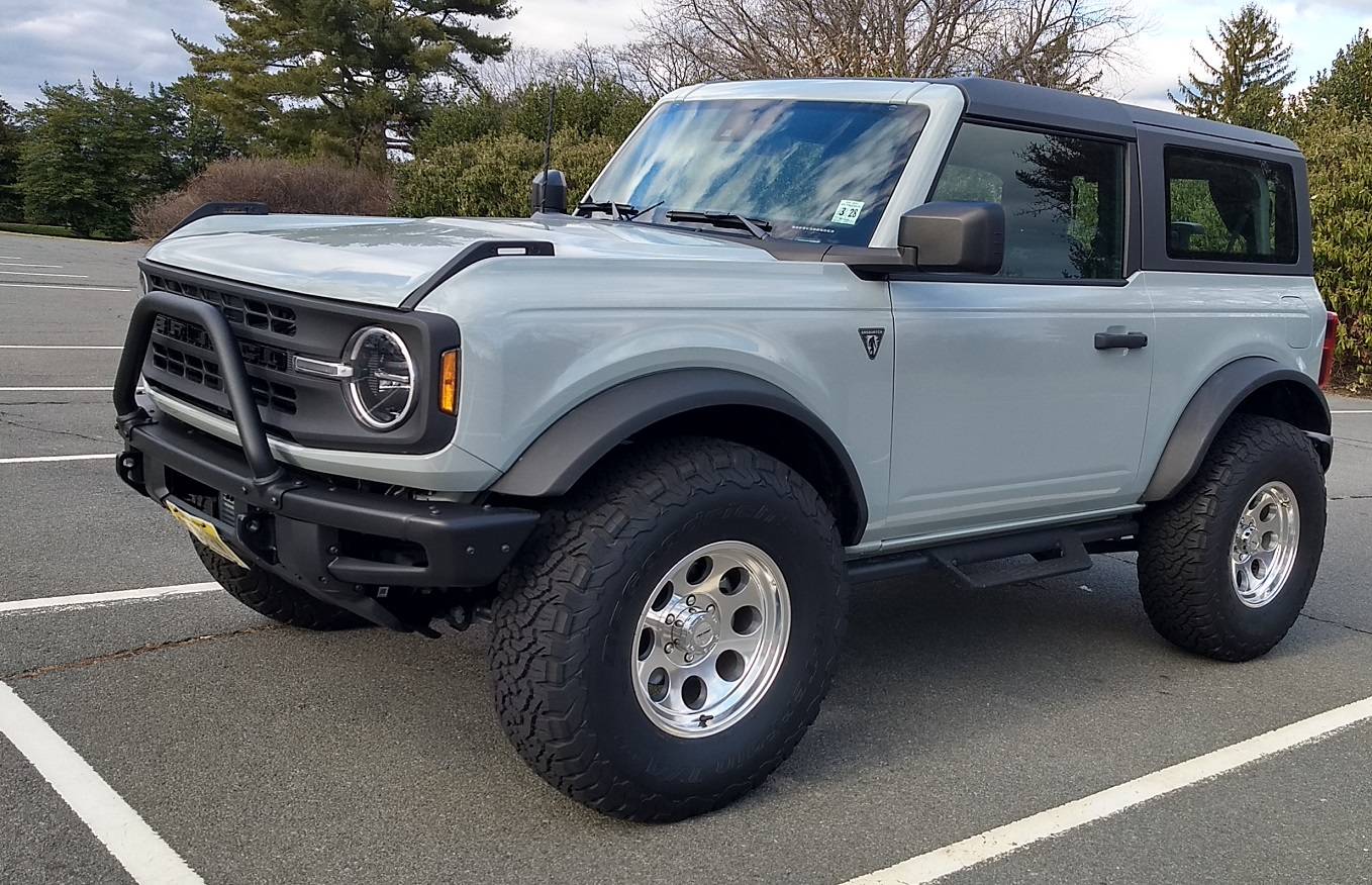

I removed the front coilovers by unbolting the lower control arms. Mark the cam positions front and rear on each side and jack the truck up, take the wheels off, drop it onto jackstands under the frame and put the jack under the control arm and remove the bolts/cams. Lower the jack slowly so you can pull the stock coilover out (make sure you leave one of the top 3 nuts on the coilover so it stays up while you get the lower studs out of the lower control arm). I did it myself (almost 59 and with a bad shoulder and I weigh a whopping 137 lbs) so most people should be able to do it. I went with the 4WP/ProComp adjustable coilovers and ended up around 2" up front and 1" in the rear and got rid of most of the rake.
The truck drives great with the ProComps and still fits in the garage! The nice thing with these coilovers is you can jack it up on the frame and adjust the coilovers with the spanner wrench in seconds vs removing the shock to change settings.
Stock suspension on 37's.
Ford Bronco Best way to remove front shocks? mybronco_37stock5
4WP/ProComp coilovers on 37's.
These things give me the heebie jeebies. 😬

They can be scary if the are holding an uncontained spring but with something like a strut which is contained they are not as scary if you keep you you fingers and other parts of your body away from the spring.
I don't mind these because the pins positively lock in the top and bottom coil. Although they are very snug on the Bronco coils. But also I only use them outside of the vehicle so I can control how straight everything is.
