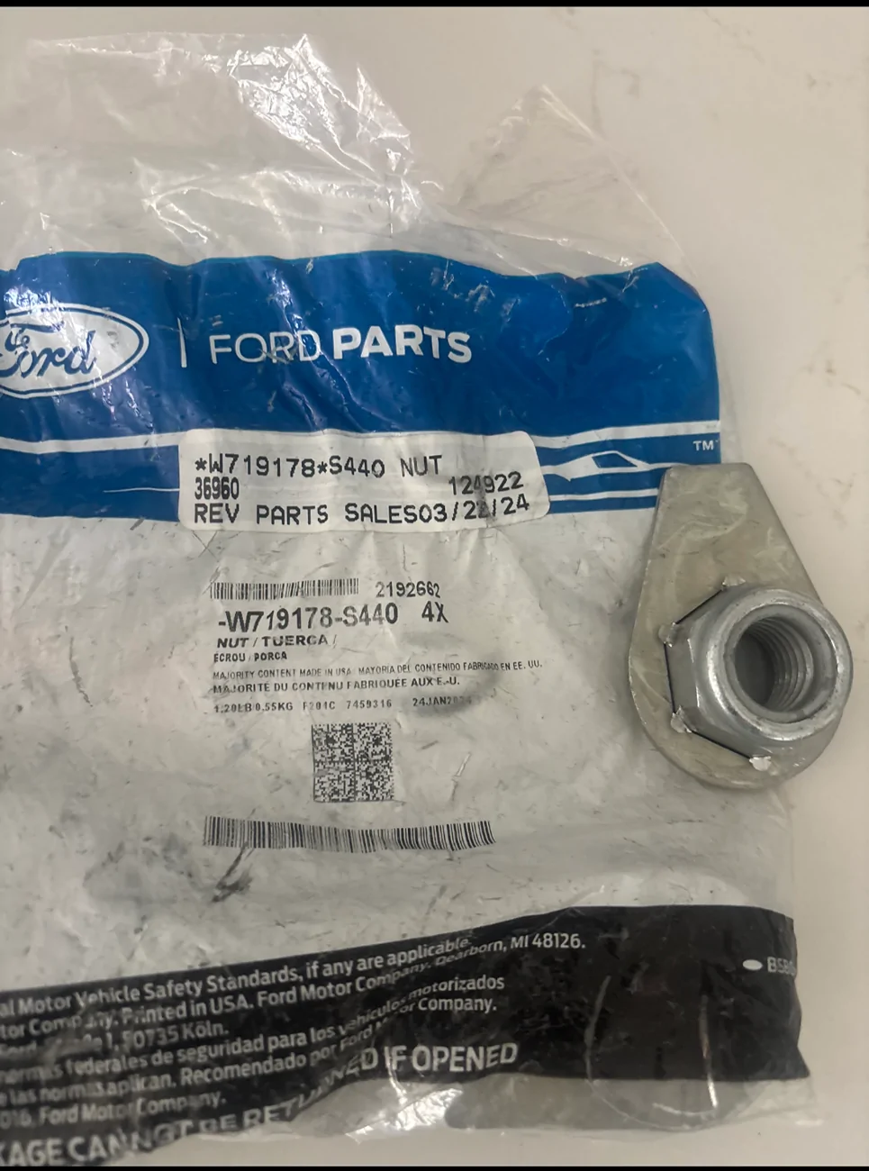

Another note on the rear, I had a 30mm socket so I didn't have to order one, or so I thought. Turns out it was too shallow. I didn't have a 30mm wrench or deep socket but my industrial strength adjustable wrench did the job of holding the nut side of the lower rear bolt.

I know this isn't going to help you now but I'll post this to help others in the future. I believe some of the early Bronco had a no-spin nut for the lower shock bolt and then sometime in the future they switched to a standard nut. When I originally put on my shock skids, it was a major pain in the ass to keep that nut from spinning while trying to torque it to 350ft/lbs. A friend of mine did a little investigating and came up with a part number for the no-spin nuts which made the job a whole lot easier when I replaced the rear shocks. Here is the package for those tabbed nuts.
