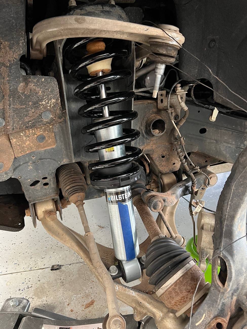

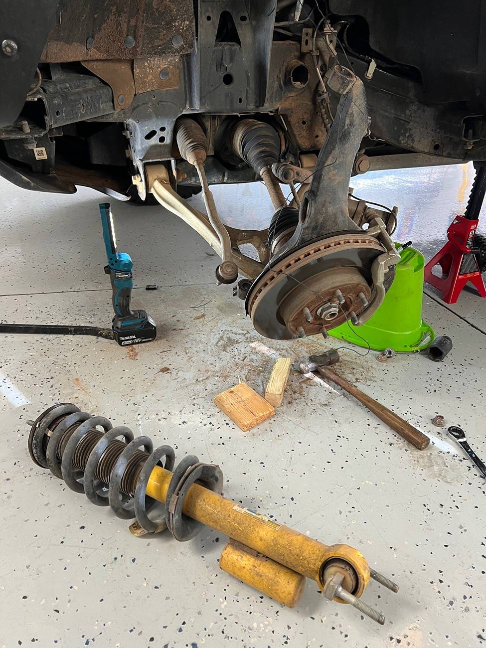

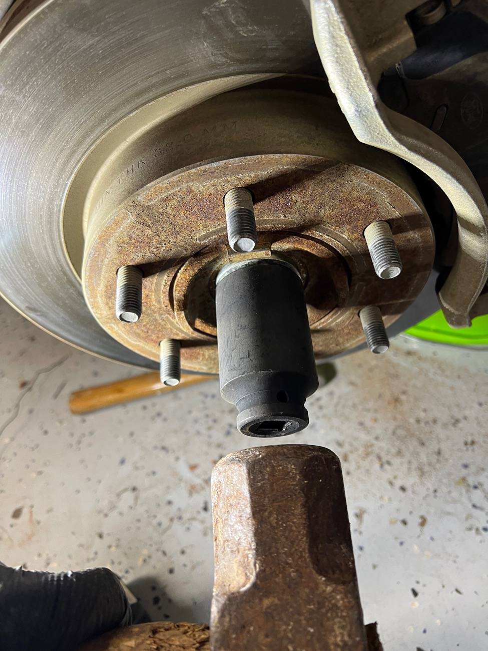

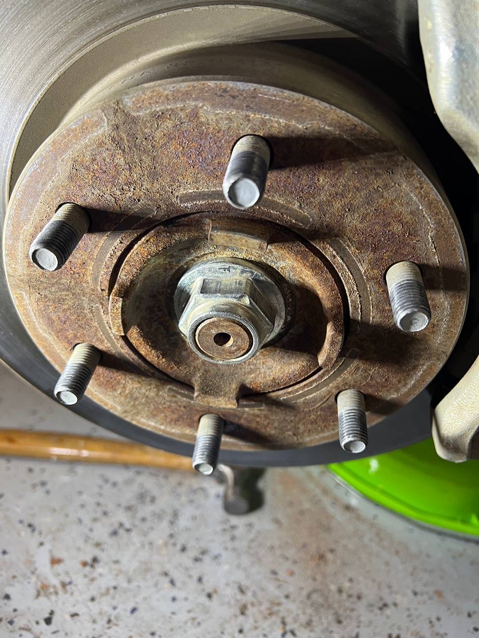

I guess I’m in the minority. I separate upper ball joint, tie rod end, sway bar link, pull speed sensor and brake caliper, loosen axle nut and pop it loose in knuckle. Coilover is out in forty minutes. If you aren’t going to reuse the original shock, cutting the studs off does make it easier. I’m just a shade tree mechanic, so the first one was a bitch, then much easier. I put the joince bumper on upside down on one and had to remove and fix. While in the process of installing Bilstein 6112’s, I discovered a pinhole in the outer driver’s side cv boot, so I installed a new half shaft also.
Edit - the 35mm axle nut is nothing to be afraid of. New ones are $10 a pair on-line. I just ran it out w/ my Makita impact gun. I did buy a 250 ft-lb torque wrench and ball joint separator tool on Amazon.
