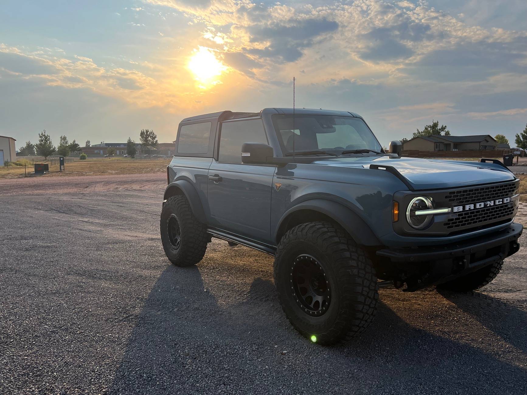

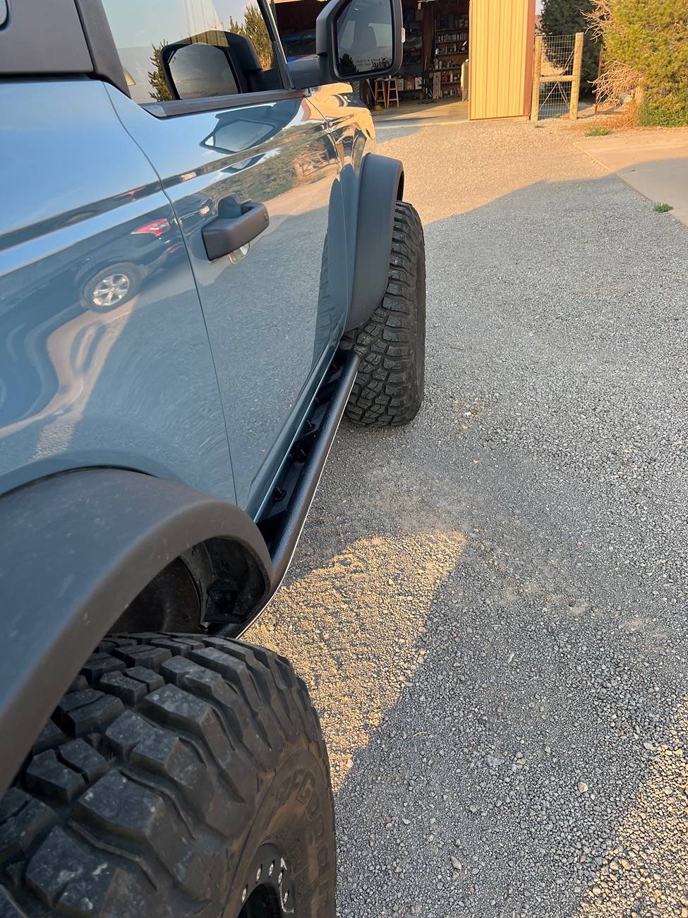

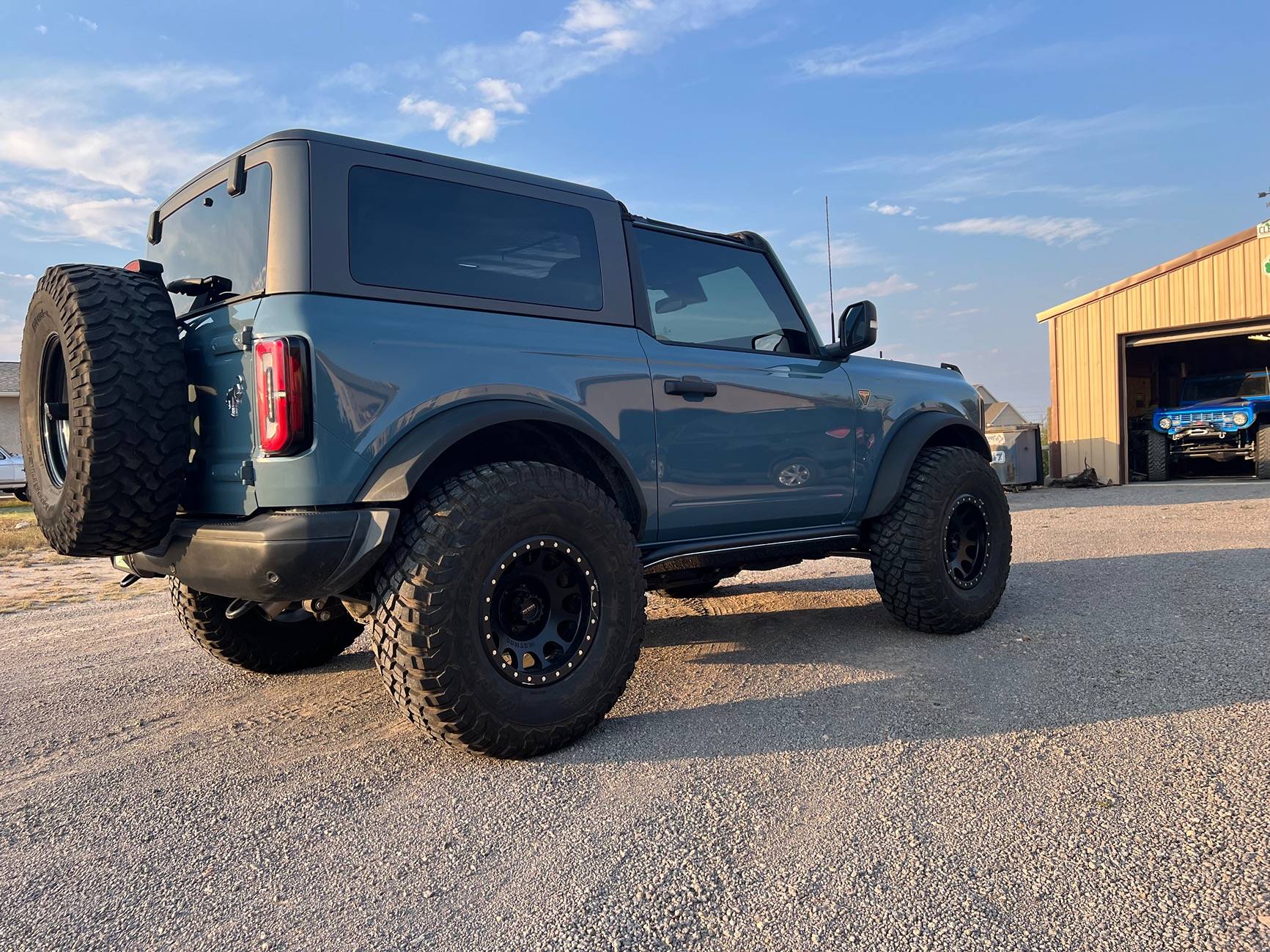

-38 method 105s with Sasquatch flares. This was with 37 km3s and no lift. I eventually changed to method 706 bead grips because I went to a long arm front suspension and needed the positive offset wheel. Bead grips are also a much lighter more street friendly wheel.

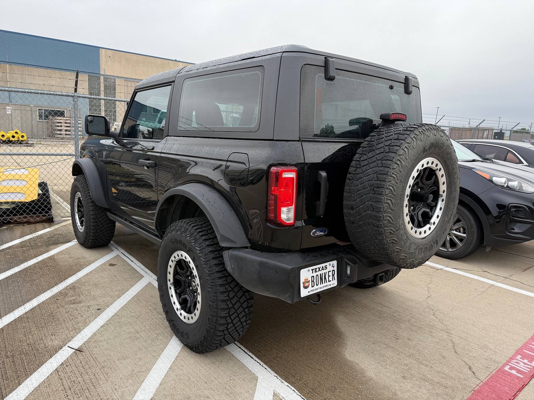

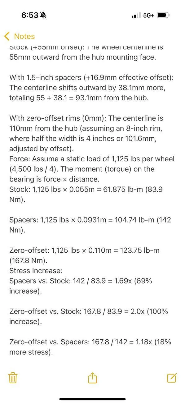

Man…. -38 adds like a 200%+ increase in force over stock offset on the hubs and bjs and don’t get me started on the steering. But I’ve been dailying the ford beadlocks no issues for a couple months. They add 1/2” of width by themselves. Lots of people driving around on raptor functional beadlocks since the first gen raptor came out and I’ve never seen or heard of anyone having issues, just wives tales of having to periodically torque them

Are you running the Ford beadlocks in the bead lock sense? Not just a look?
I think probably yes, but this is a good time to point out not everyone does. To do so, you have to monitor and keep it all torqued correctly. Some state's don't consider it a permanent on road rim, either.
But I've heard a lot of good things about the Ford rings, just use anti-seize and a real torque wrench to set up if you're going to run them full-time. So yes, you should encourage people to pay attention.
That looks good. Any rub with the 37's?
Mdsuits
Mar 16, 2021
434
947
05 f350, 68 bronco 89 samurai
With no lift, yes….it would rub the flares pretty easy wheeling. I had to remove the ends of the modular bumper…and the big giant plastic pieces in the back of the wheel wells up front….it was definitely useable for crawling but I wouldn’t recommend jumping it or anything crazy…..if you wanna run a tire that big you are definitely better off adding a lil lift of some kind.

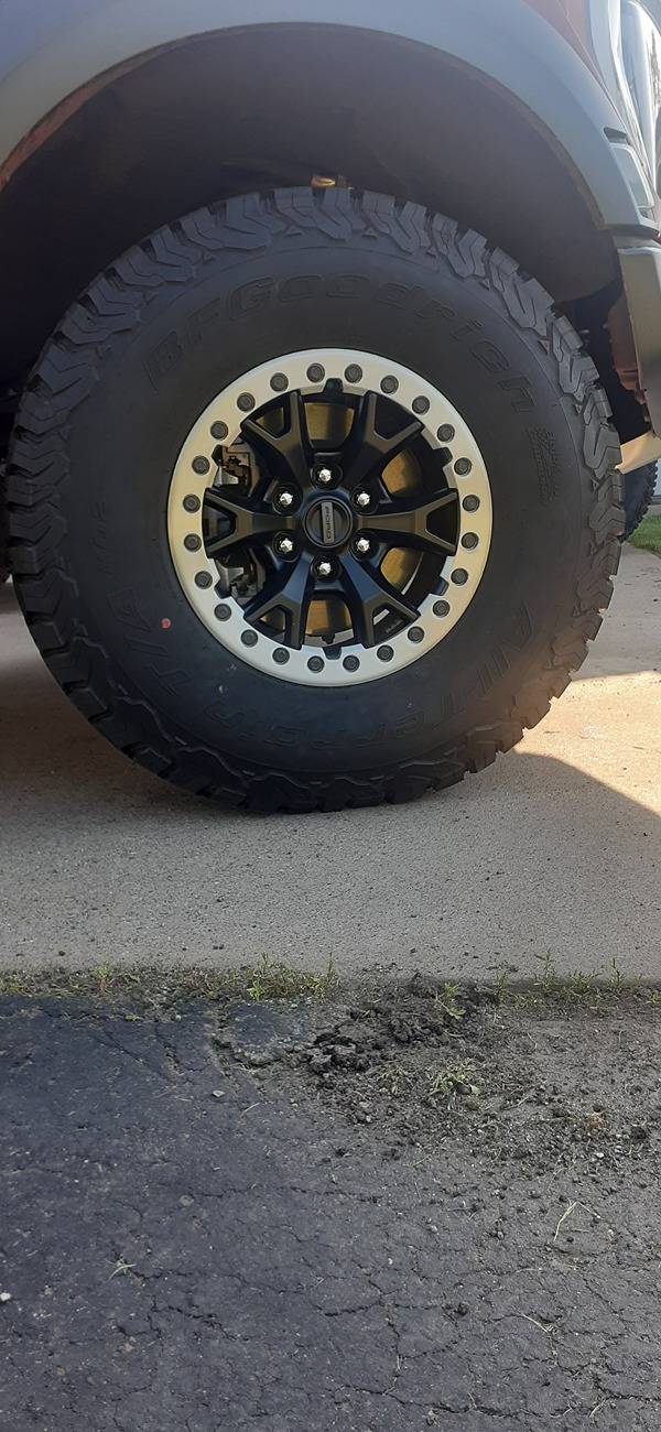

I run the factory beadlocks on my raptor and haven't had any issues. They are a pretty good setup that allows you to torque the bolts to 48 lbs/ft. Been happy with them so far. Been thinking about doing the same on the bronco.

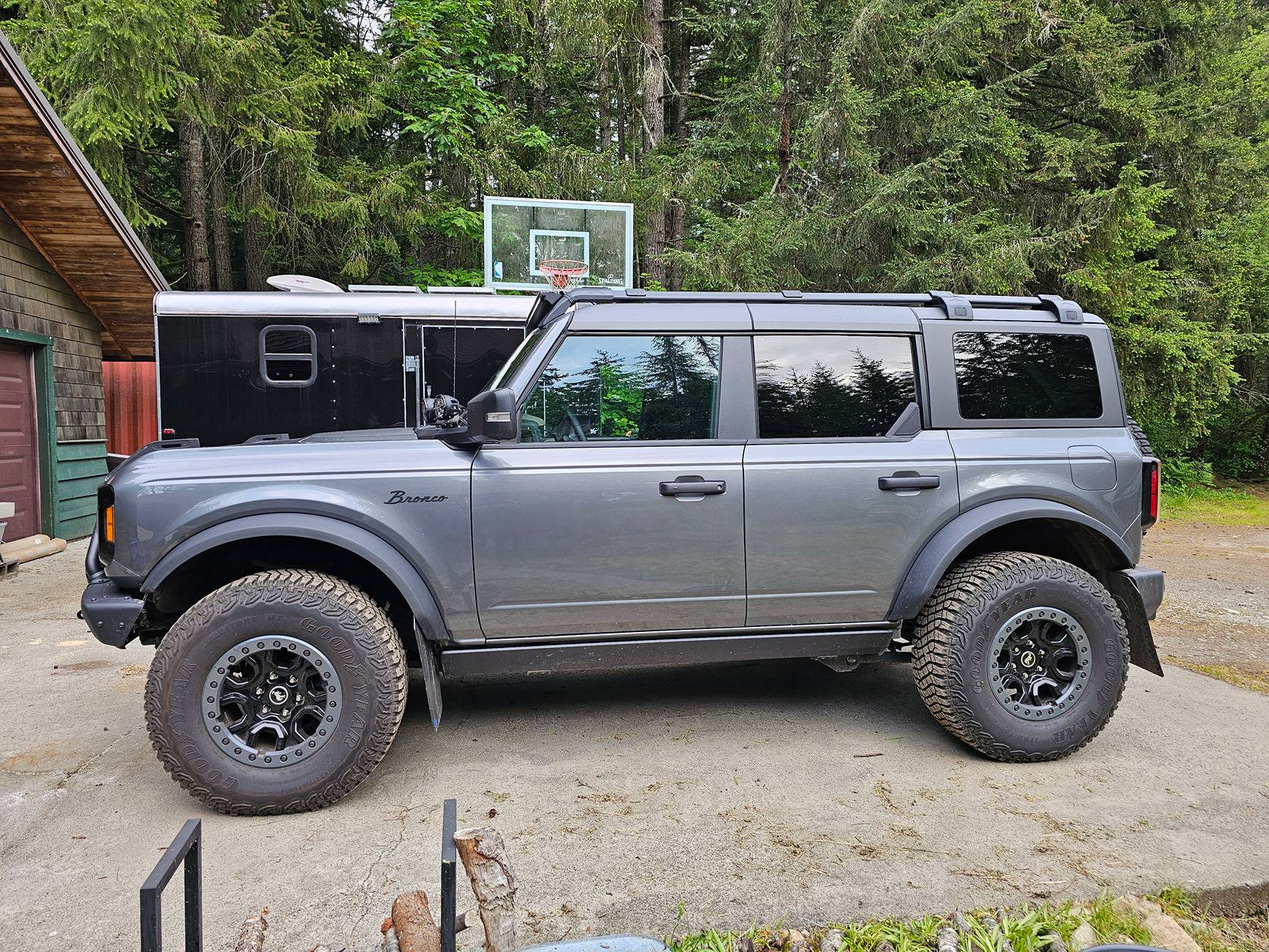

I daily drive my Ford functional beadlocks with no problems. Make sure you use tire soap when you mount them, and follow the Ford torquing procedure. I checked torque at 500 miles with no movement and again at 2,000 just to convince myself everything was OK, again no movement.
Ford Bronco Beadlocks on a Daily? 1000008806
I had them powder coated to match the Bronco.
