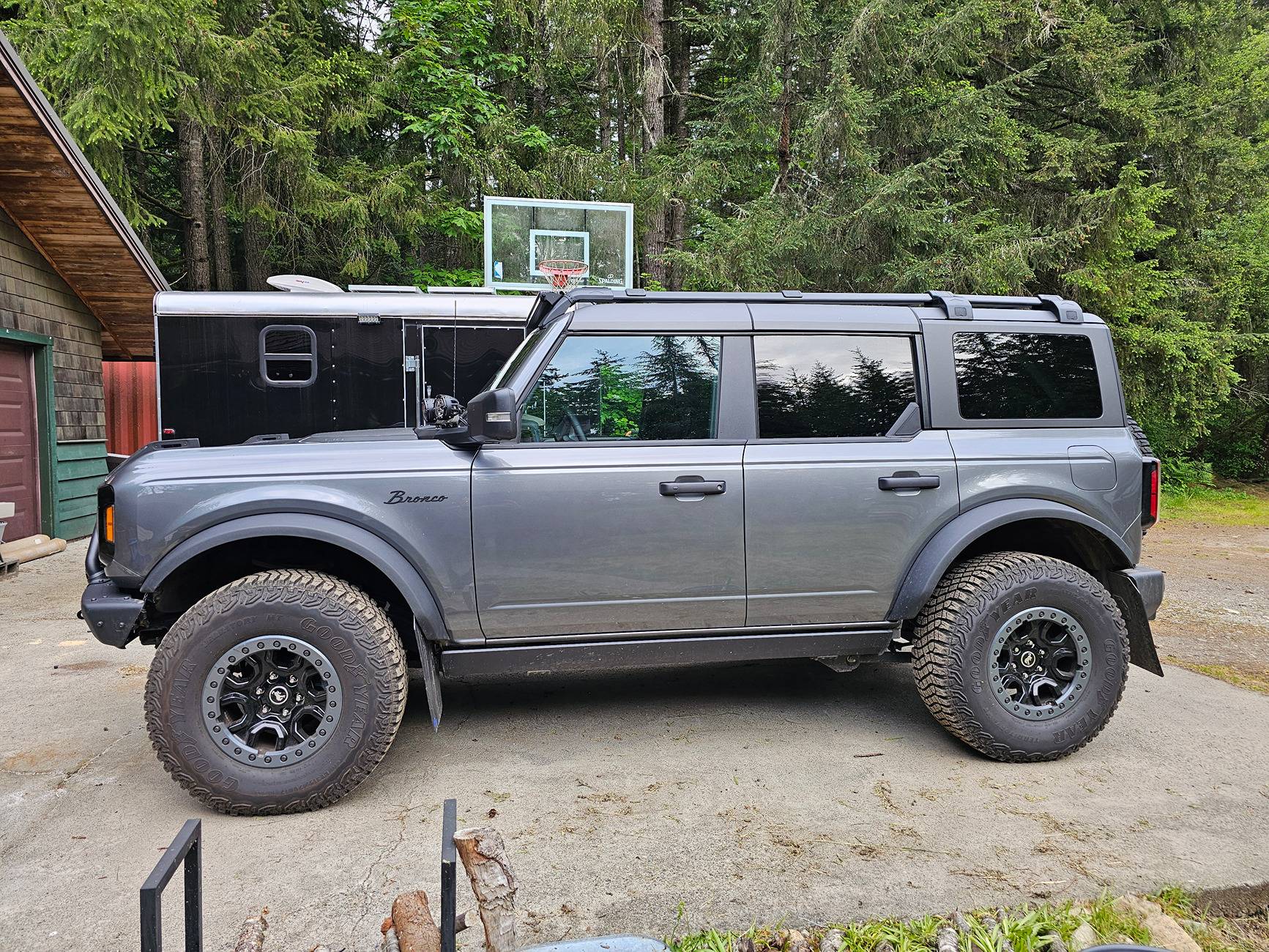

2024 Bronco 4 Door Wildtrak Sasquatch, 2017 F450 King Ranch Long Bed Dually
I'm still running the original 35" MTs on my Wildtrack Sas with the Ford performance bead lock rings. After over 5,000 miles, absolutely no problems, on or off road. I re-torqued to 48 ft-lbs at 500, 1000 and now every 2k miles with no movement on bolts after the initial re-torque at 500 miles. Longest period of time between airing down and back up again has been about 6 weeks, and the pressure in all four tires has been rock solid during that time.
