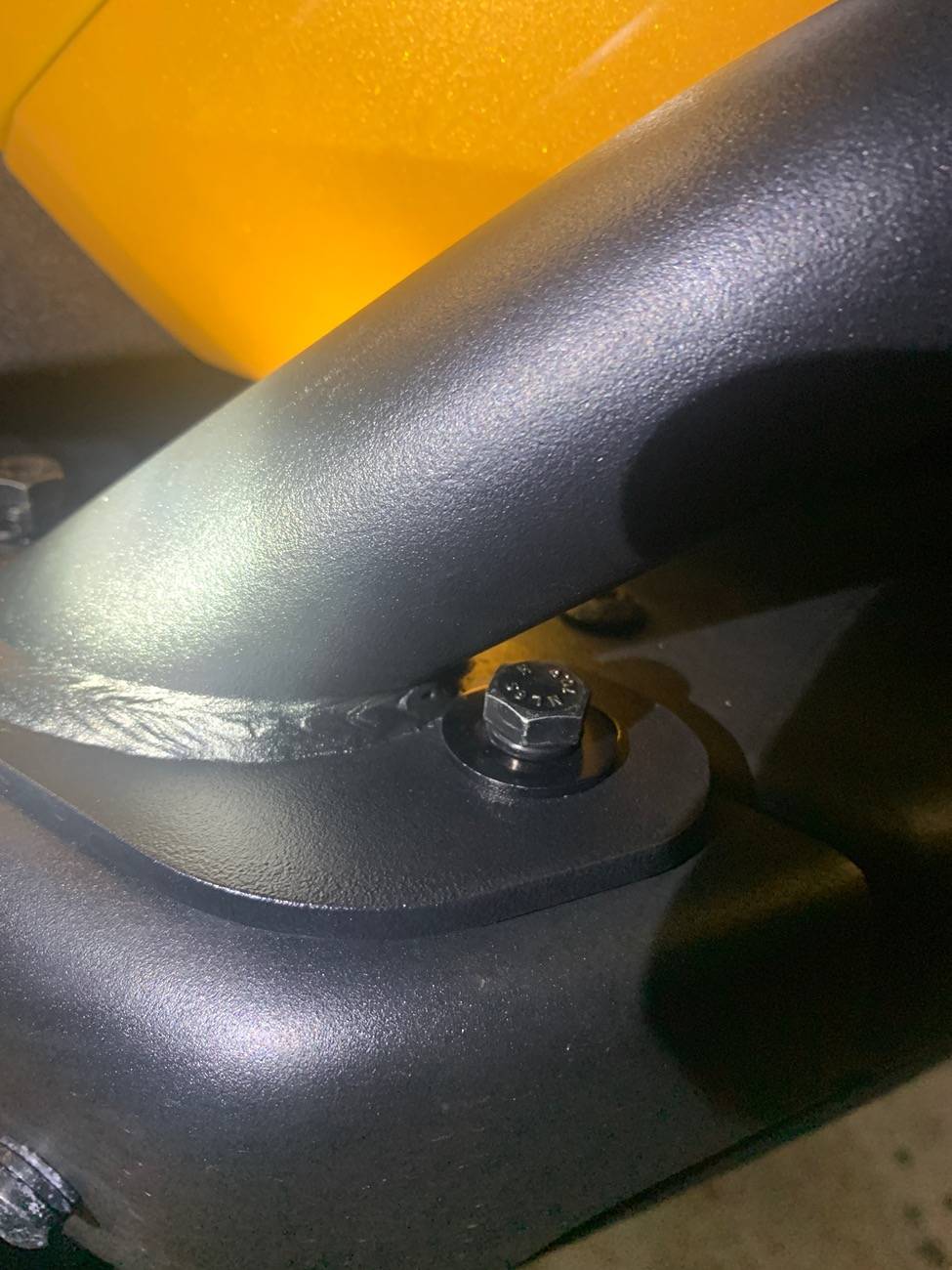

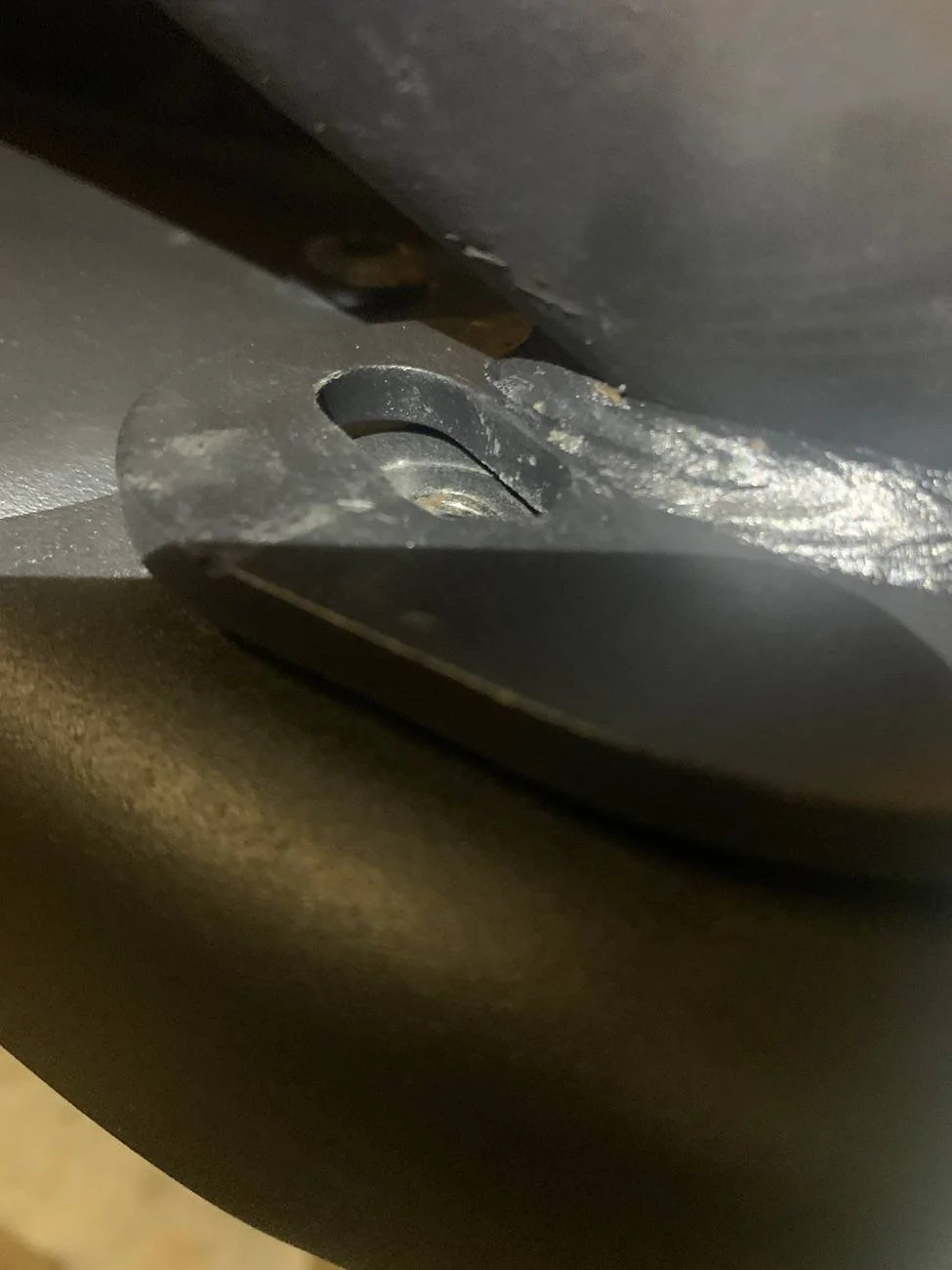

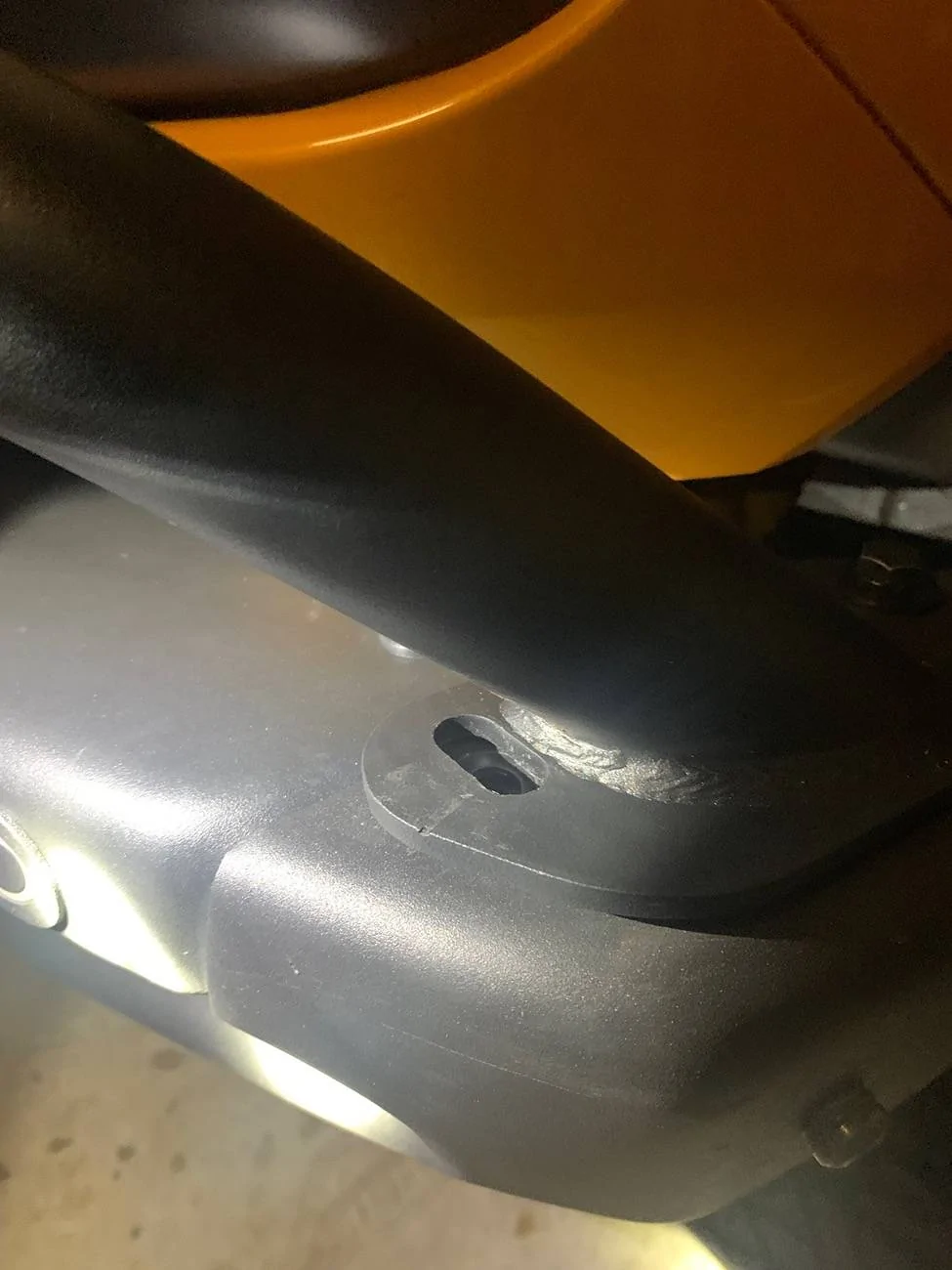

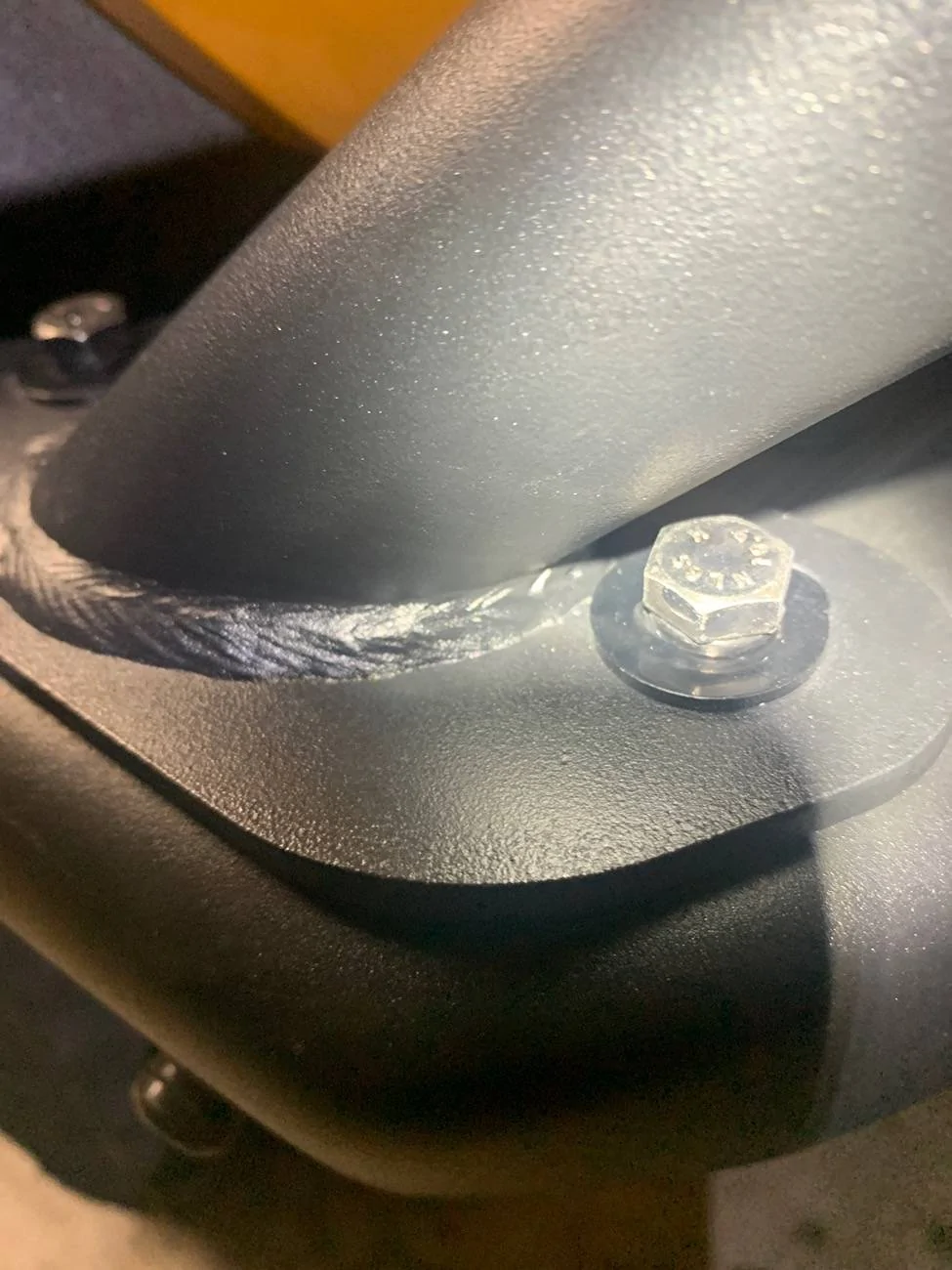

Well you were right. On the “problem side” the weld is directly up on the side of the hole for the bolt. On the other side where the bolt was able to fit there is more space between the bolt head and the weld. (That space is occupied by the washer, but is there.) so the defect is not the angle of the weld, but the location of the hole which is the issue? Either way I’m still not able to fit their supplied bolt. I’m not using the bronco button head Torx plus 40 bolts either. As you see I used the supplied bolts successfully on the passenger side. But the front driver side bolt won’t go in.
See pics below:

The plate with the bolt holes can't be misaligned - it will only line up on the bumper one way. And all the photos show that bull bar having a really low clearance/aggressive angle like that. So if the holes line up - it's not a manufacturing defect.
And plenty of other people have this same bull bar. I do not, so I can't comment personally, but I don't think you got serial number 001. Hopefully someone with this same item can chime in and say what they did. Almost looks like you should be able to get the bolt wiggled in that hole with it off the bumper, then keeping the head flush on the bar mount bracket get it to thread into the bolt/bracket on the bumper. But I don't have one so I can't say for sure.
That said - I do agree, TOR should be able to help you out here. A shame they didn't, or at least haven't yet. I'm assuming there's nothing in the installation manual/video that addresses this? And there isn't a special bolt or other hardware for that one clearance point?
What I’ve found out on here is the problem hole is welded a little bit closer to the hole than other side where it worked. It’s just enough to prevent the bolt from going it. And it’s close enough to drive me crazy.

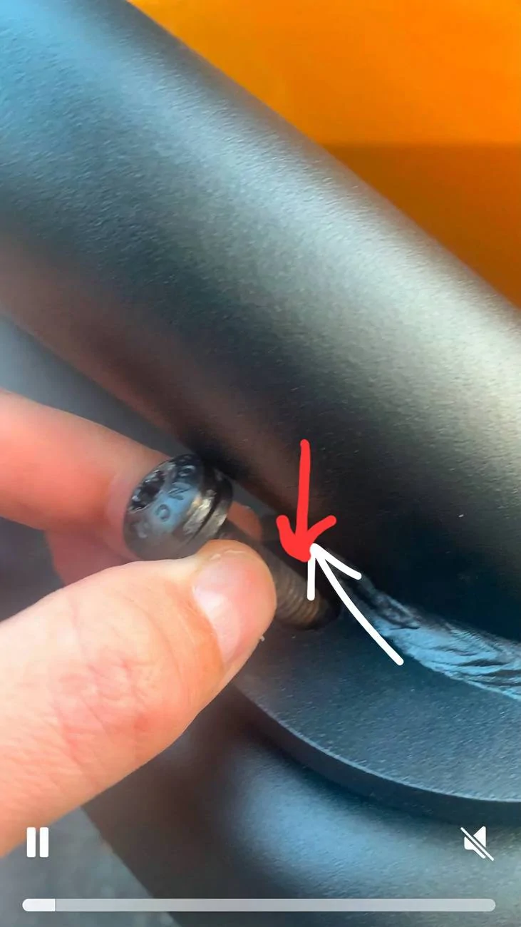

It looks like you need to unbolt everything, lay that short bolt on its side along the overlong measurement of the opening, and let it drop in from the inside (between bar uprights), and then line up the holes with the mod bumper at the same time.

White arrow, then red arrow:
It’s been tried. I even paid a shop $$$ and drove hours in traffic. No video coming soon sadly. I’m too busy working
