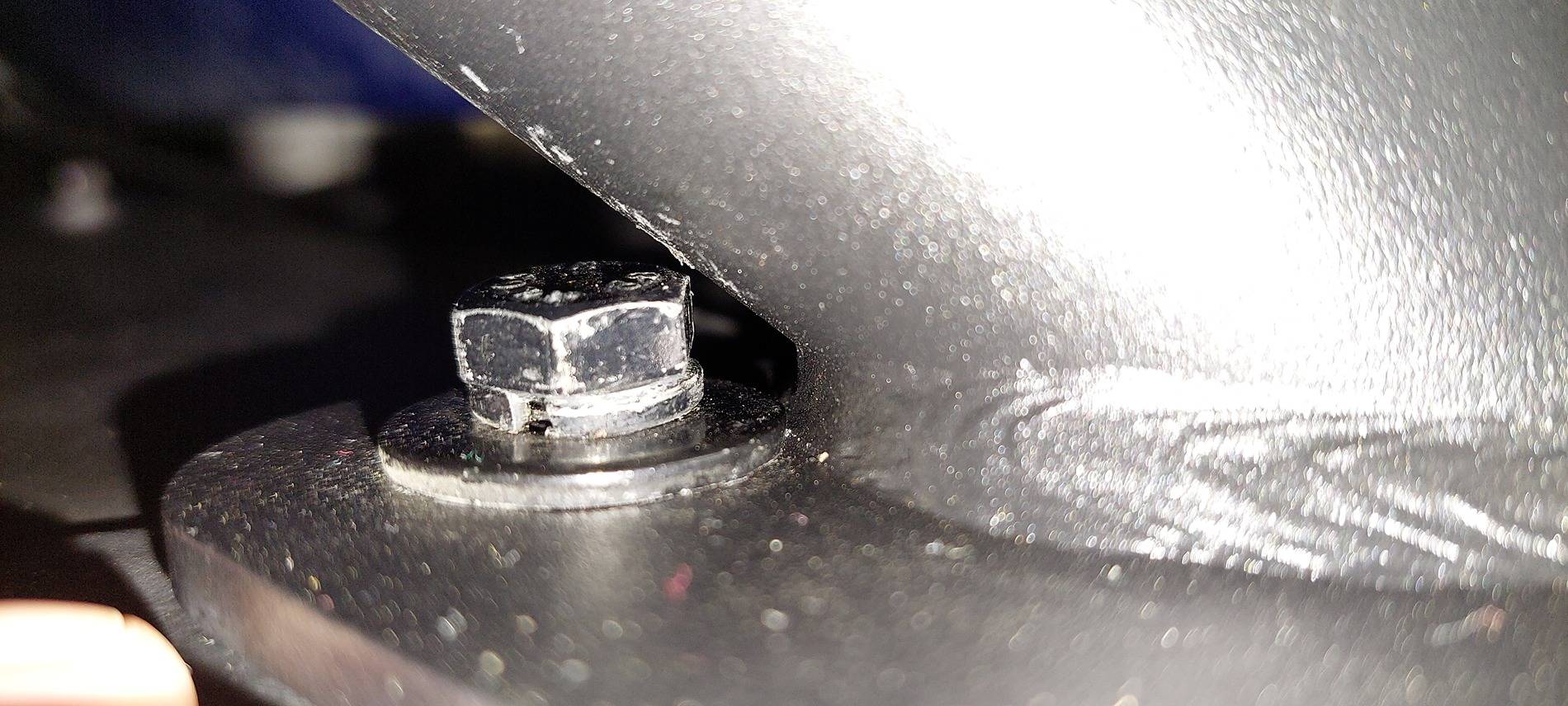

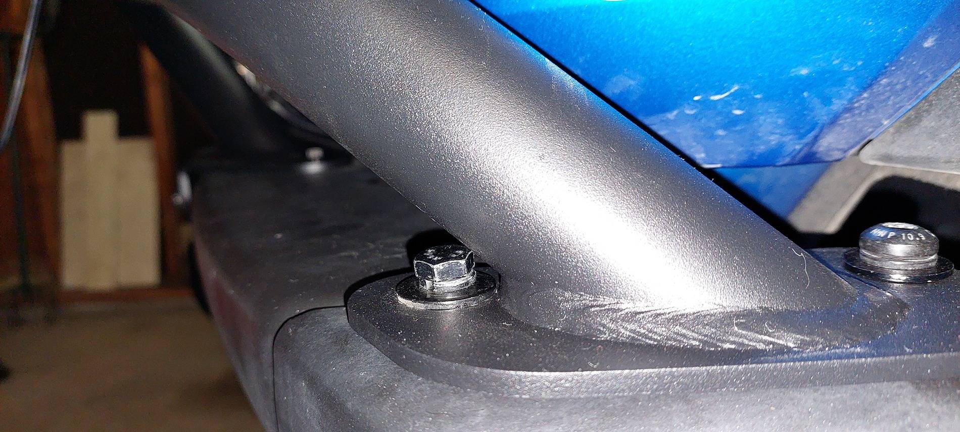

Took some pics of the bolts
Driver side
Ford Bronco BAJA bull guard - one difficult bolt 20241231_082331
Ford Bronco BAJA bull guard - one difficult bolt 20241231_082322
You can see that the only way that bolt has clearance to turn is to be fully inserted before you can turn it.

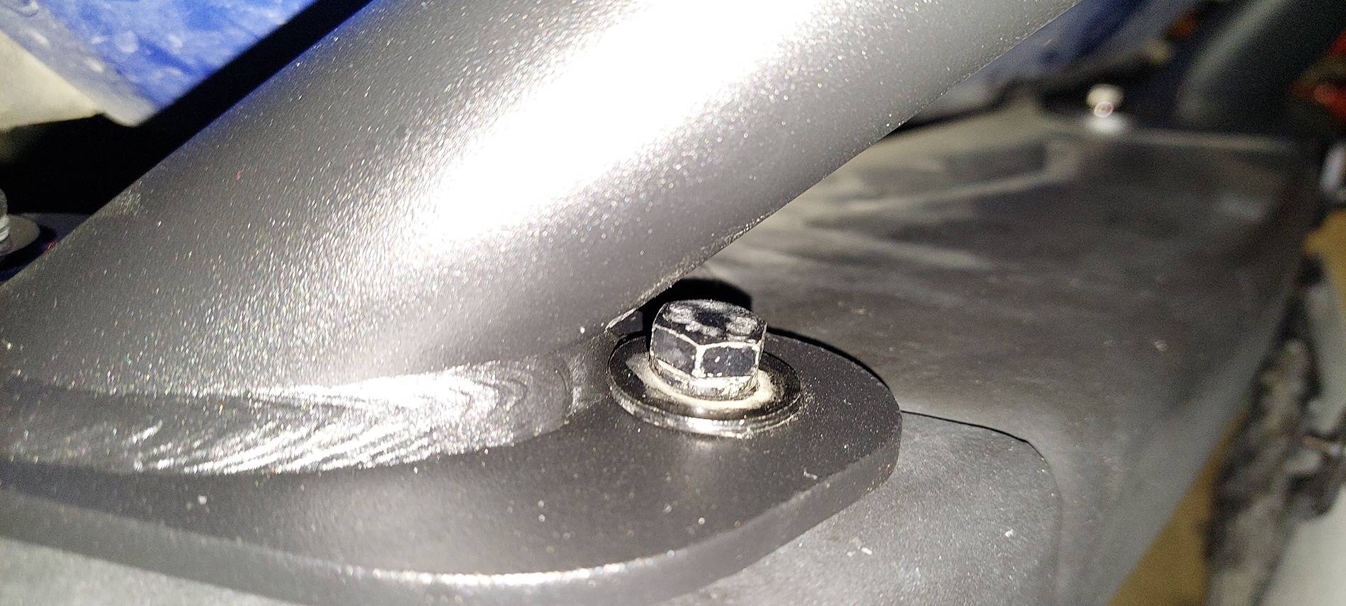

Passenger side, you can see washer is up un weld.
Ford Bronco BAJA bull guard - one difficult bolt 20241231_082427
Like others are saying, id try it again, first inserting bolt from the side, then in.
Besides, to put another bar on you are going to have to remove that one. So just do try it before they need to ship another bar
