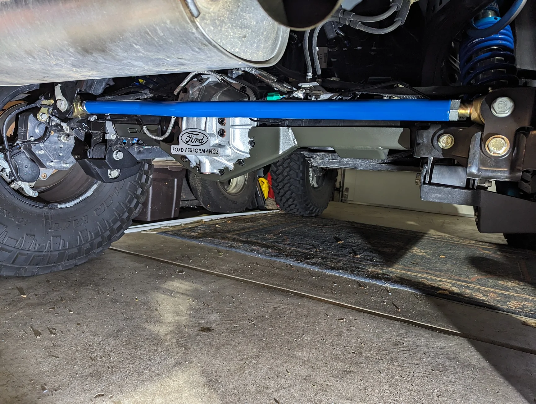

The bracket is very helpful... If you need an adjustable track bar itself as well then know the only "real" difference between track bars is the end links. The stock track bar comes with polymer bushings. They are relatively quiet and long lasting. There are a number of manufacturers that claim how their "polymer" is better than others... Okay fine, maybe something to that but the differences are not huge. Then there are johnny joints, one end or both ends. Johnny joints allow more freedom of movement but also require lubrication often... I probably over do it but I lube mine about every 1000 miles. Other than that you have pretty pretty milled aluminum or steel vs basic steel pipe. I went the basic steel pipe route and painted it a pretty blue to match my rig. Simple, strong, a little less resistance to articulation and a lot more maintenance.... but I like mine. I went with Core 4x4 out of Utah. Small family company. Seem like really good people. Quality product at a good price.... Your best ride is when that track bar (the fifth link) is horizontal at rest...
Is that bar on vehicle adjustable or do you have to remove one end?
