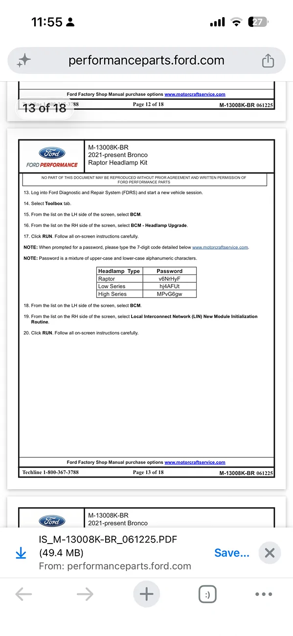

Either this ballast/adapter piece sets it apart from the bricking issues ppl have on a straight raptor swap. Or this…likely this. I question if maybe this coding fixes issues on a straight raptor swap too. But also worried that even with these if you have a software update your headlights are totally bricked until you get back to the dealer to re run this coding with a forscan
Ford Bronco Anyone try the Ford Performance Raptor Upgrade Headlights? IMG_6371
For context I have a damaged OEM headlight so considering getting this on sale for 1,200ish for the set. Not too far off from what my body shop has quoted for one OEM non-Raptor headlight.

Those modules come on all signature headlights. They’re simply not attached to the headlights in the picture.

I’m seeing that now. Just pulled up a stock one. I guess it’s really the forescan code that’s needed. Probably a hack too for guys looking for used OEM Raptor lights in ebay
