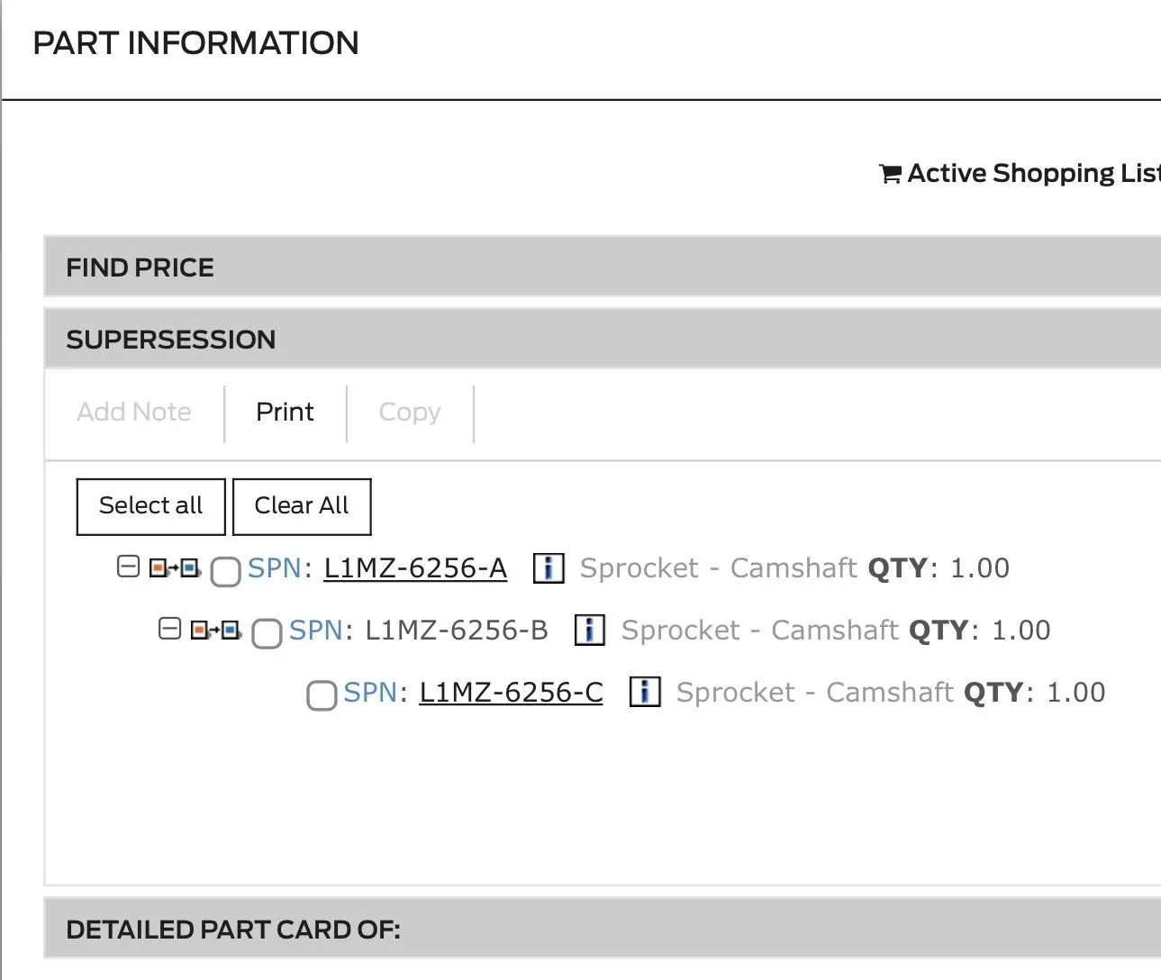

This is using my 22 Wildtrak VIN:
Exhaust phaser has been superseded once already.

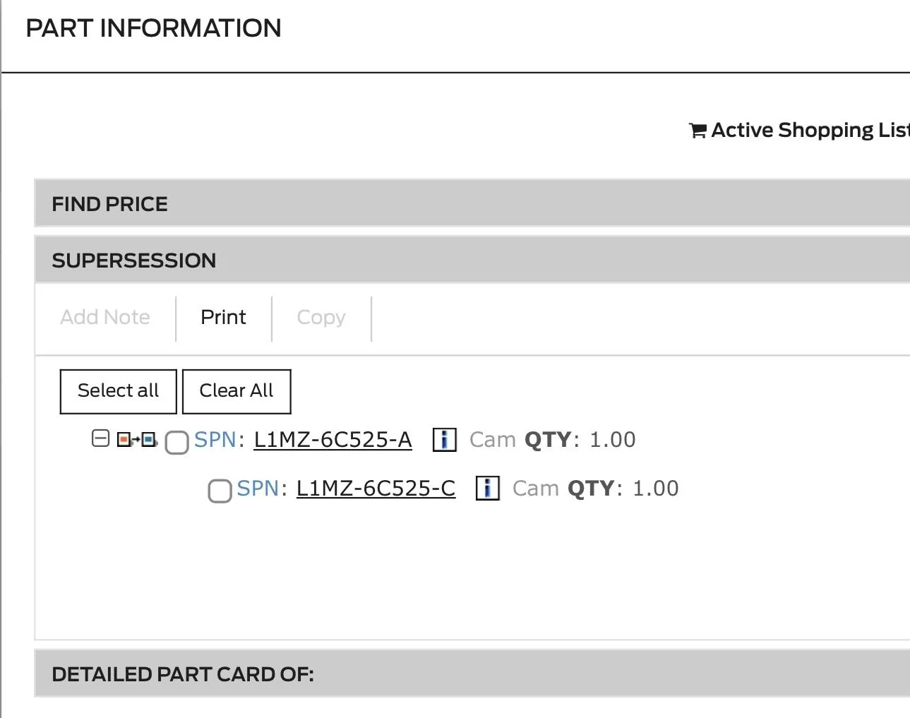

And the intake phaser has now been superseded twice.

It could be the same part from a different vendor. Usually an A/B/C variant isn't a major difference in the part in my experience, its just a change in vendor. Oddly enough this is the only place on the internet that seems to have phaser issues so often on the 2.7.
While it is a possibility, it’s unlikely. Most supersessions are due to a design change to repair an issue with the part, not because of a simple vendor change.
Is there a separate code listed for a vendor? Then, like the USG NSN/PN, a part number could have multiple source of suppliers.
