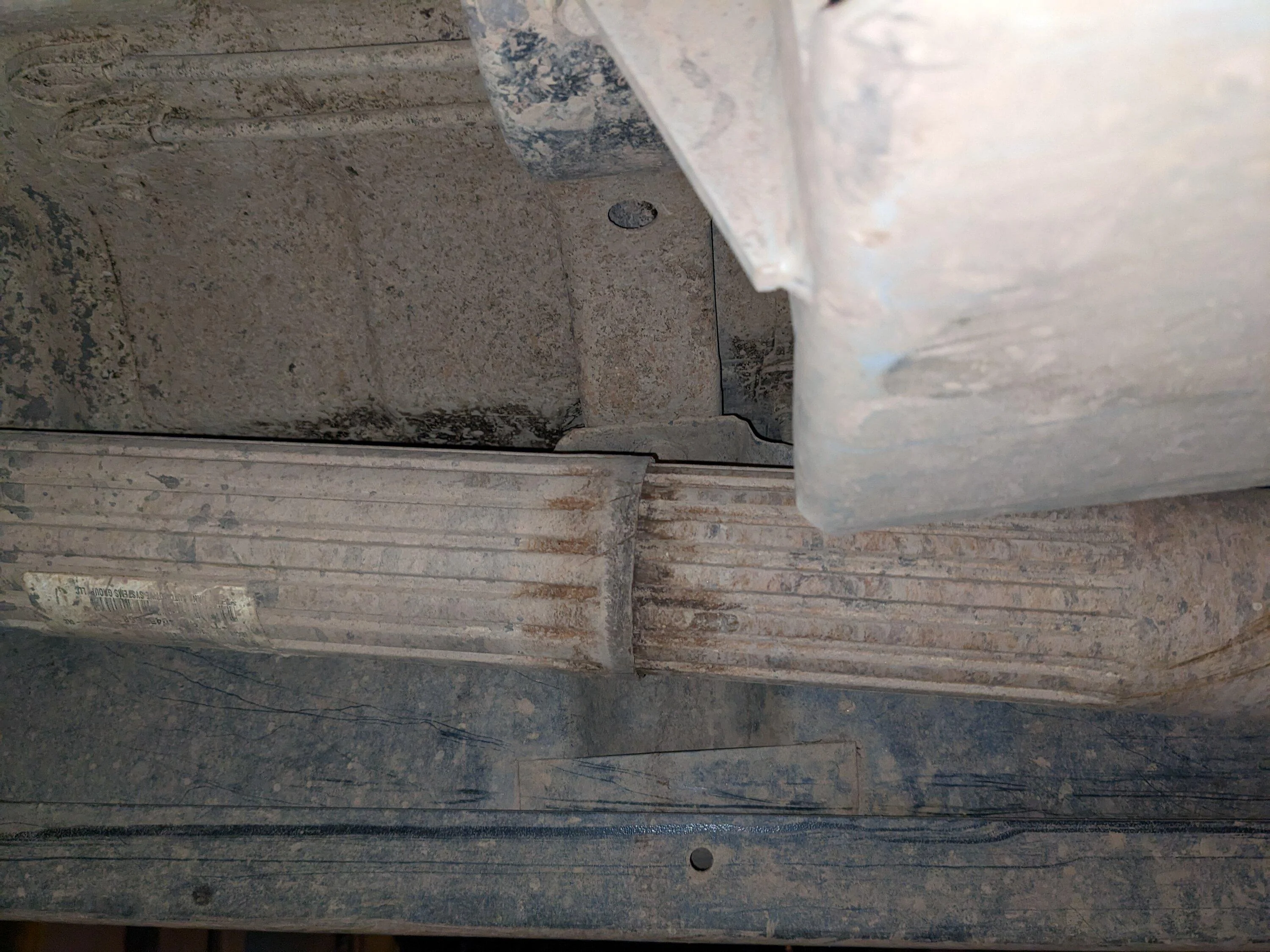

Just did a drain and fill on it not long ago, and everything was good, checked the gear oil early on too, it's looking clear where I can reach from the fill plug, not even the normal silver in the oil yet... I'm kinda back to the driveshaft, and just no visual evidence and not loose.. the stock driveshafts on these things are crap, Literally made of thin sheetmetal...
Ford Bronco Alternator Upgrade PXL_20221218_232543568[1]
I really need that second set of ears or to hang a phone under it while I go for a drive, but it'll wait until later in the week.
