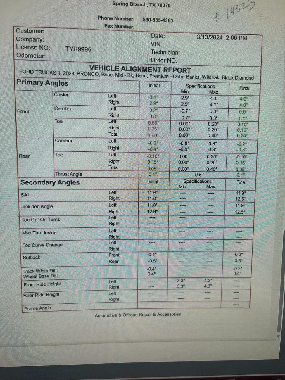

Ford Bronco Alignment specs for BD with SAS coil overs? 74483512752__BCC38C26-D067-49AD-AF73-6285ADBF50CD

If in doubt use the BD SAS specifications. But I believe they are the same for all Broncos SAS or not.
The above post with pic is from my alignment on a non SAS BD with Eibach pro truck coilovers. Aligned is aligned across the board I believe.
