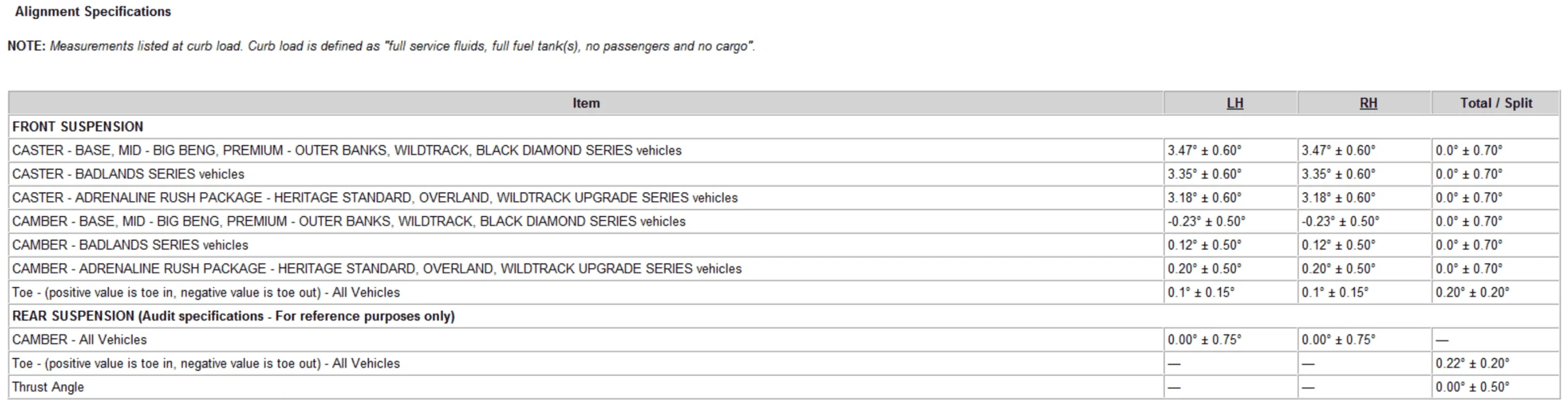

2021 Ford Bronco Factory Service Manual...
Wonder if Adrenaline Rush is the new H.O.S.S. 3.0 package, and if so does this say it will be on Heritage and what is Overland (Everglades)?
No, Adrenaline Rush is the original name for Sasquatch. The others were probably cancelled for 2021. Although the service manual was released in Dec 31 2021, it has some old names/info. The manual also shows optional ride height sensors on the UCA for an active suspension that apparently wasn't released either (Wildtrak was probably supposed to get it).
