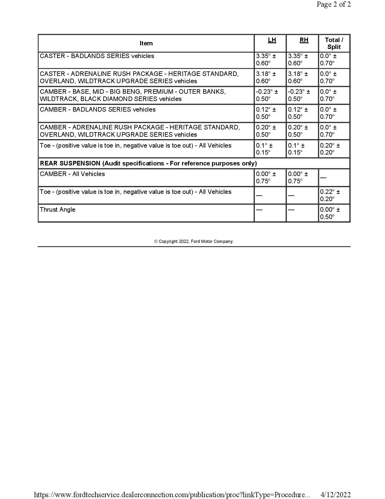

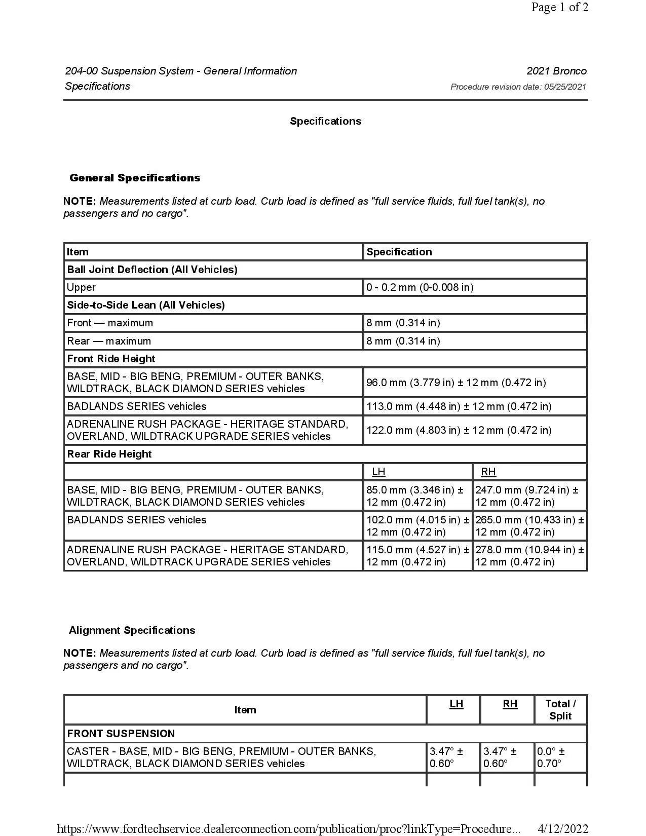

Just In case anyone else needs the Alignment specs. These are from Identifix
So, for anyone that’s adding Sasquatch takeoffs - they want to follow the Adrenaline Rush specs?
