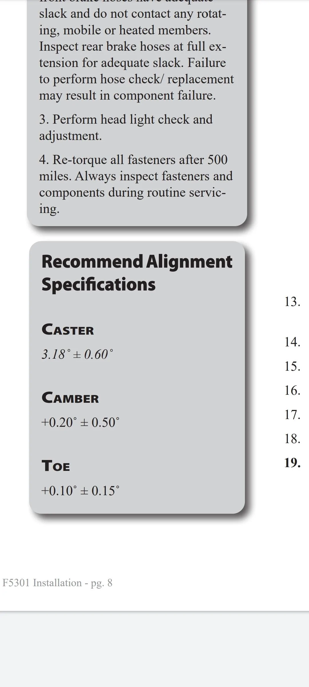

So just to clarify, the Adrenaline Rush Pkg specs are what we want to have for Sasquatch Pkg vehicles regardless of model?

So, for anyone that’s adding Sasquatch takeoffs - they want to follow the Adrenaline Rush specs?
Wondering if you ever found this answer?
I just put on sas takeoffs and my dealer couldn’t do the alignment….

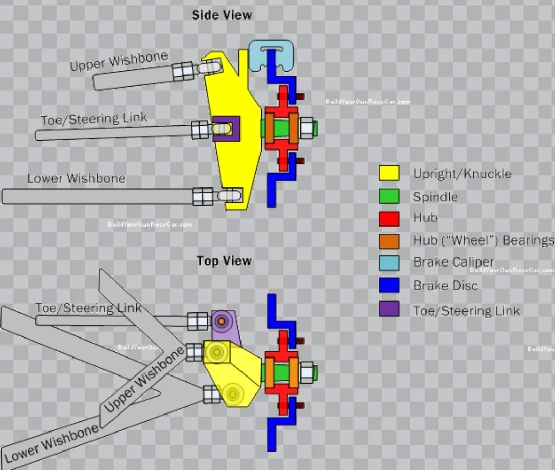

So, to follow up on this line of thought: For a mild lift anyway, Since the double arm IFS is essentially a parallelogram, with the upper, lower, axle shaft and tierod all the same length to their respective pivot points, why should an alignment be needed at all? Camber and toe should be unchanged, caster would differ, but not if lifted the same front and rear. Just thinkin' out loud, and you, Big Meats are uniquely qualified to know.
A little late on this one, but on most IFS vehicles the arms aren't parallel, they also aren't equal length with each other or the tierod, thus as they move through their range of motion, all of the specs change. Hopefully the attached pic will help, it is a bit generic, but it gets the point across as far as design characteristics.

Hey, thanks, my mind wanders sometimes and needs help with the obvious. My assumption was that they were equal length and parallel. Not to leave well enough alone...why not?

There are a lot of things that play into suspension design, some of them are far beyond a simple reply, if it does, I don't mean to sound condescending, I spent a week studying this stuff years ago, just because I wanted to know "why" myself and still don't fully understand all of it. A couple quick explanations are: with equal length arms, the camber would stay the same, but your track width would change as your suspension cycled, thus scraping the tires side ways as the suspension cycled. Another is that if the camber remained at 0°, then when your vehicle made a turn and leaned, your tire would lean with the vehicle and you would actually lose percentage of tire making contact with the ground, causing a loss of traction, when you need it most.

Thank You. I watch that video of the guy building a differential out of tinker toys and understand it perfectly...for about 30 seconds, again thanks

Just wondering if there are updated specs or if anyone knows which specs would be for sasquatch. The reason I ask is because there are 2 different specs for Wildtrak, one is regular, and the other is under the adrenaline rush. My camber has always looked excessively positive and my crude measuring suggests it is about 1.5 degrees and I need to get that addressed.
