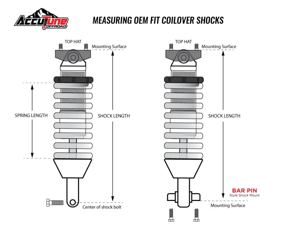

AccuTune Offroad
Base Sponsor (Level 1)
Feb 16, 2023
292
664
2021 Sasquatch 4 Door, Jeep JLUR, Tacoma
"The rear coilover at full compression is 16.9" from center of lower eyelet to the top of the upper spring mount. "
What was your question to them? This is really odd shock length information.
Jazer
Jessica
Jun 20, 2021
2,771
8,247
2.7 OBX
Here is the initial question I asked, and included all pertinent vehicle information as well.
"Hello! I have the Eibach Pro-Truck 2.0 coilovers installed on my Bronco. I intended to add a rear track bar relocation bracket to re-level the rear track bar, but the bracket requires a minimum rear shock length at full compression to be 18.15". I could not find the measurement data of what these coilovers are at max compression. Could you please advise? Thanks in advance!"
AccuTune Offroad
Feb 16, 2023
292
664
Got it. Based on a quick search, looks like you got the RockJock track bar bracket. So industry standards for the measurements you need are not what Eibach provided. See diagram below, you would need to know compressed lengths from center of lower show bolt to the top of the top hat. This is basically measurement from mounting surface to mounting surface. You may want to send them the diagram below to request those specific measurements to clarify your question.
Example of rear compressed lengths for Fox, King, Ride:
Fox rear shock: 19.24"
King rear shock: 18.50"
Ride rear shock: 18.31"
