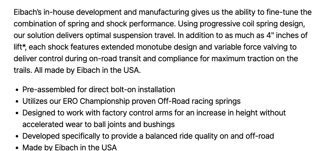

Eibach uses progressive coil springs. Those are always my go-to recommendation for entry level suspension. Comfortable for daily driving, and more than capable of mild off-roading. Seriously cannot beat them for the price.

Ford Bronco Any Entry Level Progressive Coil-overs? Screen Shot 2023-10-09 at 12.35.40 PM

You say the springs are progressive-- are the Eibach shocks also valved progressive? Or are the shocks linear or digressive?

Typically shocks will be either digressive or linear. Bilsteins like 5100 are usually digressive but they do make linear versions in the 5100 series.
I believe the stock Bilstein are digressive with the end stop valves firming damping near the limits of extension/compression.
Icon (digressive) and fox (usually linear) both have entry level ifp coilover options for the bronco.
