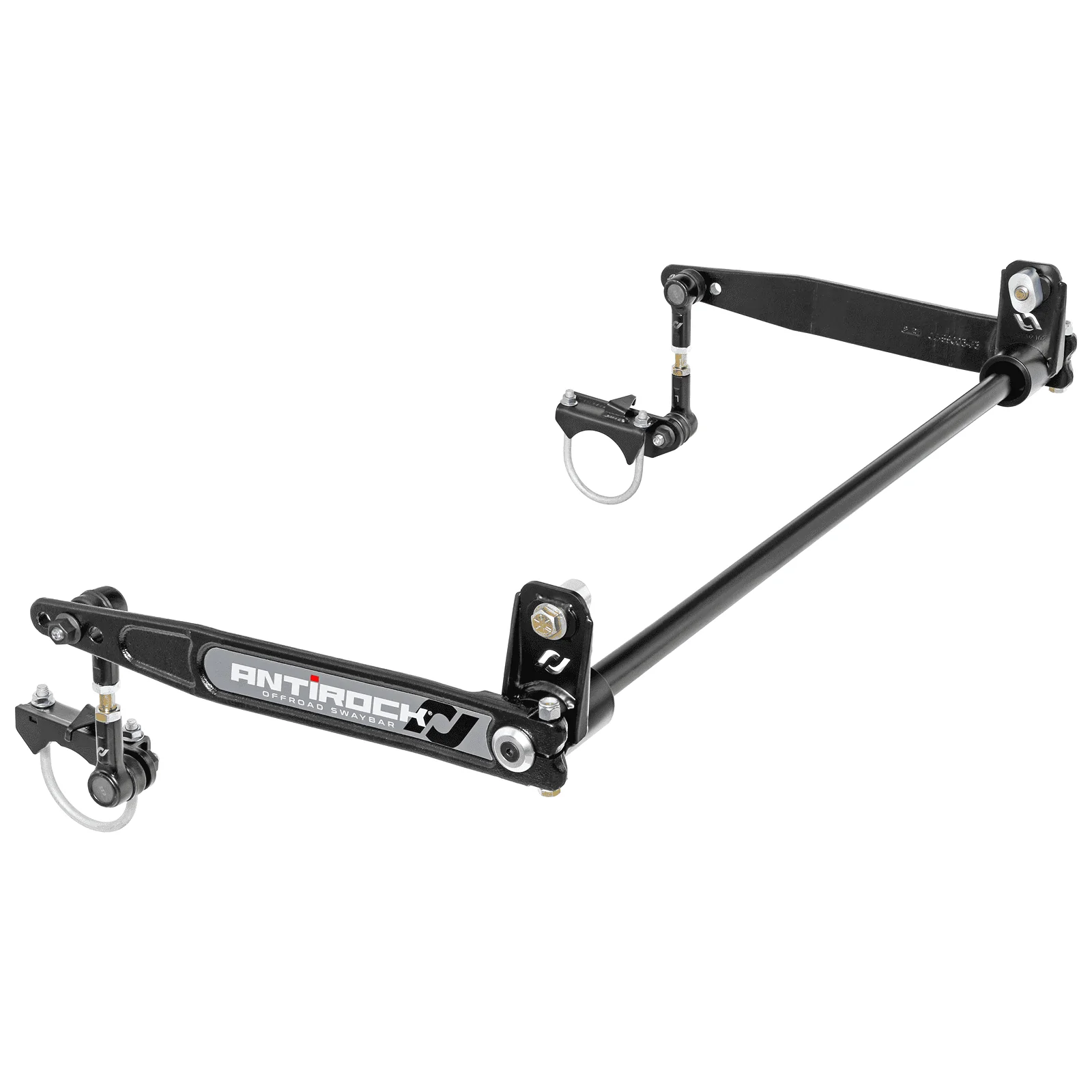

Product page: https://www.rockjock4x4.com/RJ-286200-101
It does require this high clearance AFE axle back exhaust: https://www.rockjock4x4.com/49-43147
Who is buying it?
I have the front bar and trackbar bracket, and absolutely love them both.
Details:
RockJock’s Antirock Sway Bar Kit for the rear of all 2021-up Bronco vehicles helps free up suspension articulation to increase off-road traction. By constantly providing resistance to the articulating wheel, the Antirock forces traction to opposite wheels.
The Antirock sway bar easily bolts on with hand tools, directly replacing the vehicle’s stock rear sway bar. The Antirock does not require disconnecting for off-road use!
The sway bar torsion bar is forged from 4130 heat treated chromoly for ultimate strength, which is the same quality used in professional off-road competition sway bars.
See the front sway bar thread here: https://www.rockjock4x4.com/RJ-286200-101

having a rear anti sway bar will add torsional rigidity to the rear. Left/right articulation is resisted by the torsional resistance from the anti sway bar. Uncoupling the sway bar (manual or electronic) removes the torsional rigidity and obviously increases articulation.
articulation resistance at front and rear can be provided by the respective anti sway bars. They will act as torsional springs in series in conjunction with the frame torsional rigidity. For any springs in series, displacement increases for the weaker spring. So adding a rear sway bar to a bronco without one will “push” displacement or articulation to the front. Even more so if a lighter bar than the 1 3/8 OEM bar is put on the front (like rockjoc bar). Which is just under 1” I think.
an oem rear bar with rear locker and no front locker will benefit from increased articulation in front with lighter front bar or disconnect. A rear bar can really help the front out.
