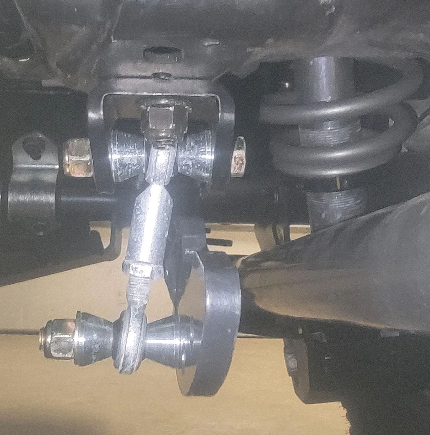

you need to remove bolt holding rear of gas tank strap. Do it when tank is near empty. I just wedged a jack in there.
We had a tough time getting the bar into place. Still confused on the attachment of bracket on the drivers side? Can't see how to attach a nut in a sealed space. See pic. Can you also take some pictures of how the final linkages look, when you get a chance.
Very frustrated with their directions and could not find an installation video
Thanks!
Ford Bronco Rear sway bar Belltech anti swaybar drivers side mount

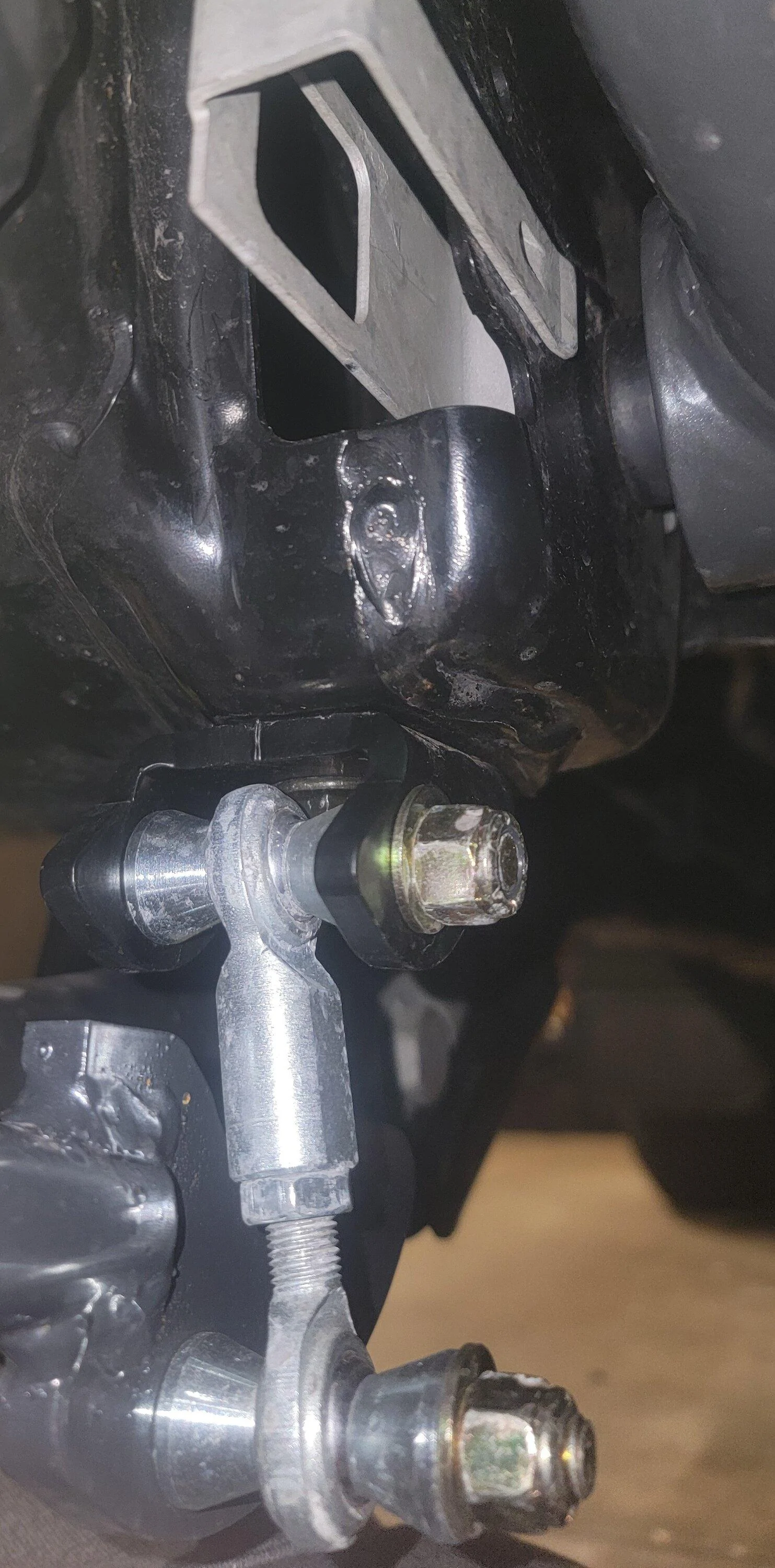

@prmaise here is the best I can get for you.
Ford Bronco Rear sway bar 20230226_213337
Ford Bronco Rear sway bar 20230226_213243

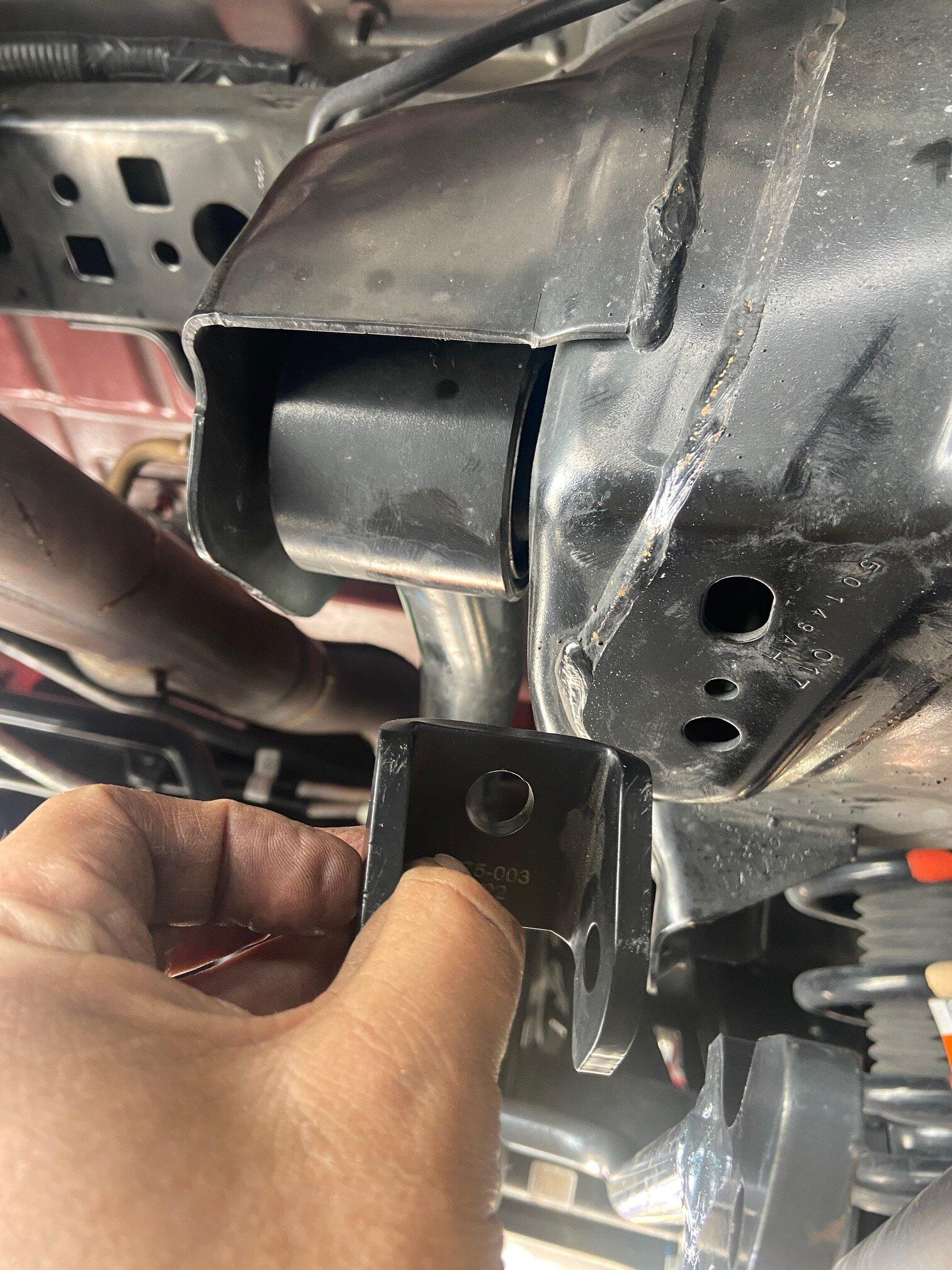

Just received my Belltech and installing next weekend . Which mounting did you use, the oem or sport hole?
