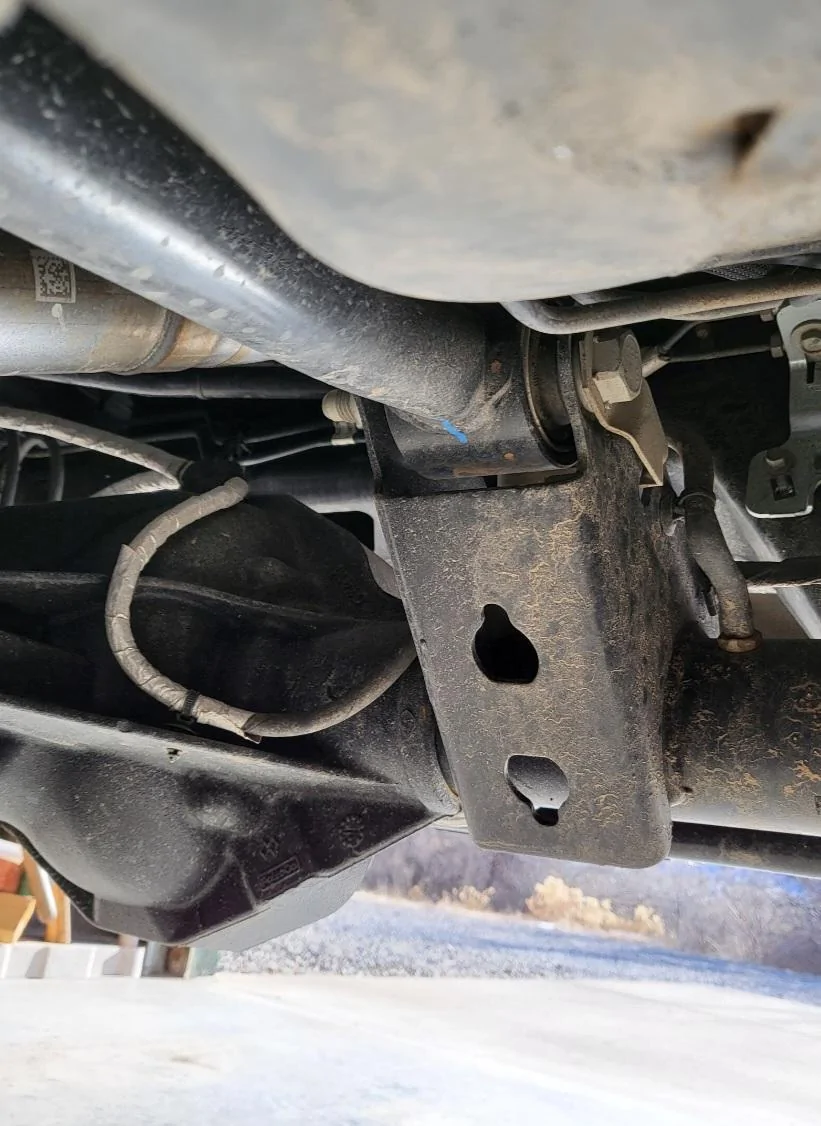

Right, I remember seeing that thread - but, I just assumed that if I was an early 2021 I was sh*t out of luck - no mount points. Figured some aftermarket solutions would come along - I guess this is it! So, from reading the install instructions for the Belltech - it's compatible with all 2021 and doesn't use the factory mounting locations. Am I reading that correctly?
It doesn't use the factory endlink mounting points. It does use the factory sway brackets on the rear axel.
Edit: here is a photo of the lower link bracket where the Belltech sway Mounts.

Thanks @tdiddy - that's present on my early 2021 build. Good info. Cheers.
