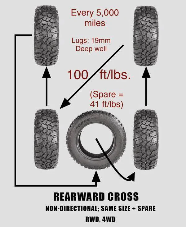

the other 700 threads on this subject will say largely the same things but I personally go with every 5k with oil changes.
My pattern of choice is the Rearward Cross seen here

Since I have short arms and can't remove my oil filter without removing the front wheel, I always rotate my tires when I do my oil change. Every 5,000-7,500 miles.
Fords manual in the display says do the rearward cross.
Ive been doing that with my oil changes every 5k.

Once a year, when I do my oil change, approximately every 6K.

I do the rearward cross method every 5k.

This is what I do every 5k during my oil change day. I printed this image and posted it in the shop. I think the important thing is to be consistent.

The 5 tire rotation is for 2 doors, but since I have a 4 door, how do I do a 7 tire rotation?
Hah... dangit you got me. Standing over the coffee maker right now giggling to myself.
Wife was less than impressed by the joke... "you and your Bronco people are weird".
Anyway, I do every other oil change, reverse cross.
Honestly the exact pattern isn't super critical, but it is important to stick with whatever pattern you've chosen.

If you’re getting it done at the dealer be sure to mark your spare. Two separate occasions I’ve asked for 5 tire rotation and both times the service advisor wrote it on the service ticket and both times the tech did not rotate the spare.
luckily I marked it and inspected before I paid and left the dealer.

I guess I’m a sheep following the herd:
5K miles with an early oil change here too. Takes about 30 minutes in my driveway.

I do the rearward cross and after my 5k oil change do the rearward cross. I take my WT to a local tire company show them which 5 tire rotation (they draw it on the invoice for the tech) and I also use tire chalk to ensure it was done correctly afterwards by numbering each tire.
Yep. Went to my local dealer (Galpin Ford/Prescott AZ), said "I want a 5-tire rotation". Service writer said "I'm not sure we can do that, we typically only do 4-tire rotations". I said "if you can 't do that then don't do the rotation at all". Got the Bronco back. They did a 4-tire rotation. Fixed it myself by putting the spare into the rotation.

I would be looking for a new dealer if they can't figure that out.
I just had a service last week and the dealer had no problem doing a 5-tire rotation. I didn't watch them do it, but since the four tires that were on the ground going in had mud on them and the spare didn't, it was obvious that the spare was now on the right rear.
