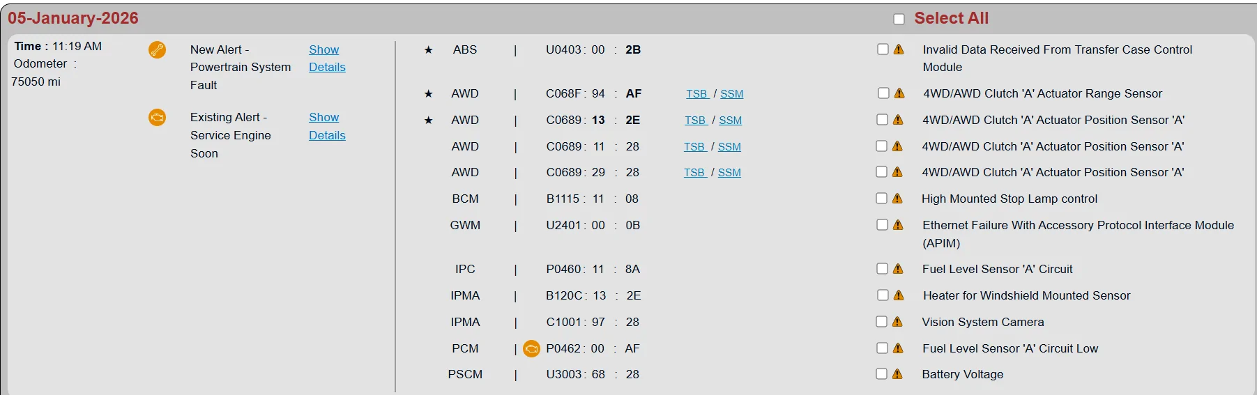

I know you're already aware of the fuel level sensor DTCs, but it appears you have a few more now for 4WD related issues.
Yikes.
Yeah. Waiting on the fuel pump recall to see if it fixes those. It's still being glitchy for now.
I'll have to dig into these other ones & see what it causing them.
