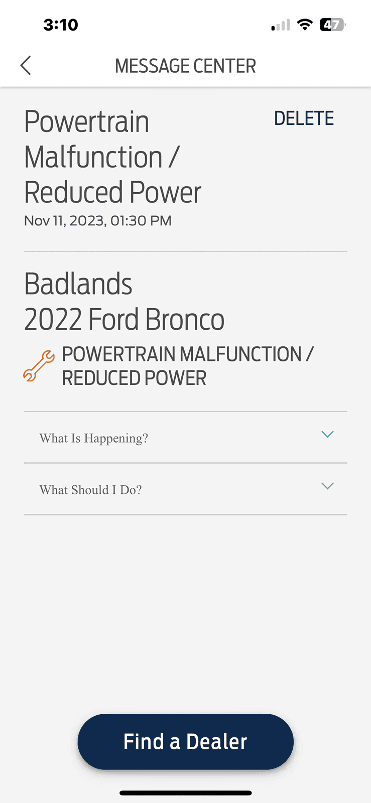

Yep, I am still dealing with my Powertrain Malfunction, after 5 months of the dealer having it and a Ford engineer looking at it, they say it works just fine, but no one at Ford can explain why I got this code and lost power and brakes.
Ford Bronco Powertrain Malfunction / Reduced Power unnamed

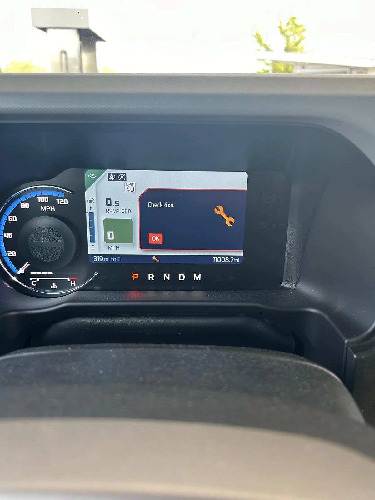

Long story short, I picked her up today at 4:30pm with no extra lights on dash. Then this:
Ford Bronco Powertrain Malfunction / Reduced Power IMG_3427
The saga continues!
Ford Bronco Powertrain Malfunction / Reduced Power IMG_3426

Thanks to @pillar406 recommendation, they ordered a Transfer Case Range Sensor that will hopefully be delivered on Monday and get me back on the road same day. Hurry up and wait...

Hey I'm glad I could help. Hopefully that will be end of this saga. Good luck and let us know how it goes.

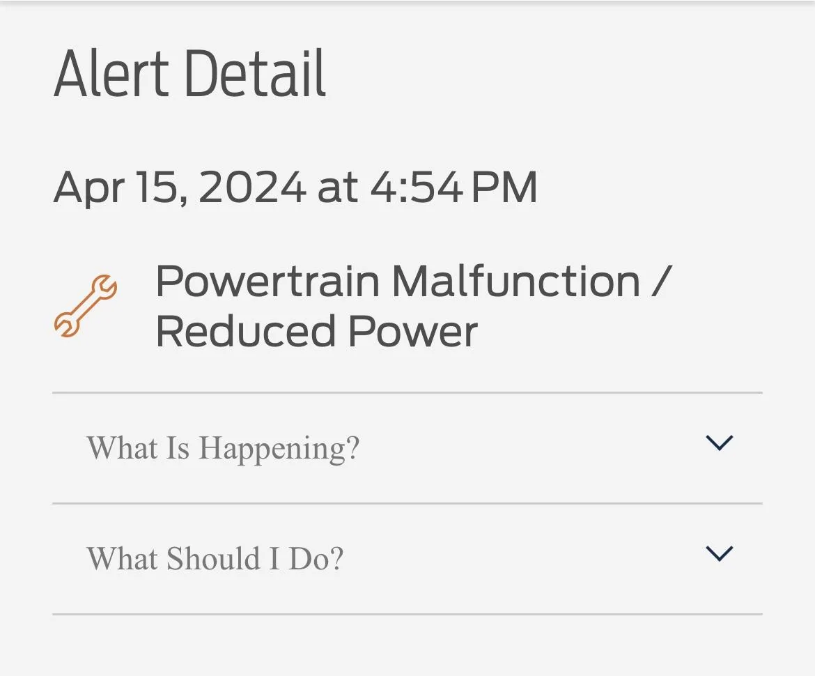

Same 2 errors occurred to me today. 23 OBX with 12k miles. Bronco wasnt even running, I was sitting in it with the engine off when I got the alerts on my phone. We were less than 2 miles from a dealer but Service was closed for the weekend. So we headed home. Performance was not effected at all, no new noises or weirdness. GOAT modes were able to be changed with no issues. Last software update was 3/29 and was the Ford Power Up 6.1.0. Totally stock, never taken offroad (yet!). So I'm gonna let it sit overnight and go from there.
UPDATE - Started it up today and the Powertrain Malfunction/ Reduced Power Mode (wrench light) went away. Received the same (Updated time/date) - Engine Service Soon (Engine Light) Warning shortly after taking a lap around the block. "The engine control system has detected that the turbocharger wastegate may stuck closed and to request service to prevent possible system damage".
Again, seems to drive fine. I did read another thread on here about a similar issue and unplugging the battery for 5-10 minutes made the error clear too. Either way its going into the dealer in the AM.
