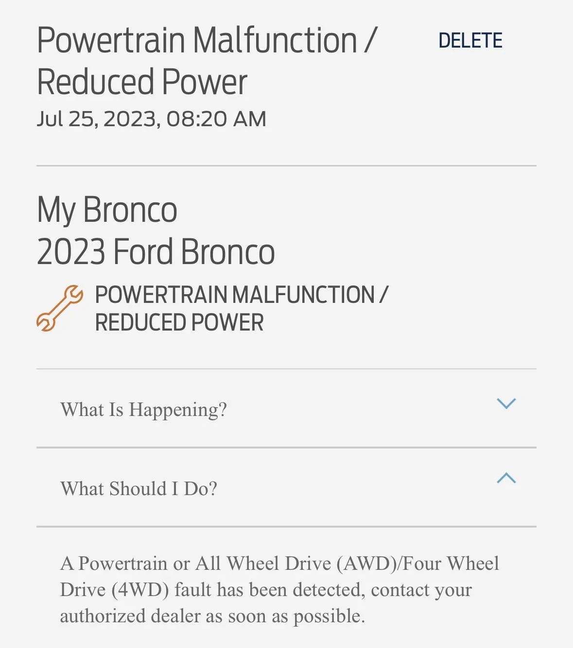

Haven’t even had my Bronco 24 hours and I get this…I guess it’s better than my last Bronco which was 6 days old and had the entire wheel fly off while I was on the interstate.
Mine did the same thing today . Please update 🙏

I just had this happen to me on way home today? You were told it was software? I hope that’s only it. Seeing your posted calmed me down a bit. I still have plenty of power in the bronco.
I have the same issue I didn't go into limp but all is the same

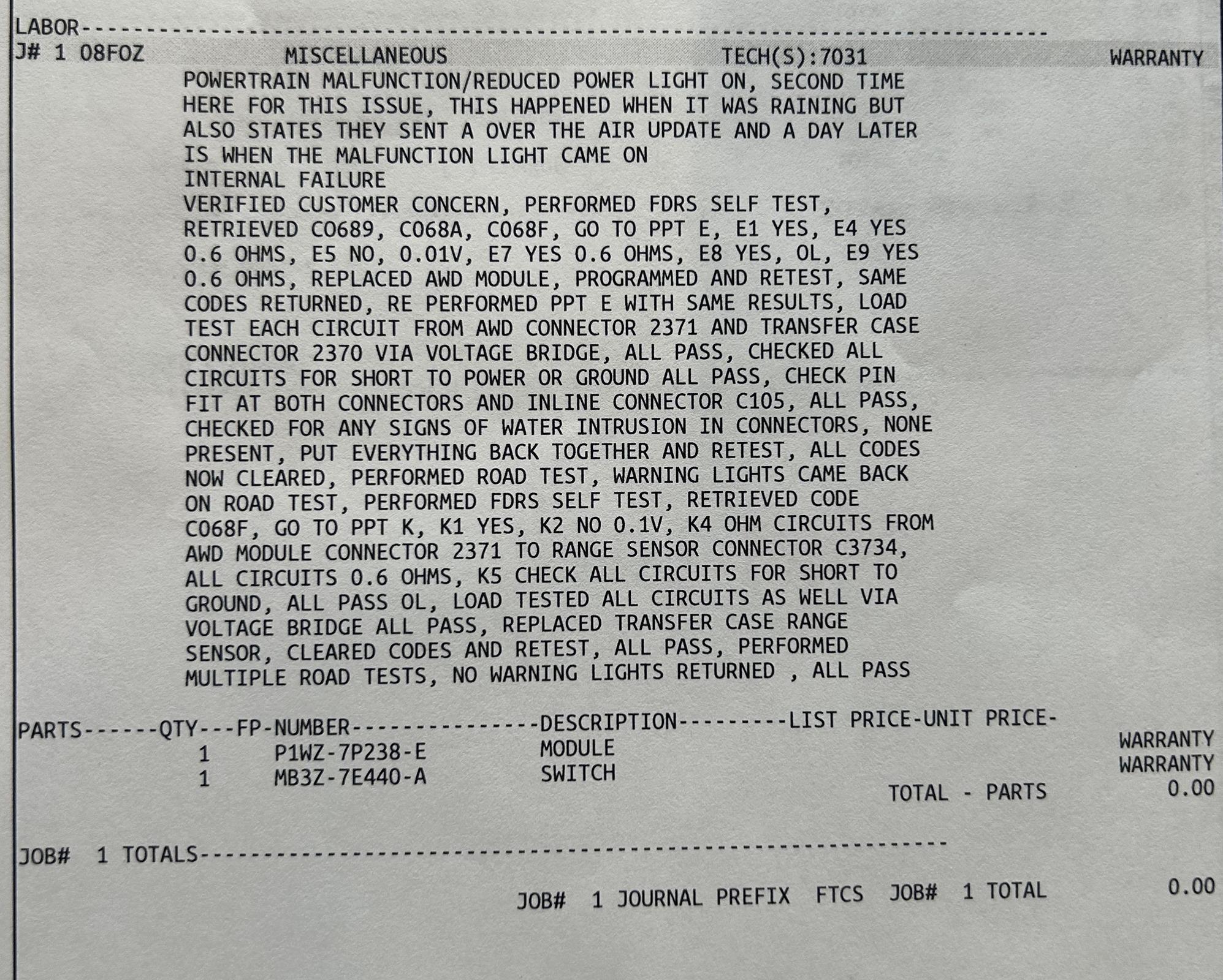

Add me to the ""Powertrain Malfunction / Reduced Power"" error list. FIVE DAYS OFF THE LOT car :mad:. 2 door 2.7 OBX. Mine won't access any 4x4 modes. At least it's only 'stuck ' in 2H.. but no lights on the GOAT controller. Heading to the dealer in the am. Will watch this thread as well :/
This is exactly what mine did today also no goat ! Or lights. What did they say with yours ?

Ok so please tell me what to tell my dealwr yo do cuz they are idiots and I already know they will say it's fine do module but I don't think it's that as my goat is also not functioning right or able to transfer to any 4 x4 options. No lighting in that area either.

^ My thought was/is that anyone could share what was done to mine with your dealer... I've driven >800 miles since with no extra dash lights. Good luck!

Mine ended up being a faulty turbo. They replaced it without issue. Im so glad I didnt wire the roofracks light bar through the turbo. LOL

I was having similar errors and after 1.5 years (not kidding), 2 front differentials, 2 transfer cases, 2 front driveshafts, both front axle shafts and many trips to the dealer, it's finally fixed.
Software update for the ABS module and a broken turbo actuator arm.
