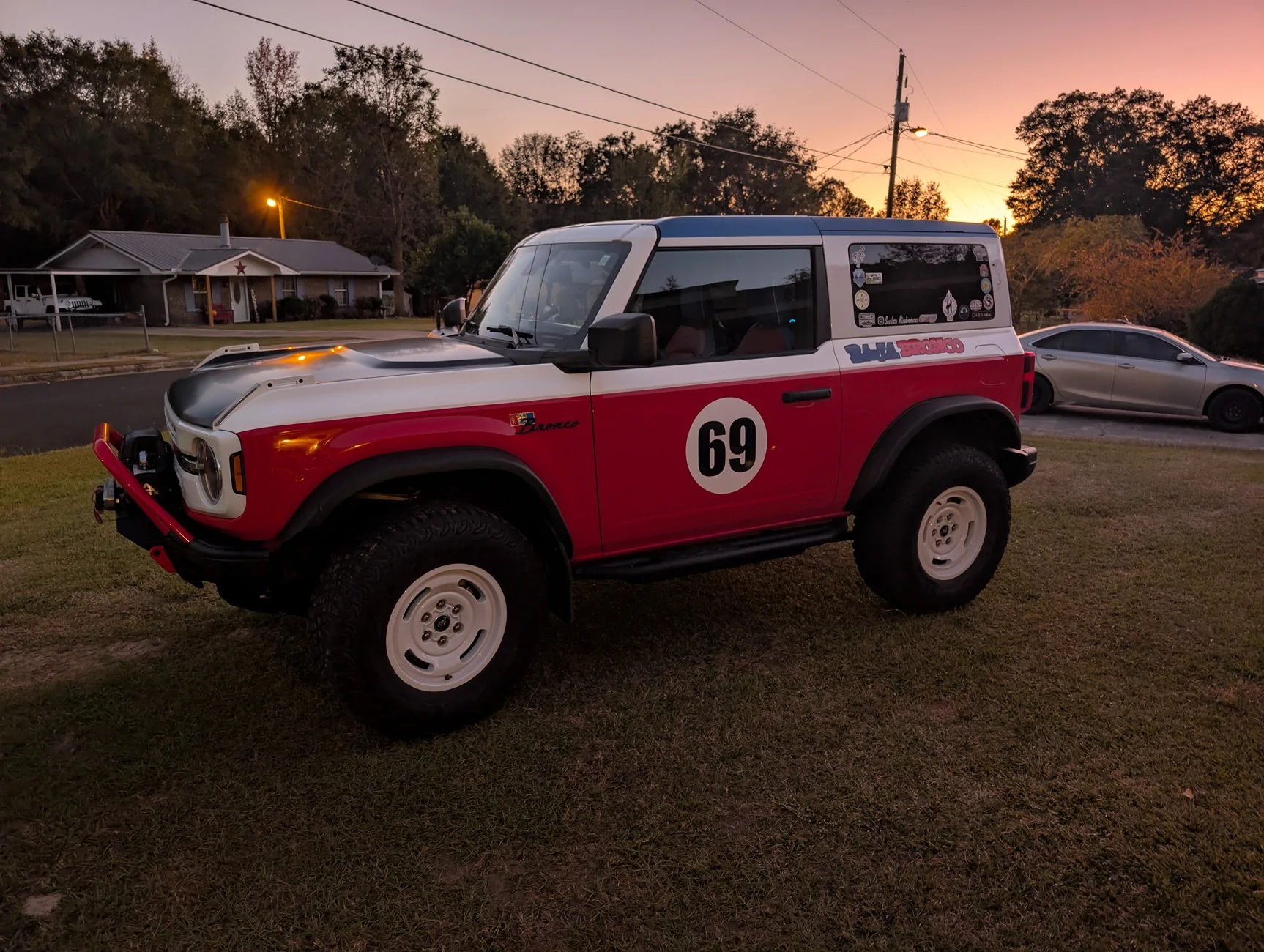

I went from the factory Hoss 2.0 Bilstein units on my 2 door Heritage Edition to a set of Wildtrak 4 door Hoss 3.0 Fox takeoffs.
I have a 4WP bumper, winch plate, and Badland Apex 12k winch.
Measuring fever flare to tire, my front is either level or a hair higher than the rear.
With no extra weight, the front would be higher.
I gained about an inch of lift in the rear.
With no weight on the front I would guess at least 2 inches of lift in the front.
I would run at least a 1 inch spacer in the rear in that case.

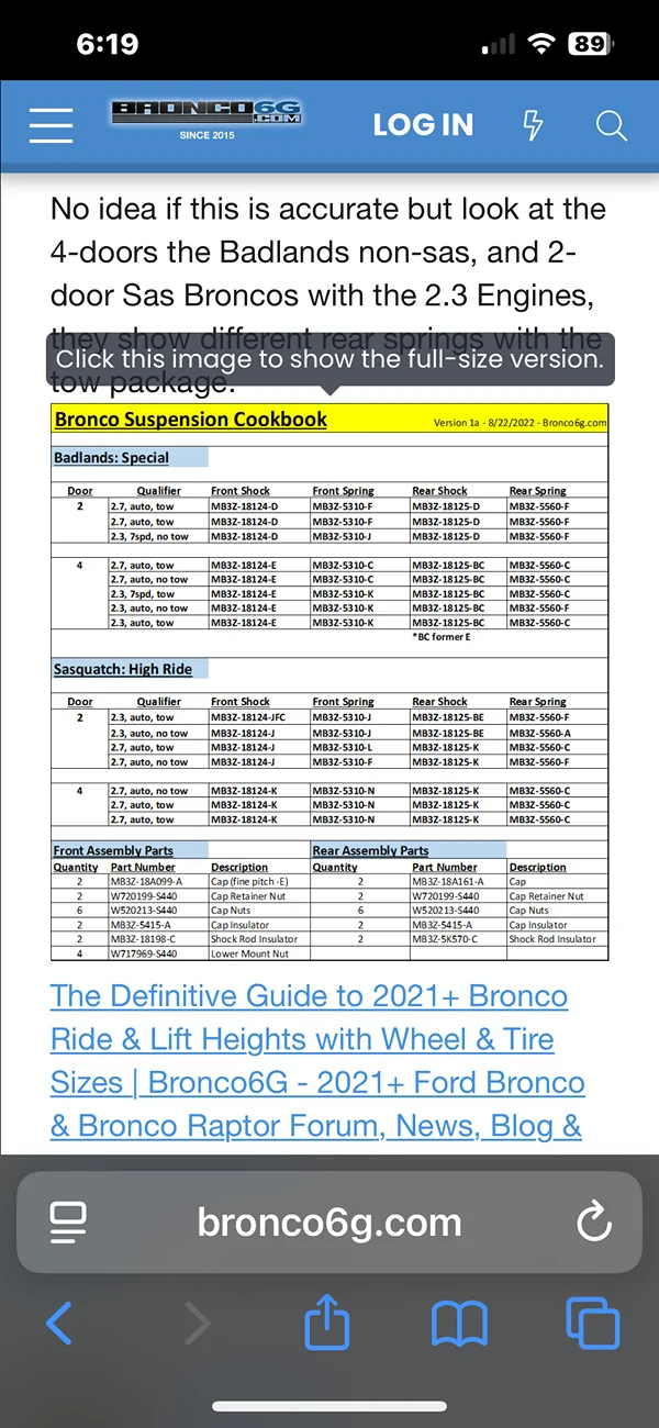

This in its essence a simple request. I would like to know if anyone has swapped 4dr shocks and springs onto a 2dr? I know about all of the trim and tow differences and 2.7 vs 2.3
Ford does it... between 2dr w/different combinations , same for 4dr ... but NOT between 2/4 doors... [maybe 1 or 2]
I don't think anyone has the spring rates, but you 2022 and can find a combination with what you plan on ending up at and then look for those part numbers.
I cannot find my link but attached is a chart post here.
My 25 uses different spring numbers so it's limited in help. I am added a little front weight and may use the 2.7l front springs that match my combination.
