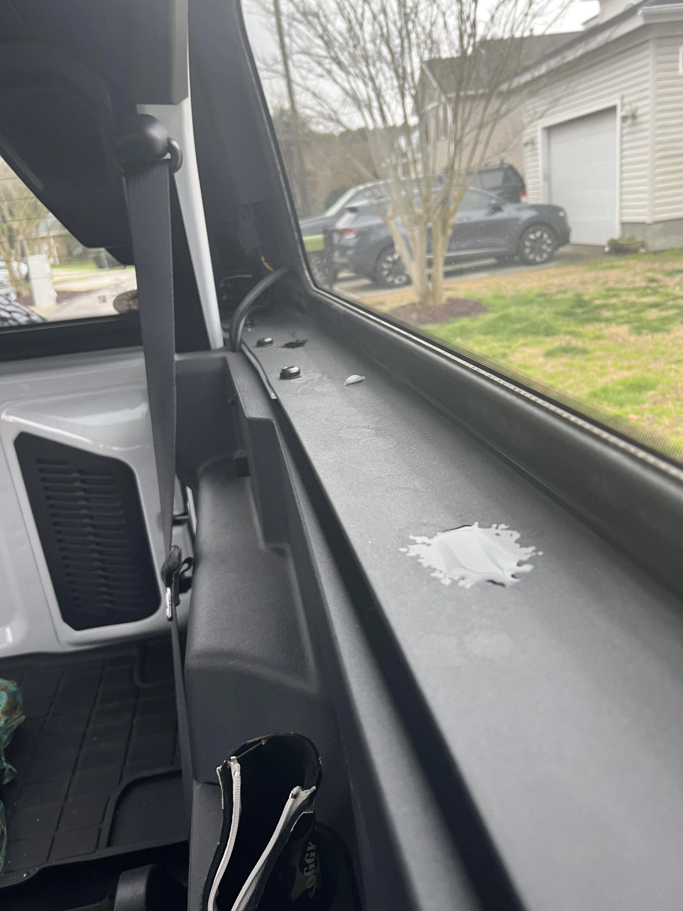

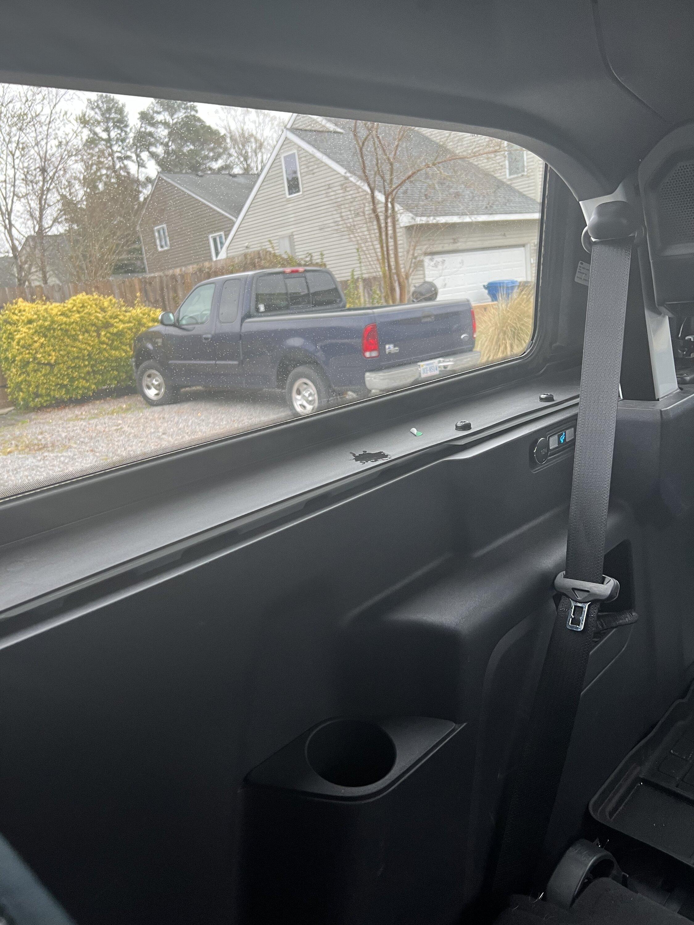

My 2022 2dr seems to leak a little when it rains. Always the same 2 places ( one on each side) Not a ton of water but it leaks. Water accumulates where you see it but can’t tell where it’s coming from. Top was off one time, front panels maybe 3 times. Any thoughts? TIA

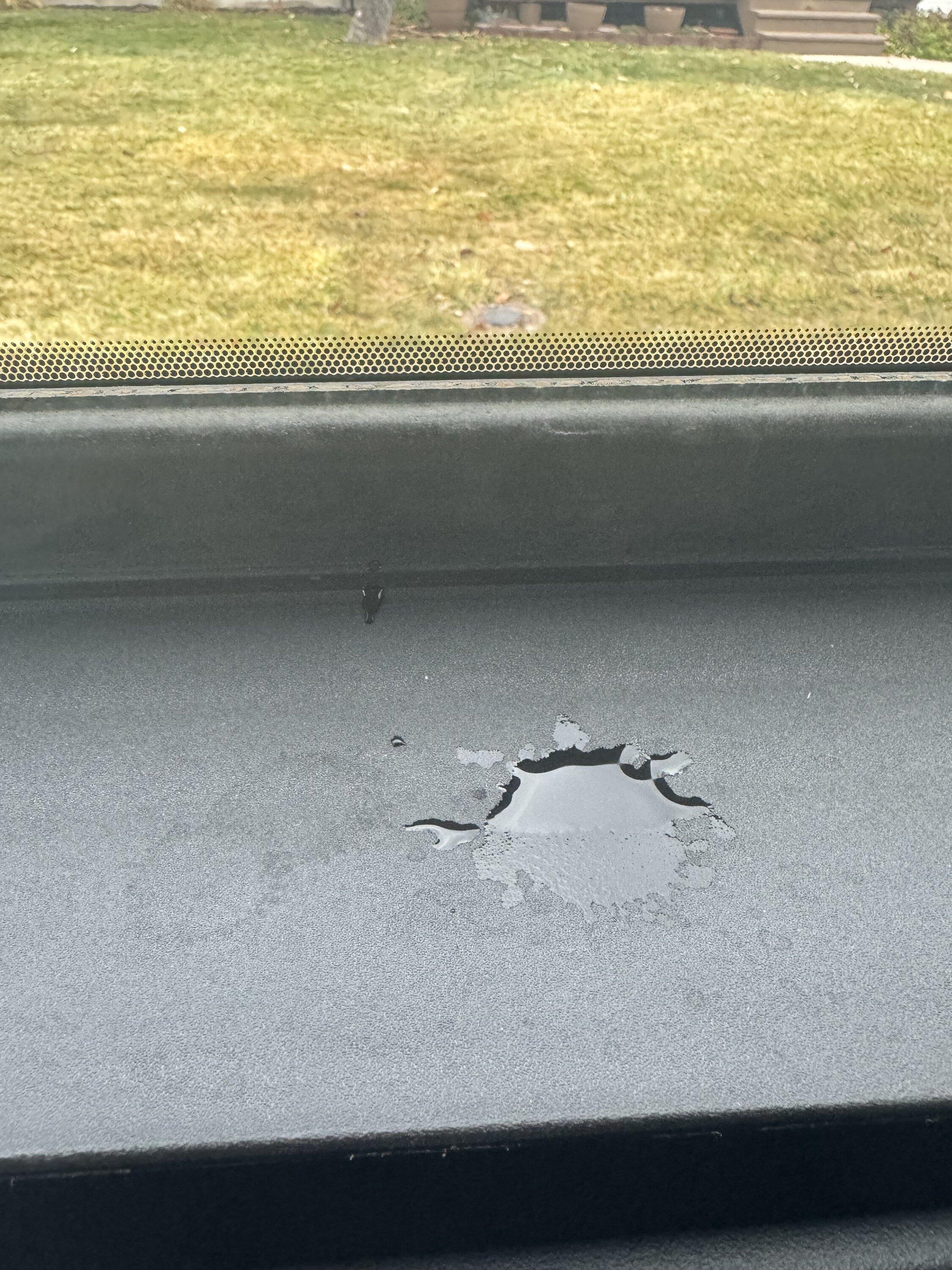

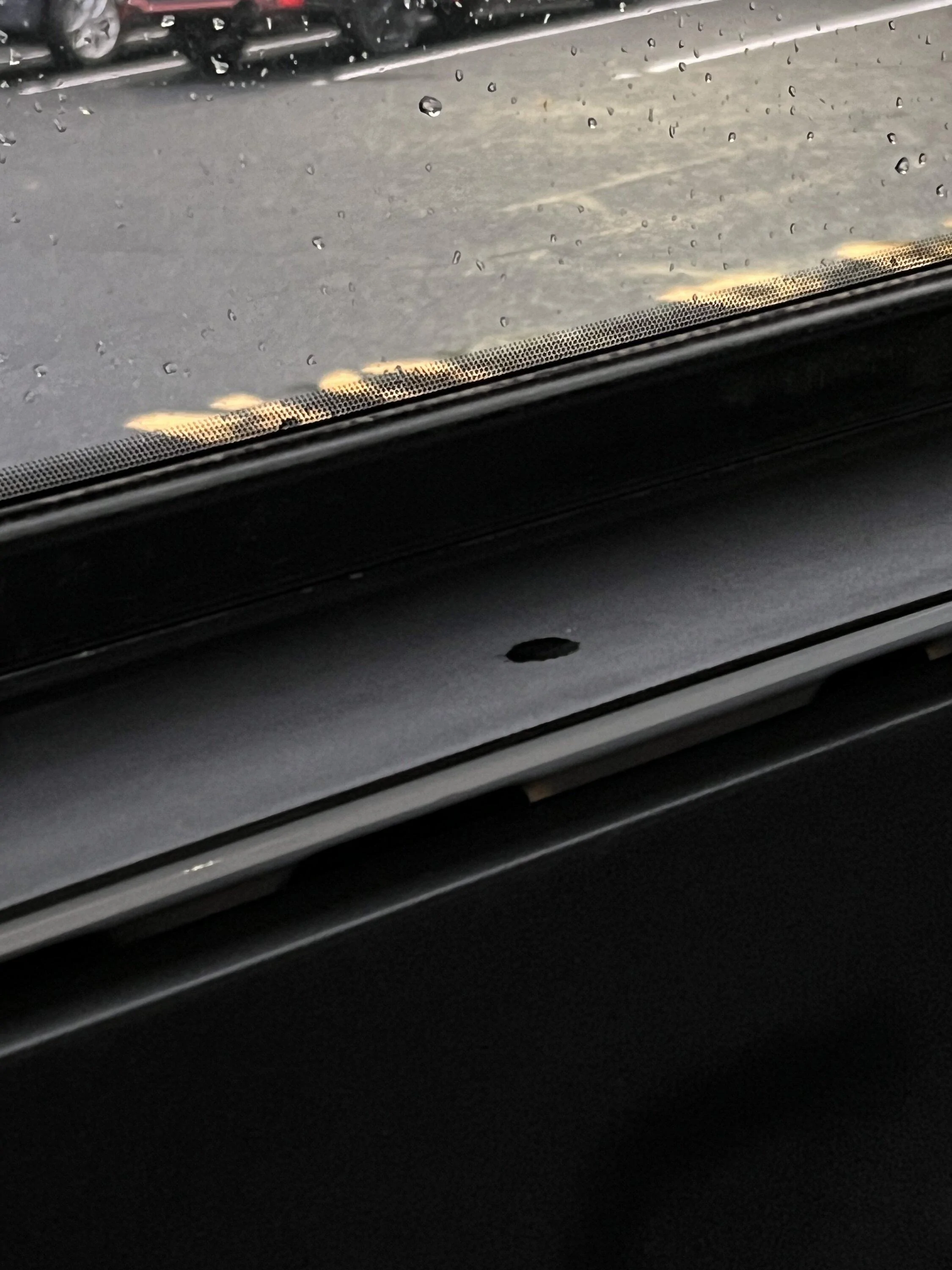

I have the same exact issue on my ‘23 Wildtrak. I have not discussed with the dealer yet, but plan to when I schedule service soon.

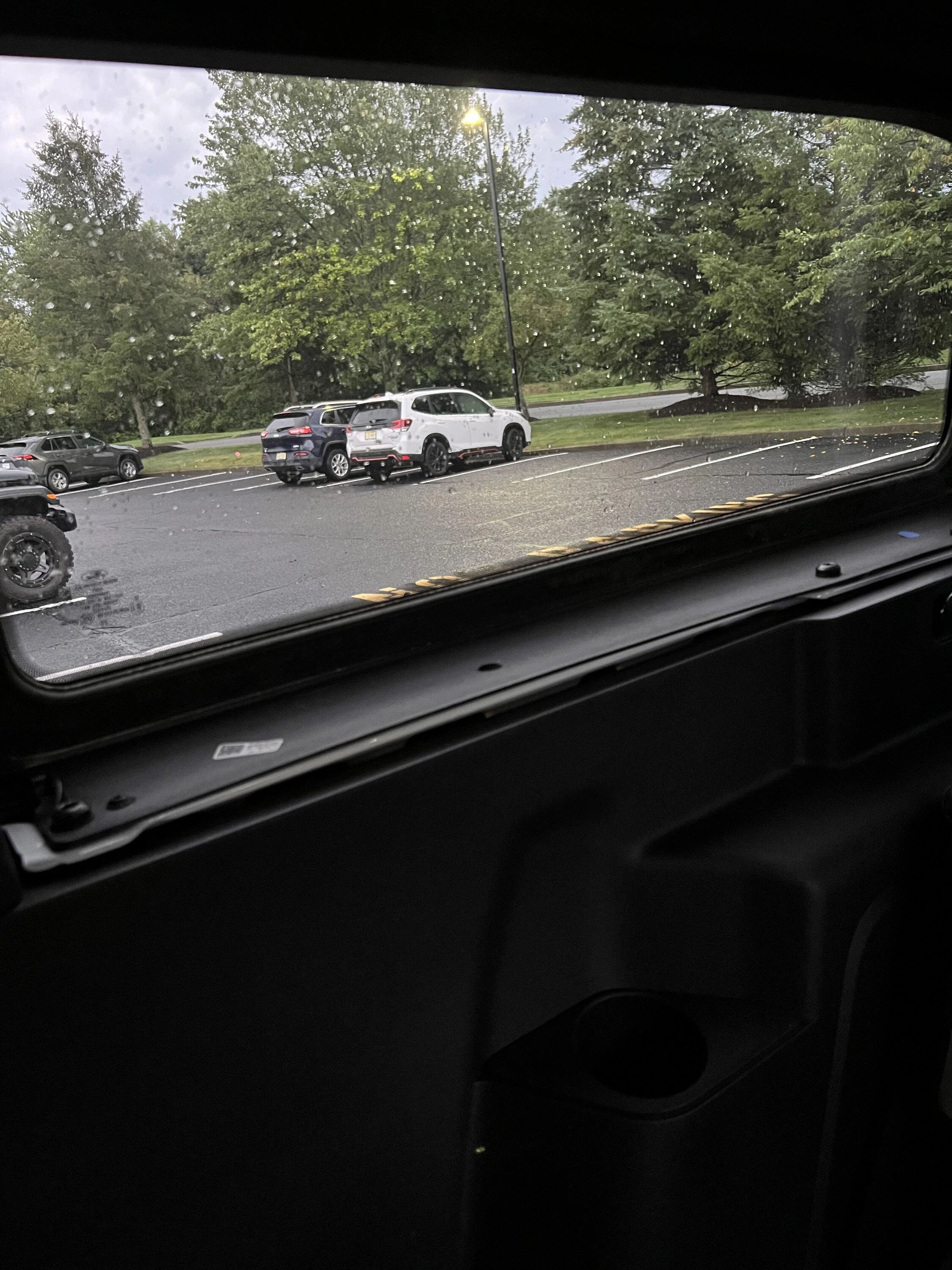

same issue 23 badlands 2door dealer took it though the wash and said “unable to duplicate concern” pretty unhappy.

Hi @Ford Motor Company ! Thank you for the quick response to my concern. I ended up figuring out how to address the issue. Here's how:
  1. I suspected the cause could be a poor seal to the B-Pillar from a change in temperature since the top was last reinstalled in warm weather.
  2. I loosened the hard top mounting bolts and the rear latches on the roof panels.
  3. I then went to the back of the vehicle and gently pushed the top toward the front at the two C-Pillar locations.
  4. I tightened down the mounting bolts and secured the rear roof panel latches.
And.......all fixed! There have been several hard rains since the adjustments were made, and there are no drips along the window. If anything changes, I will certainly let you know. Happy New Year!
