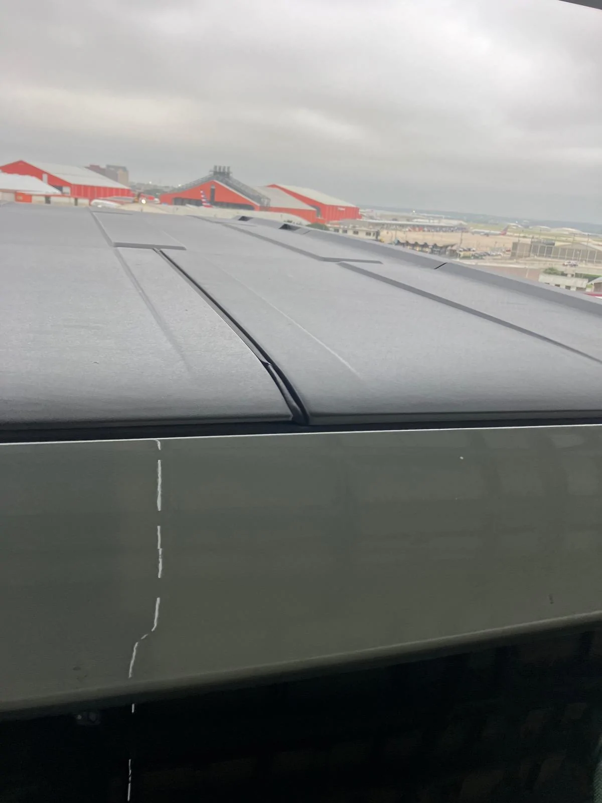

Thanks for your advice. I noticed the leading edge of the panels is also different from left to right. If you zoom in on the picture, it’s easy to see.

Thanks Bryan,
Watched the video, love the Stihl Ballcap…question regarding panel alignment. I’m assuming Ford has instructions for adjusting the front panels independently? I think the drivers front panel is not contacting the header seal correctly.

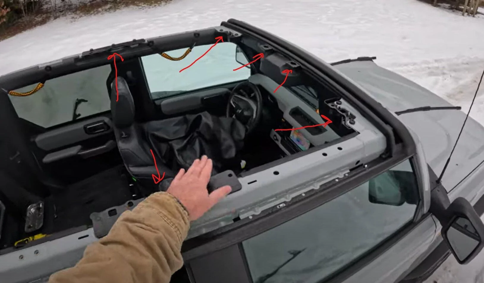

Yeah there are six adjustment points, three on each side. Behold my crappy picture!!
Ford Bronco OEM Hardtop Replacement- drivers side leak 1717963251386-uz
The four outside ones are easy to get to, you can see the bolts immediately after removing the panels. The center two points require you to remove a bunch of trim pieces and are a bit of a pain.
Again, you can take it to a dealer and they can check the gaps to make sure they are within spec. May make the most sense since the hard top was just replaced.
