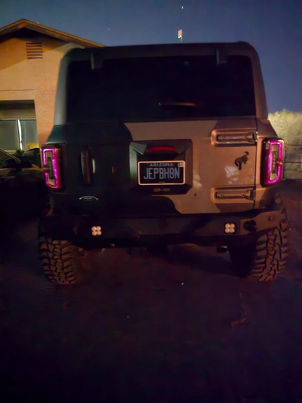

SO I played around with adjusting the passenger rear door glass, raising the window up helped a little.

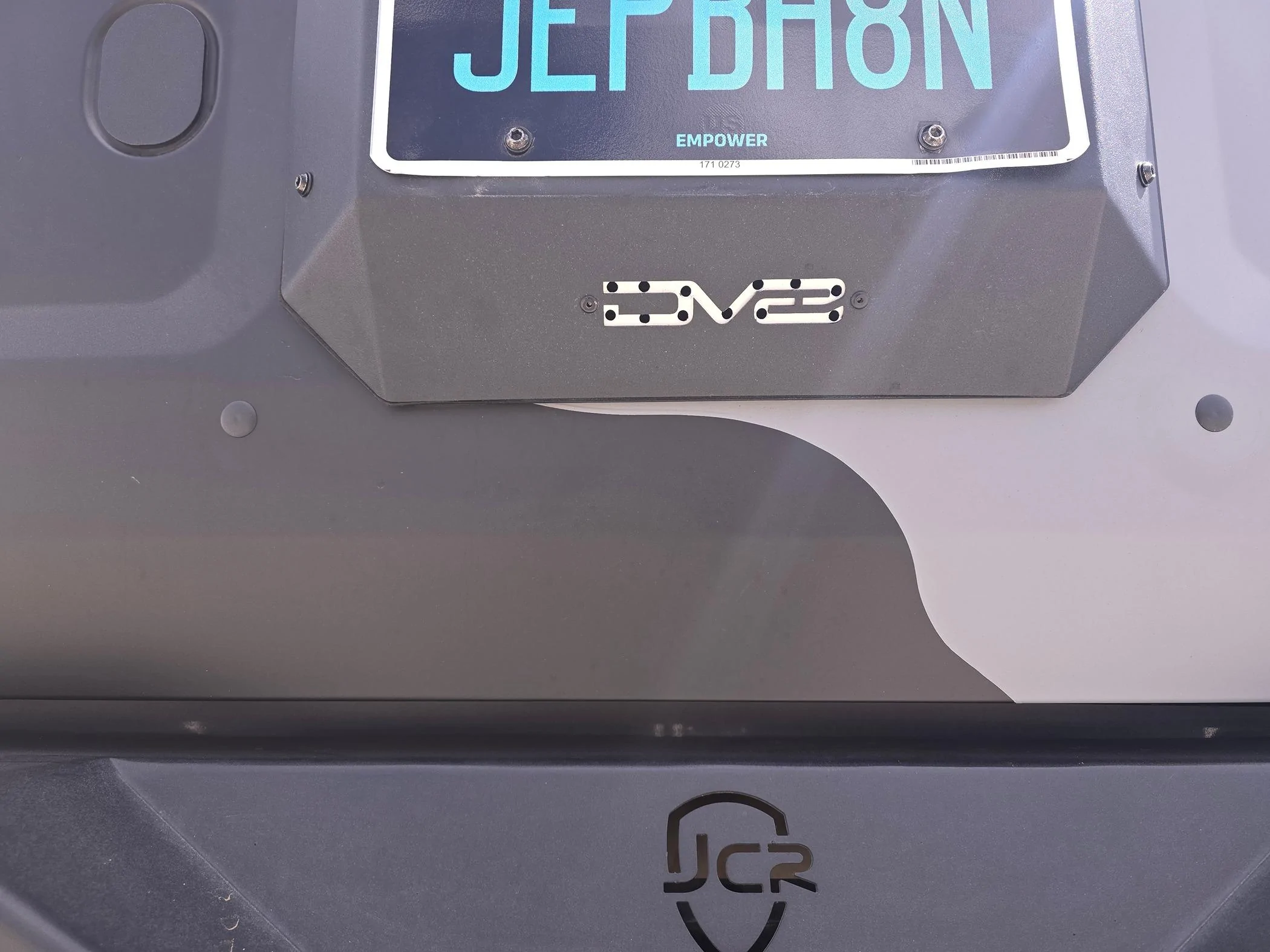

I also noticed that there seems to be some leaking air on the hard top as well as around the license plate light on the DV8 spare delete. I loosened the spare delete plate and that seemed to stop the air leak on the passenger side window.
It looks like the spare delete from DV8 does not allow enough air pressure relief out the rear vents in the tail gate. Not sure if its big enough deal to to drill some additional holes in it to vent more air.

Glad you got it figured out. Not sure how the spare delete looks internally, but maybe you can add spacers behind the license plate to give it some extra space to breathe?

The DV8 kit is in 2 parts, one plate bolts to tailgate and then there is the cover that bolts on to that plate. The first plate has a foam/rubber gasket that the top part seals against. The license pate could be lifted away from the mounting service with some extra washers I guess.
I did drill some holes in the aluminum DV8 plate on the bottom, did not seem to help much, I think with the factory spare tire carrier it allows for those vents in the tail gate to vent fully with no obstruction.
Its only an issue if I have the fan speed set at 6 or 7 with recirculate off. I use recirculate pretty much all the time, in the summer I have never used the fan speed above 5.
