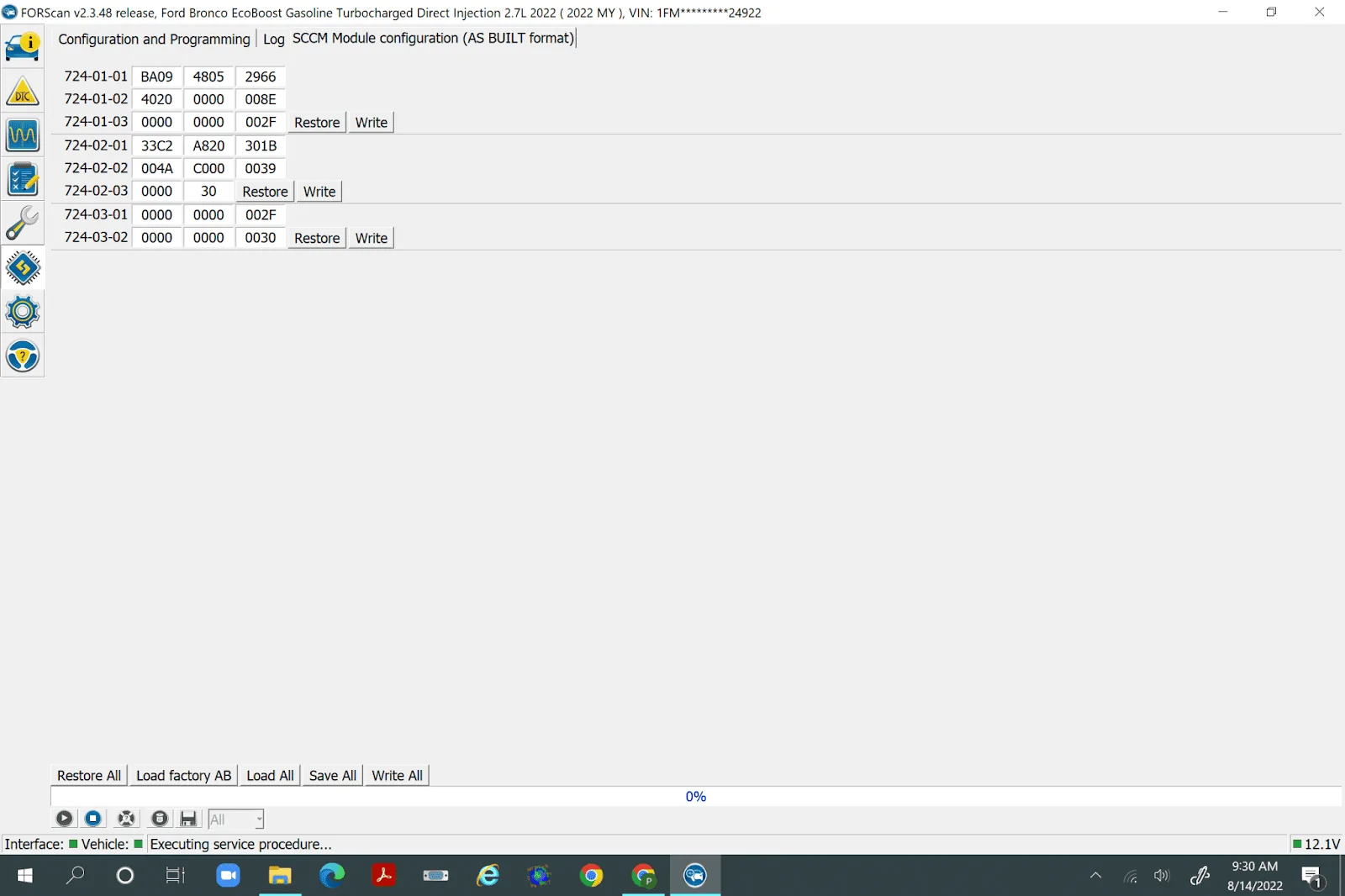

What are the values present on your vehicle?
I did the EASY config. today on the double-honk, and followed your instructions on cycling the ignition before hitting "OK", it worked - thanks.
The advanced method of changing configuration characters still confounds me - if you recall, my Bronco already shows the value that I'd like to change it to; for example, the turn signal flash times config. for indicating 4 times is to enter an "8" in the second position in the second series of characters (see Litvinup's spreadsheet row below) - the config. that I pulled up from my Bronco already shows an 8 in that position, but it still only flashes 3 times as per factory setting.
Below is the Config. spreadsheet from Litvinup (first image), followed by what I pulled up on my Bronco (2nd image). Since Litvinup's spreadsheet applies foremost to the F-150, I wonder if the Bronco's setting in this regard is different?
SCCM724-01-01xxxxx*xxxx0=1 flash, 4=2 flashes, 6=3 flashes, 8=4 flashes, A=5 flashes, C=6 flashes, E=7 flashes ** see SCCM spreadsheet for more options **
** when trailer is connected the truck will add 2 flashes to the above values **
My existing settings:
Ford Bronco 2021+ Bronco ForScan Thread ZaG6Yi_MpaVoB6sn0kRRlR9PXOPIeTvX23QmC5o8RovtQDPMwQ
Thanks for you help.

I'm glad it worked out.
That said, the lastest BRONCO-SPECIFIC spreadsheet I've seen on this site has the turn signal count crossed out...as in it doesn't work?
Might/ must be different; just never bothered me enough to dive into it. Maybe someone smarter than me here can.

Interesting - can you direct me to that Bronco-specific spreadsheet?
I'm not particularly bothered by 3 vs. 4 flashes, but am just curious as to what's going on. I'd also like to get rid of the DO DO DO chime, but haven't looked into that yet to see if that also has the same issue for me.
Thanks again.
