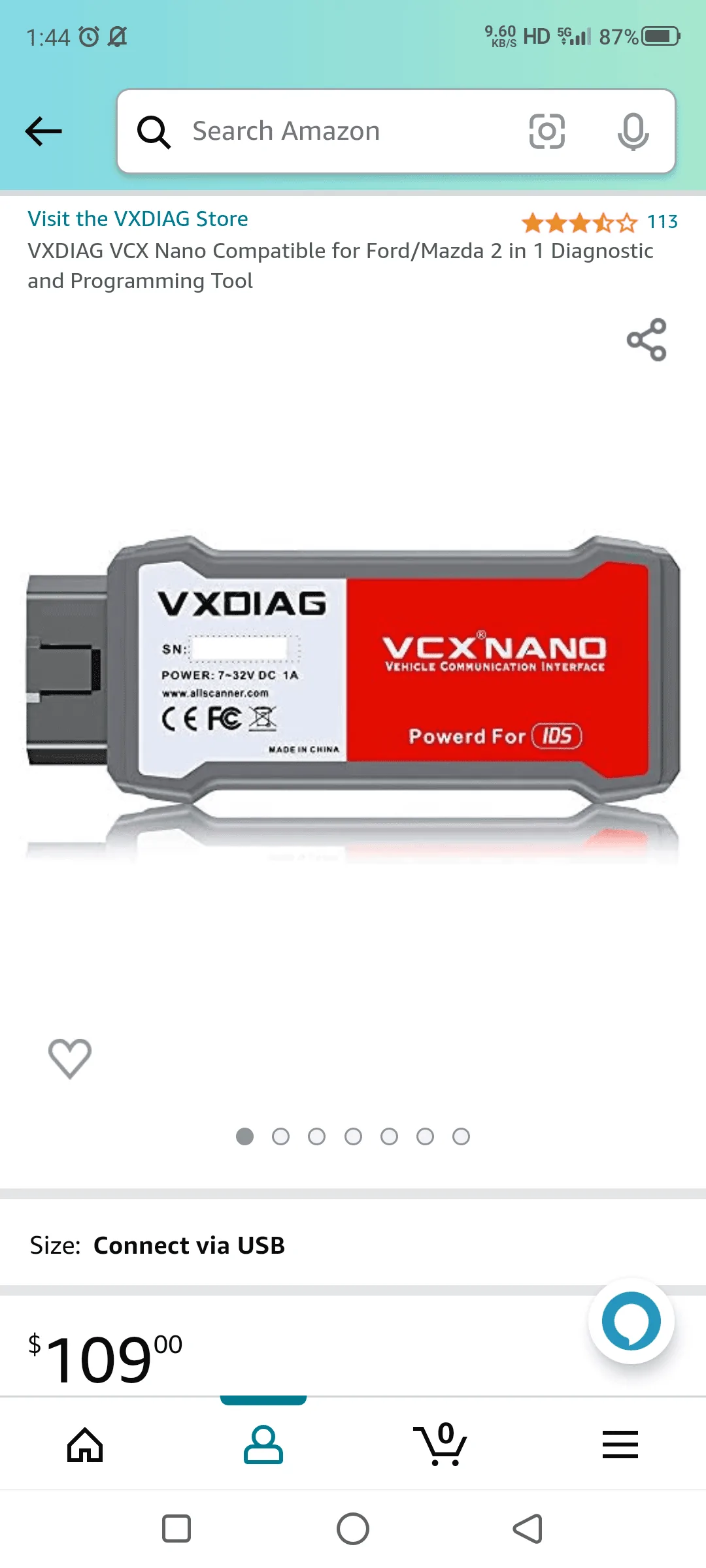

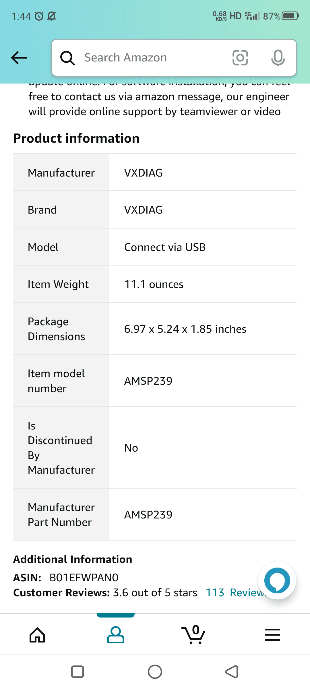

This is what I recently purchased, but I still have to test it out. So don't jump on the grenade based on what I am doing.

Mind if I ask which adapter you bought? It's been some time since I looked for one but at the time they were a bit much for the few things I would truly need it for.
I’m using:
Vgate vLinker FS OBD2 USB Adapter for FORScan HS/MS-CAN Auto Switch https://a.co/d/ifsA6UI
One of the ones linked to from forscan web page.

I wasn't asking about his Forscan adapter but his more advanced program interface.

Yep, that's the price point I was familiar with.
Wish there was a way to just rent one as needed.
BY THE WAY, I AM HAPPY TO REPORT THAT THIS WORKS WITH FDRS.
