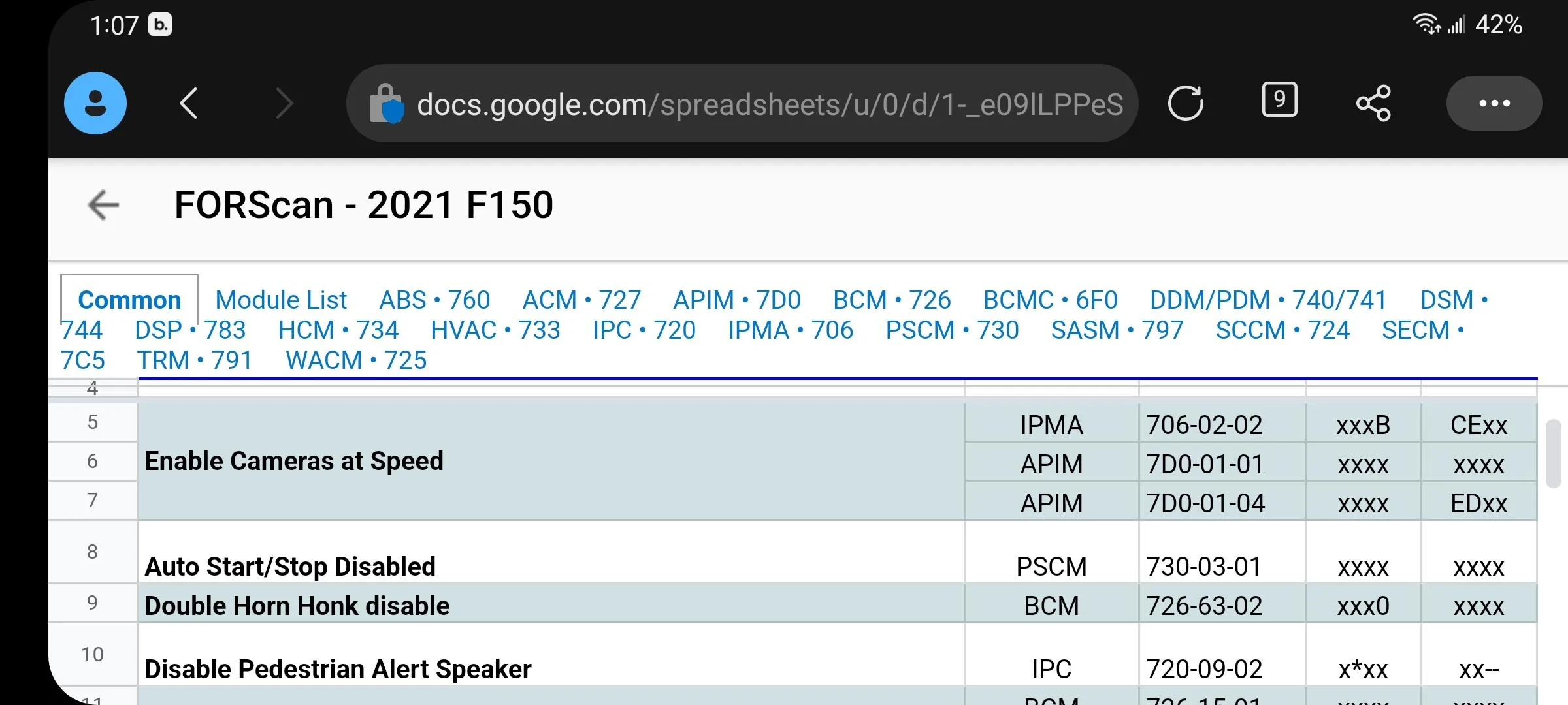

Asking for some help here. I was using ForScan v2.3.43 and could change BdyCM 726-63-02 to disable Double Honk. When I go into PSCM to disable Auto Stop Start at 730-03-01, there is no Write button to enact the change. In addition, in BdyCM, I only have codes and no words to try to identify the line with tire size to go from 33s to 35s. I have downloaded the latest version 2.3.46. Standing by for instructions on what to do next to correct tires and turn of A.S.S. Thanks.

Anyone play around with the camera/speed settings?
Doesn’t do anything. The safety Nannie’s are controlled by the PCM sending out a speed signal. We can’t get into that yet. Only option is a hardware mod to interrupt this signal at the harness.

There is something going on in Baja mode, which allows cameras above normal parking lot speeds...
This signal/setting is likely what we wanna find 🤷
The setting is “off-road”. That’s why it states “for off-road use only” when you’re in those modes. I bet there’s a way eventually to say the vehicle is in an off-road mode but it’s not so simple as of yet.
