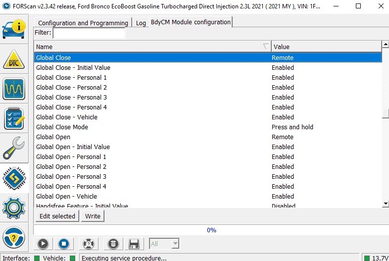

I just noticed in the F150 "Common" tab it says PDM is enabled for Roll Down and BCM for Roll Up...so, I am going to go back in.
I am new to this. Why are there some Feature Names in multiple Modules?

I enabled global close on my Bronco several weeks ago. I recall having to enable it in maybe 3 different places. To close the windows you press and hold the lock button. I can connect to it this weekend and get the details if needed.

SUCCESS! I needed to Enable it in BdyCM, PDM and DDM. BdyCM actually had a bunch of nodes that needed to be activated. See below. I just matched the Global Open settings and then Enabled in both PDM and DDM.
