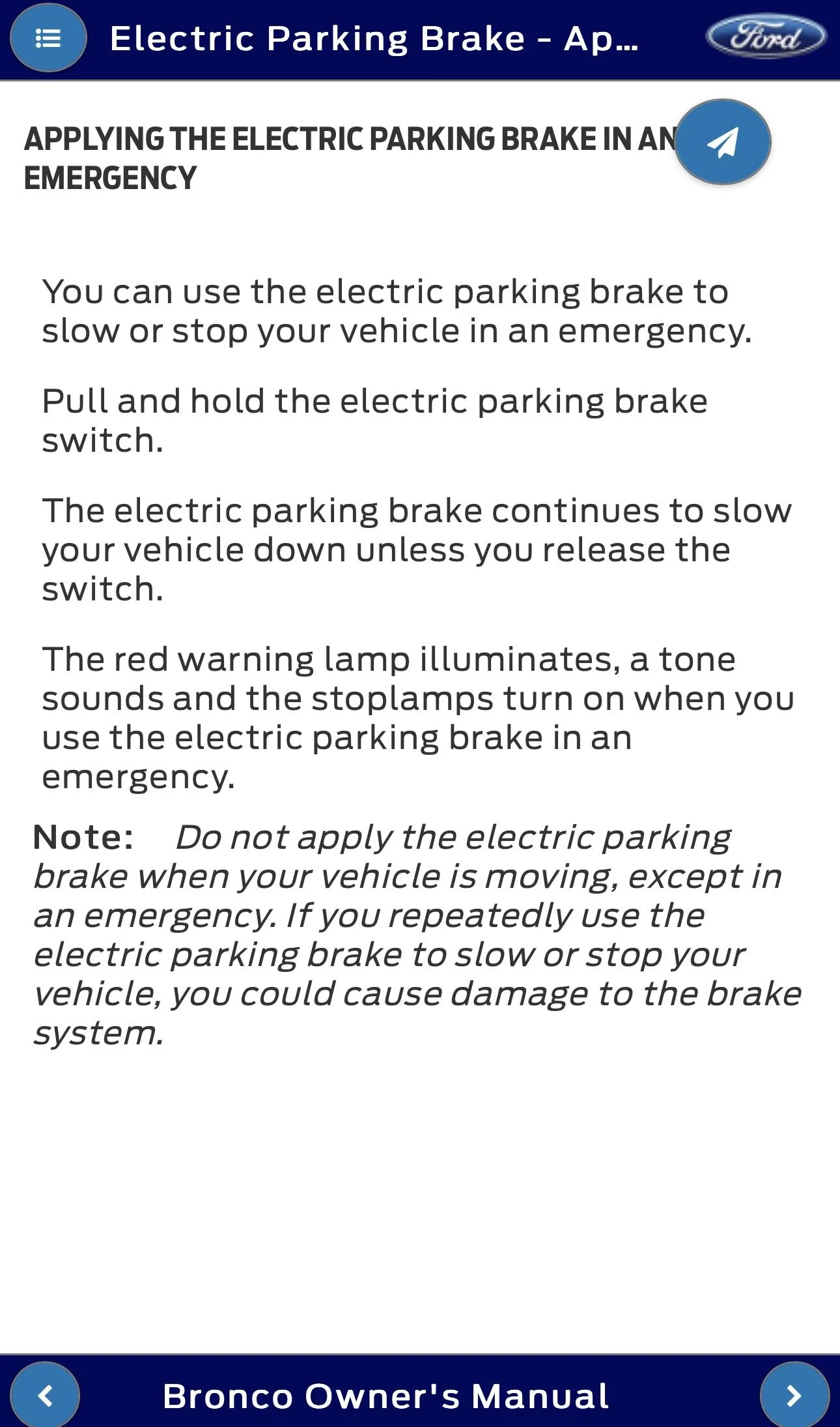

It can be used in an emergency in some situations. Not sure how well it works though as I’ve never tried it.
Interesting, it seems as though the switch is either on or off. I'd like to give it a try but doesn't seem to be highly recommended.
Ducati1098
10,048
23,421
Midwest
So you gotta pull it and hold it for it to apply braking? Is that even if there's no power?
It obviously will need battery power to still activate, but I believe it will work whether the vehicle is running or not.
Bmadda
Jul 18, 2020
2,902
6,830
Wisconsin USA
1990 Bronco eddie bauer
I did in a parking lot. Stopped real good from 10-15 mph. No idea about higher speeds.
My point is they did not even try to activate it.
Huh...not sure why mine wouldn't do it? Light came on, then flashed, and it seemed like they started to apply then released. My foot was not on the brake as I wanted to see how it would feel if they applied by themselves. I will try again w/foot on the brake pedal?
EDIT: if the OP lost all electrical power it wouldn't have helped anyway, but good to know how to use it in an emergency!
You might've released it after pulling on it? Ducati's image above suggests it only applies as you're pulling on it if it's moving, which to me is counterintuitive but probably for some reason.
probably...didn't want to rip the lever off and hear the dealership explain why that's not warranty because I have lift springs!

if its not a mechanical e-brake, it doesn't work in a power failed situation.

Power failure situation??? How did the Battery become disconnected? I understand the Motor stopped and all mechanical linkages to that rotation stopped. But the battery did not suddenly not have power right?
I understand that you need to continually pull on the e-brake switch. I would assume this is because when the Bronco is in motion it automatically releases the e-brake if you fail to do so???
Then again, I can put it in drive and the bronco does not move until I release the e-brake.... Maybe there is some electronic nanny that says if I accidentally apply the e-brake while in motion it will release it... unless I REALLY mean it and continue to pull the lever?
It is good to know that is there though. I would think it would continue to work as long as the Battery has enough charge..... I am old though and I like my mechanical linkages..... Just do not move my cheese....
Would this not apply to the steering as well? First vehicle I've owned w/o a PS pump.
I have mixed feelings about this. Glad it’s there if I need it…not super excited that my face has to be down near the steering wheel in order to Pull and Hold to stop. I can imagine serious facial injury by the airbag if I have a frontal impact while holding.
the power assist is electric, but the wheel is still connected to the linkage. You don't lose that in a power loss.
