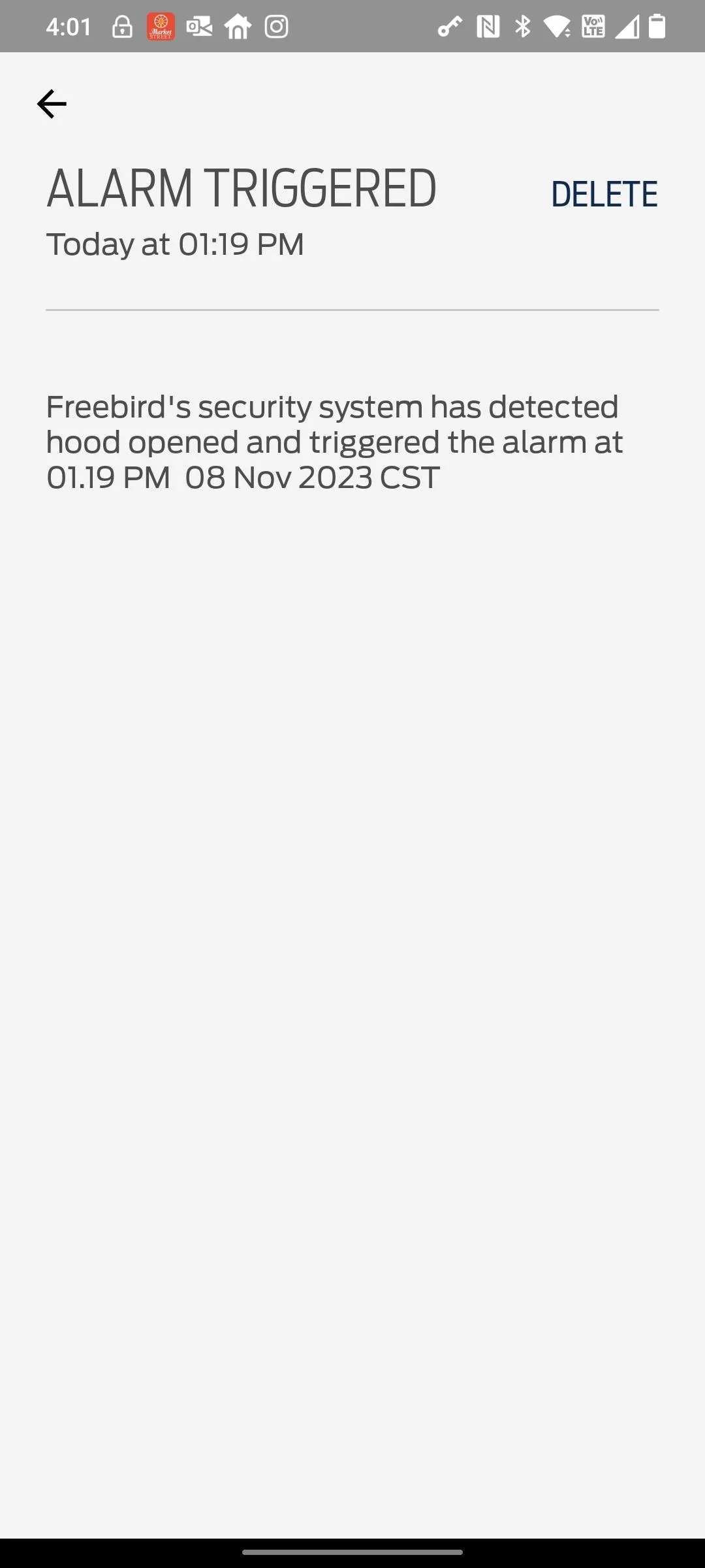

Just started happening to wife's '23 WT. Going down the highway it went off. The crazy thing is the vehicle doesn't have to be on. We were eating lunch on the patio and all of a sudden the alarm went off. The Ford Pass app alerted us that the hood had opened. Crazy that it malfunctions whether driving or not.
It’s the anti theft alarm. It should only activate when the key is off and vehicle is locked. While driving you only get a hood ajar warning on the dash.
Yes. Latch error causes hood ajar while driving, and alarm trigger when parked. Have to turn alarm off when it gets triggered.
