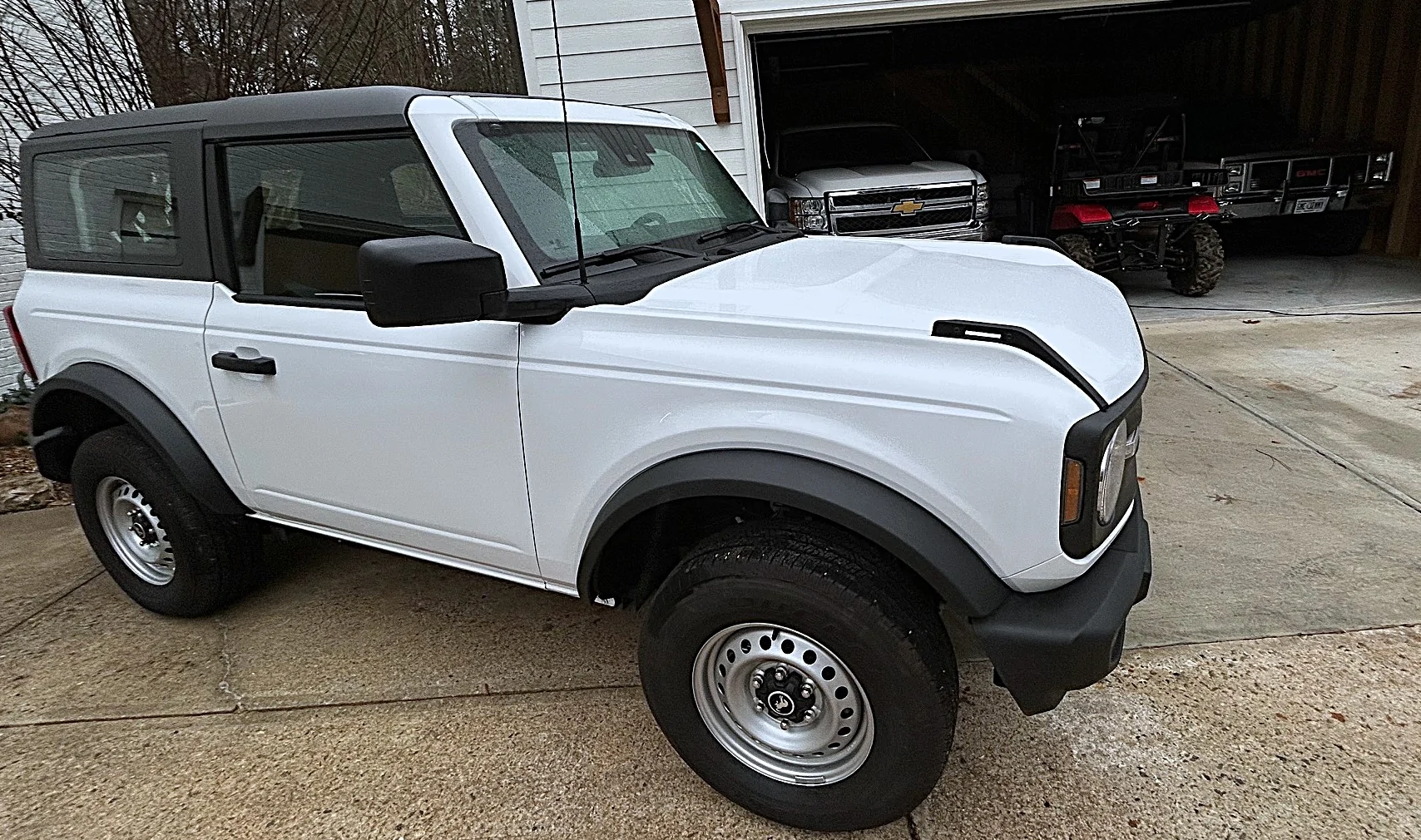

I just picked up a base desert sand for the wife. We bought a Big Bend 2 door sas when they first came out but sold it after 2 years. Wish we would have kept it. Since she was used to the big wheels and lift I am searching for the best option to go about mocking the SAS she had. Maybe do a 2.5 lift and 35s or 2” with 285s. It does have the smaller engine compared to the SAS and lower gear ratio. So what do yall recommend go big and do the 35’s? Mind you this is just a grocery getter/ beach cruiser. Thanks

2" and 285s. Get the look and good on/off road performance without the too much, too big issues.

Ahh crap, automatic ... I was just about to say the 4.46 gears will be fine with 35's, for the most part.
I know folks have done it, but I'd be leary of 35's with 3.73's.
I'd stick with 285/70-17 or similar size "33" inch tire.

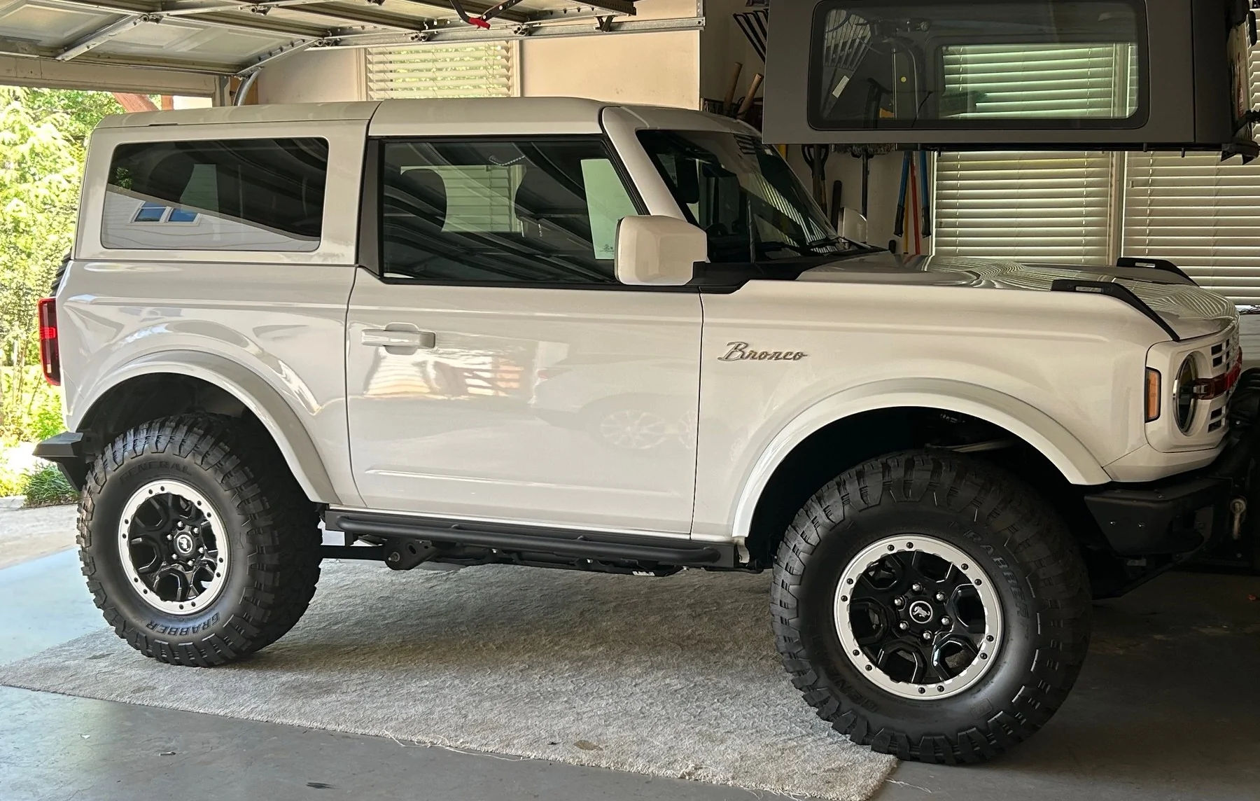

here's my 2023 Base Model Bronco with 2.3 and automatic. I added Bilstein 5100 adjustable struts, and Bronco SAS take off wheels with 315/70r17 General Grabbers
That’s sweet looking rig, where did you find the color match flares and top?
