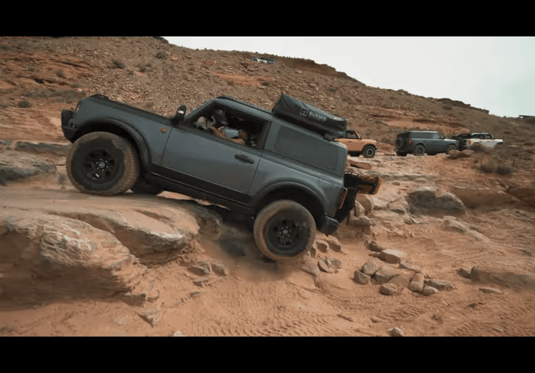

I overland with a 2 Dr and haven't needed anything. I think if I loaded any more gear I would be over my GVWR!

Any idea what weight you're at? Or roughly how much junk you are carrying? I'm heading to Moab for 3 weeks in less than a month. Want to make sure I'm still able to do moderate trails without bottoming out.
Hemisfear
Bronco Bob
Aug 21, 2020
1,187
1,368
Lotusland
2014 Focus ST
For the image (Poison Spyder/Moab) I had around 200lbs of gear, but for the trip I'd estimate 500lbs extra.
