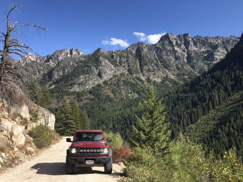

I have never noticed that with mine. I have driven thousands of miles on all types of dirt roads, usually in 4A, but occasionally in 4H. I rarely get over 60 mph on those dirt roads, but I'll go that fast on some of the straight parts.
I'm not sure what a "traction gain" is, but I would recognize a traction loss. Not something that happens enough for me to notice it.
Gratuitous photo of a place where it would be likely to happen if it were going to happen (but didn't):

By traction gain I just mean that the front wheels engage when the computer decides adding to your traction and that is not something that can be really anticipated.
