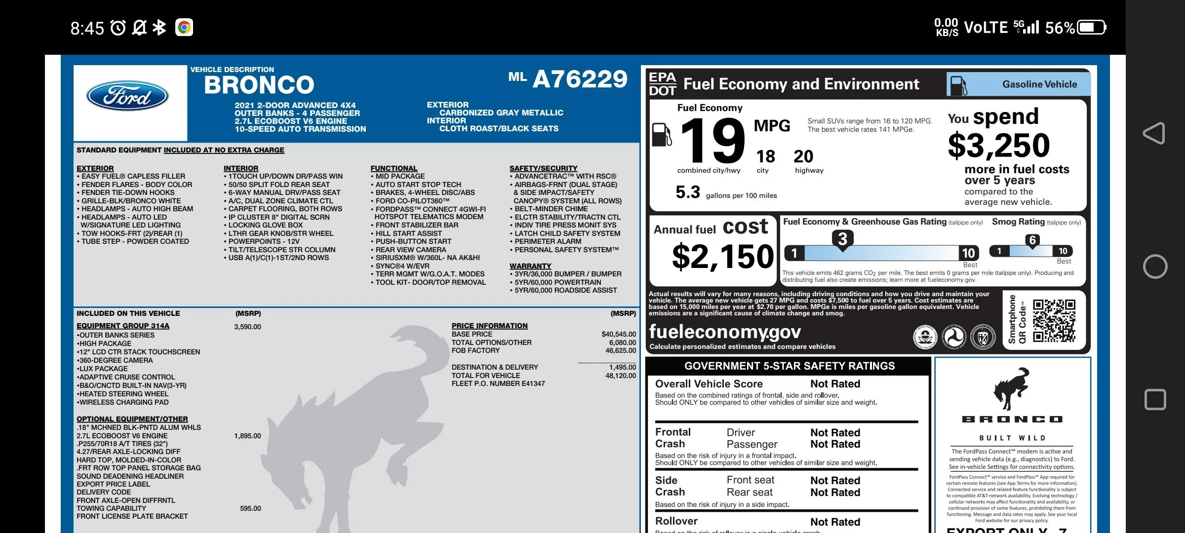

There is some wrong information on this thread. Only way to get 4A is with the Sasquatch pkg or get a badlands which it comes standard on.
Really? Tell me more expert.
Then explain this:
Ford Bronco Do I need Advanced 4wd (4A)? Screenshot_2023-02-20-08-45-57-920
Advanced 4x4 without Sasquatch.
