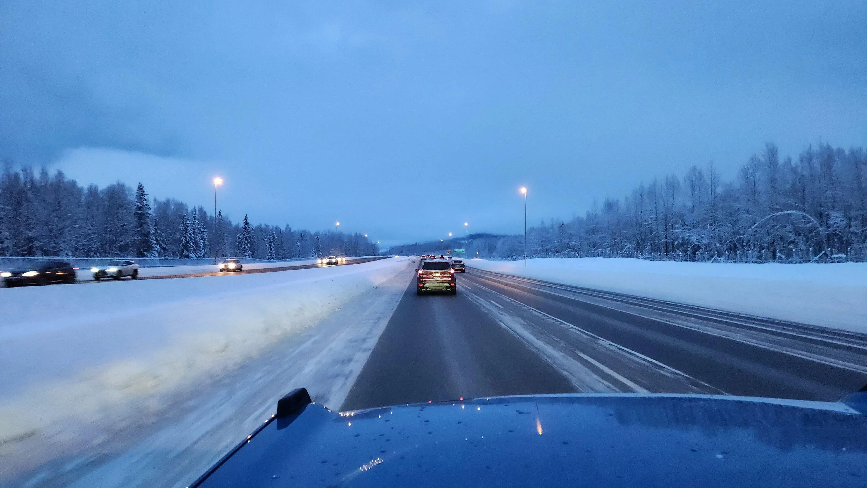

Fricking A... Seriously... I have been to Anchorage, I have been to Nome... funny, your snow and Ice is no different from mine. Like you illuded to that "pavement" in your photo is probably black ice. It allows differentiation (a small tiny amount of slippage).
Have you driven a locked differential or spindle on dry pavement? it spits, jumps, hops.... You hear it, you feel it, and if you are outside the vehicle you see it.
I bet you know what I am talking about. You are telling people that doing that between the front and the rear differential (inside the transfer case) is all fine! I have never had a problem!
That is what 4A is all about. It allows slippage (differential power) between the front and rear. Use it all day long on pavement year round if you want. 4H and 4L DO NOT! On dry pavement they create bind! It creates opposing forces inside the u joints/CVs, in the gears inside the transfer case, in the transmission and at the differential. That is not good for those gears and bearing surfaces. It prematurely wears them. Just because something did not break does not mean you did not cause damage! It accelerates wear! Meaning I would never ever want to purchase one of your used vehicles!
