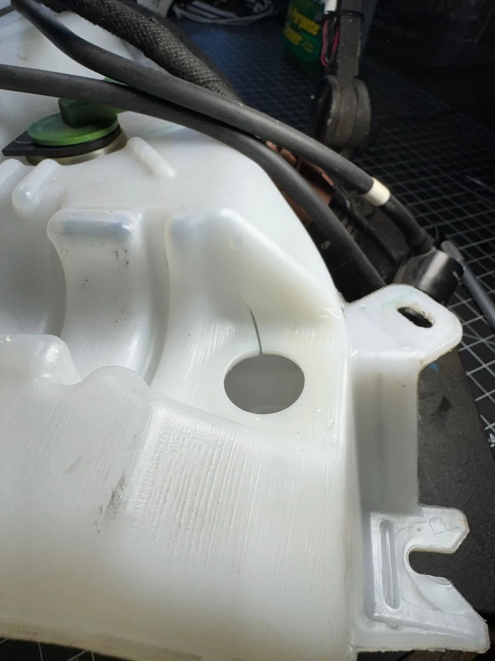

So I have the same problem! The tank is cracked and it being polyprop it will almost certainly fail if I try to repair it.
So I look everywhere online and local for the part number M2DZ-17618-A and yes its listed around $73. Most of the Ford pats sites list it as in-stock, but when you go through the entire ordering process they all say back ordered.
So I talk to the local ford parts rep and he says that order number is now discontinued and they've changed the order number to M2DZ-17618-B. Same part but the price is now $265-330 depending on the dealer.

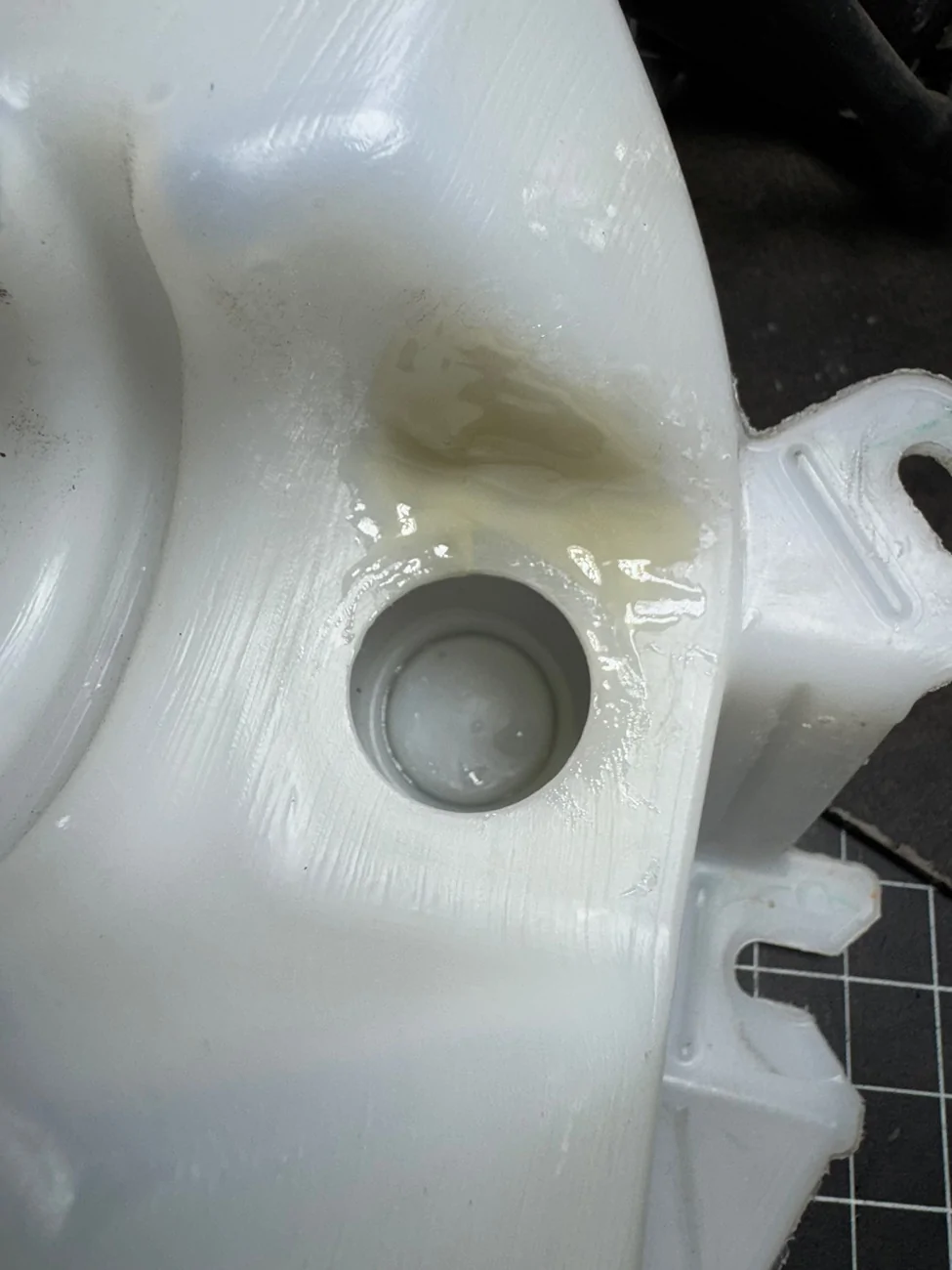

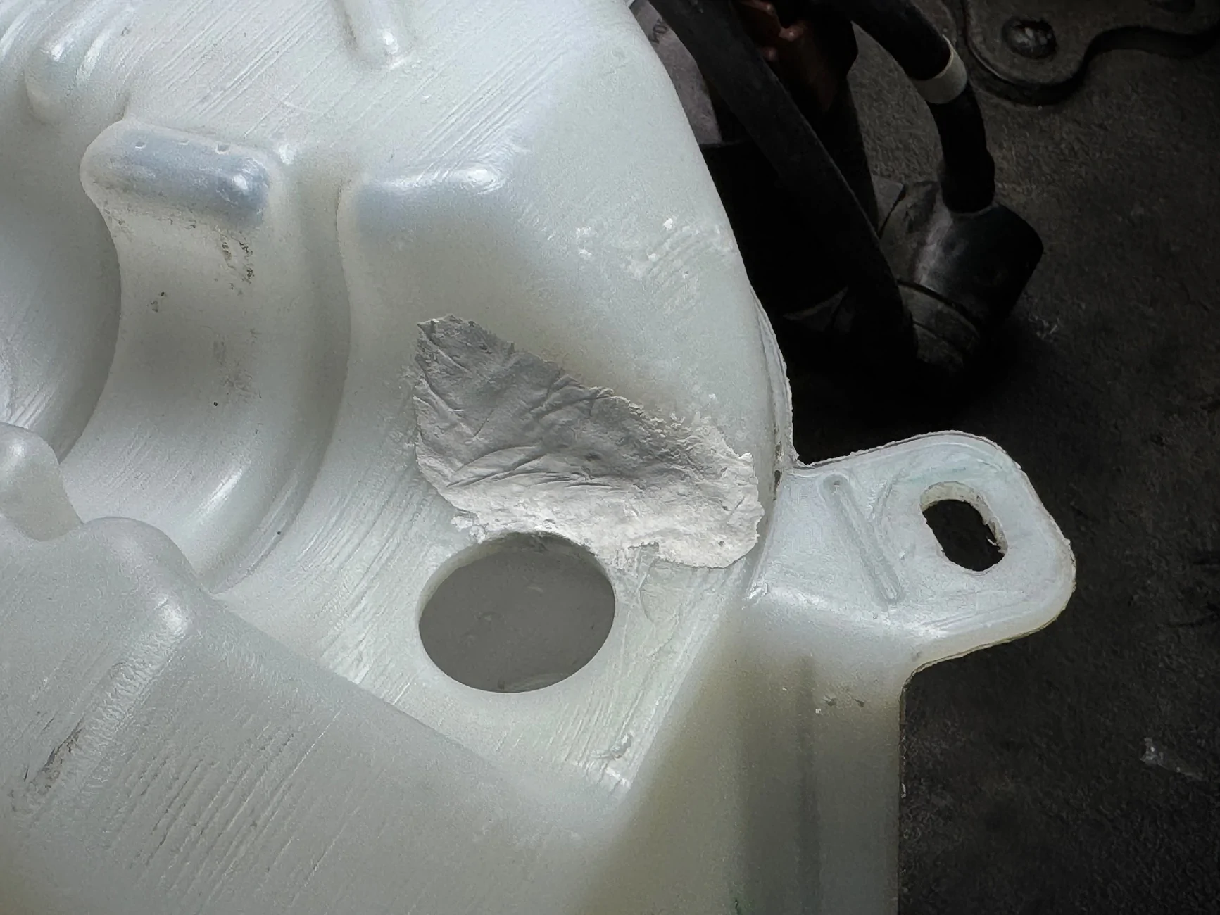

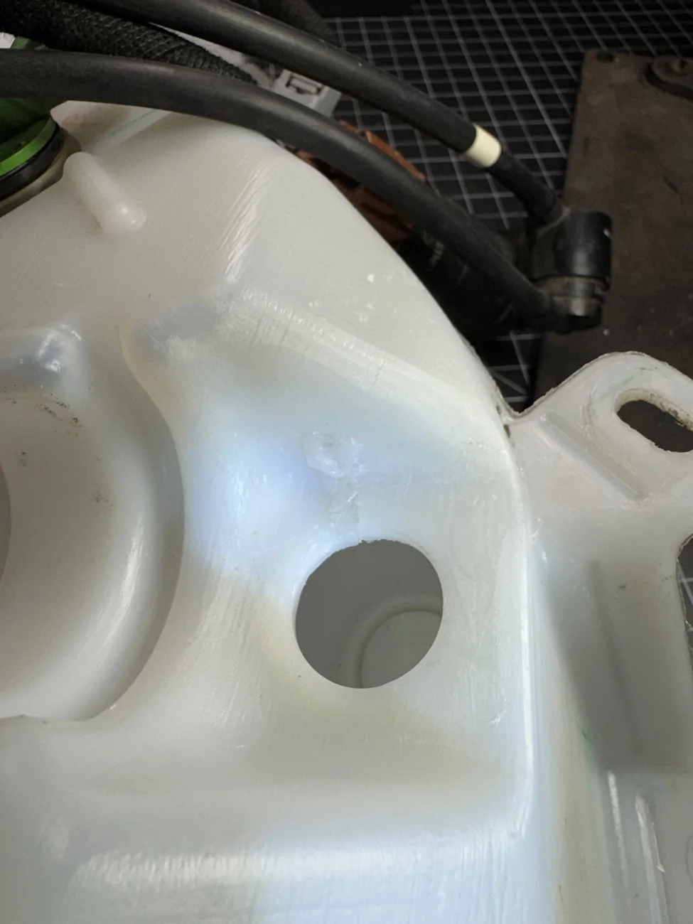

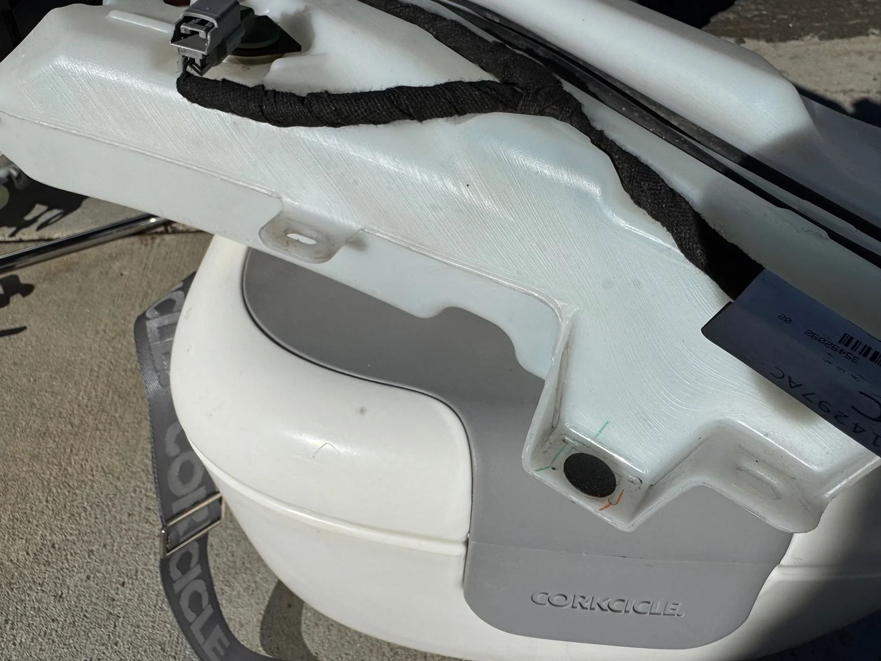

I found the solution for this issue. In a nutshell I plastic welded the crack. There are a few gussets on the tank which are super thick and probably over done. I cut a long thin strip from one of these to use as a filler rod. Then I used a butane torch, one for heating heat shrink, and heated the part up and used the strip of Polypropylene to fill it in. I cooled it off with a hand held high speed blower and tested it with some water. All is good. Took a bit of burping of the system to get it to charge the hoses but once it was done I got a $0 repair.
Of course that was after I spent 7 bucks on some plastic weld, and another 9 on some other plastic bond, and attempted to use a few versions of super glue. None of those will work BTW.
It's been about a month now and everything is working perfectly.

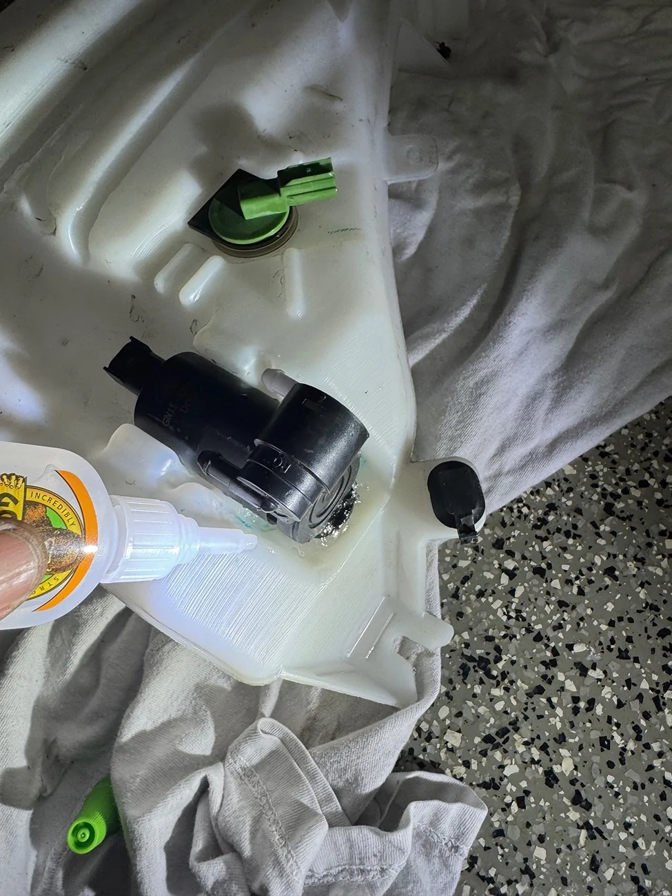

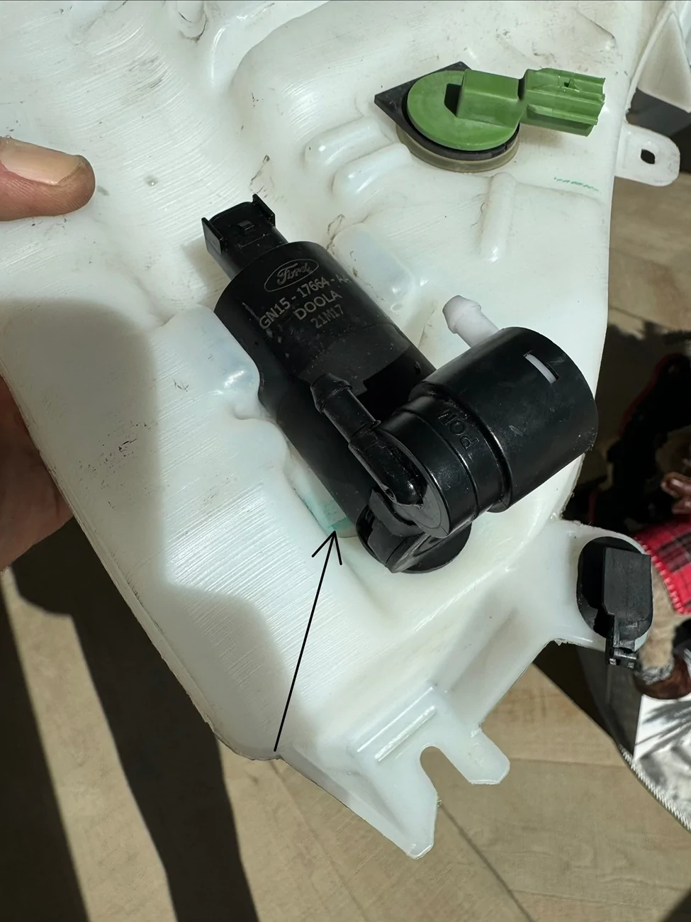

Appreciate the links above and commentary as I’ve had a leaking reservoir for 3 months on my ā€˜22 Wildtrak Bronco. I had similar crack as @Knownman around 9 o’clock at motor area-used some Gorilla Glue and no leaks.
Made a quick ~2min video on removing the tank, I couldn’t find one…
How is the gorilla glue holding up?
TexasFishDoc
Jan 28, 2023
46
2022 Bronco WildTrak
Still solid! No leaksšŸ‘

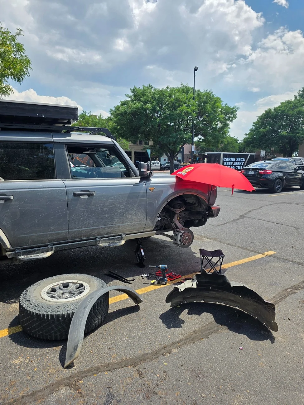

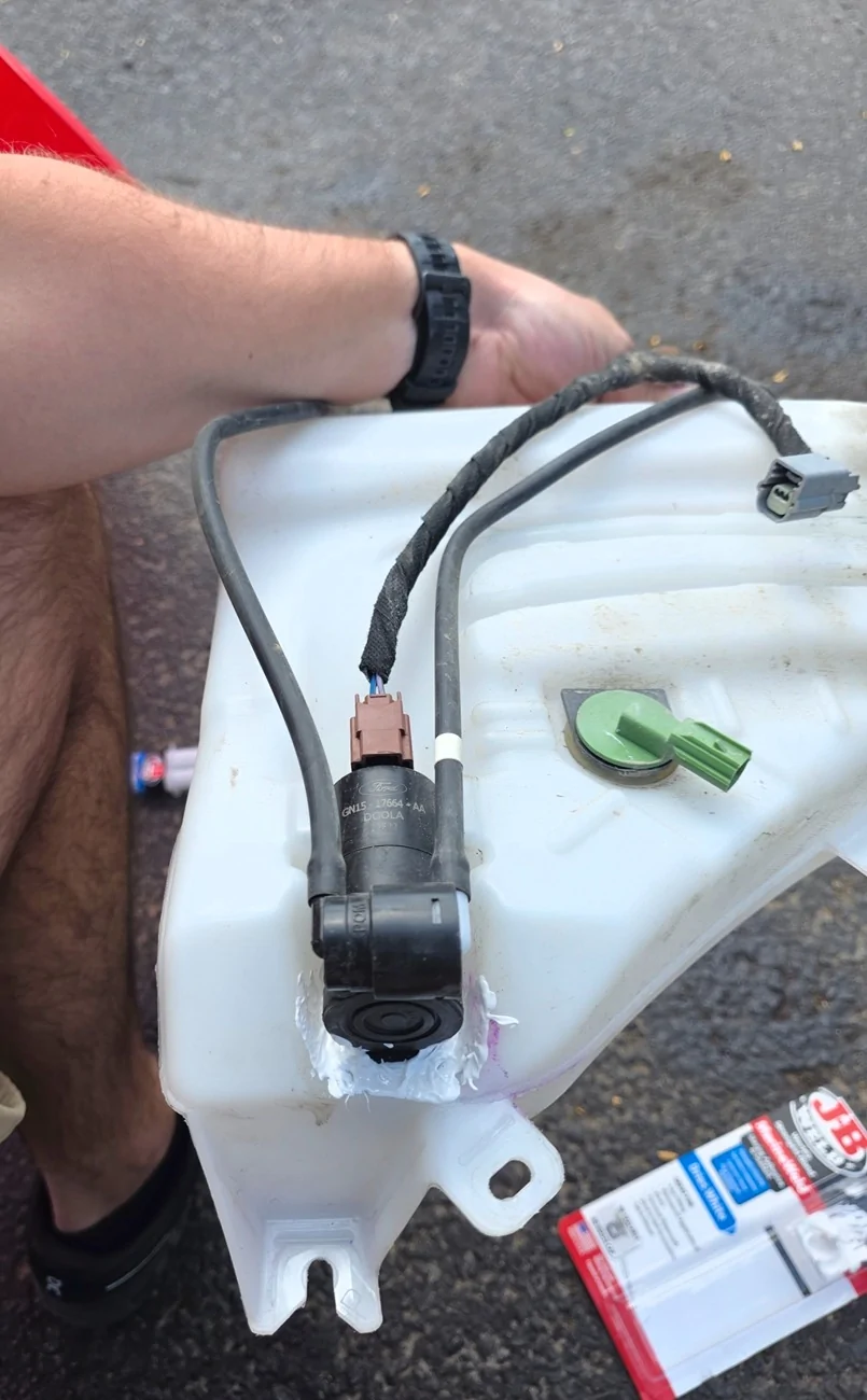

Had the same problem. Was on an overlanding trip so had to try and fix it at an autozone parking lot. Sadly after a week or so the leak came back, although at a much slower rate than before. Can anyone tell me how to remove the actual pump? I was afraid of breaking something so I just used the JB waterweld with the stick to try and patch all around.
