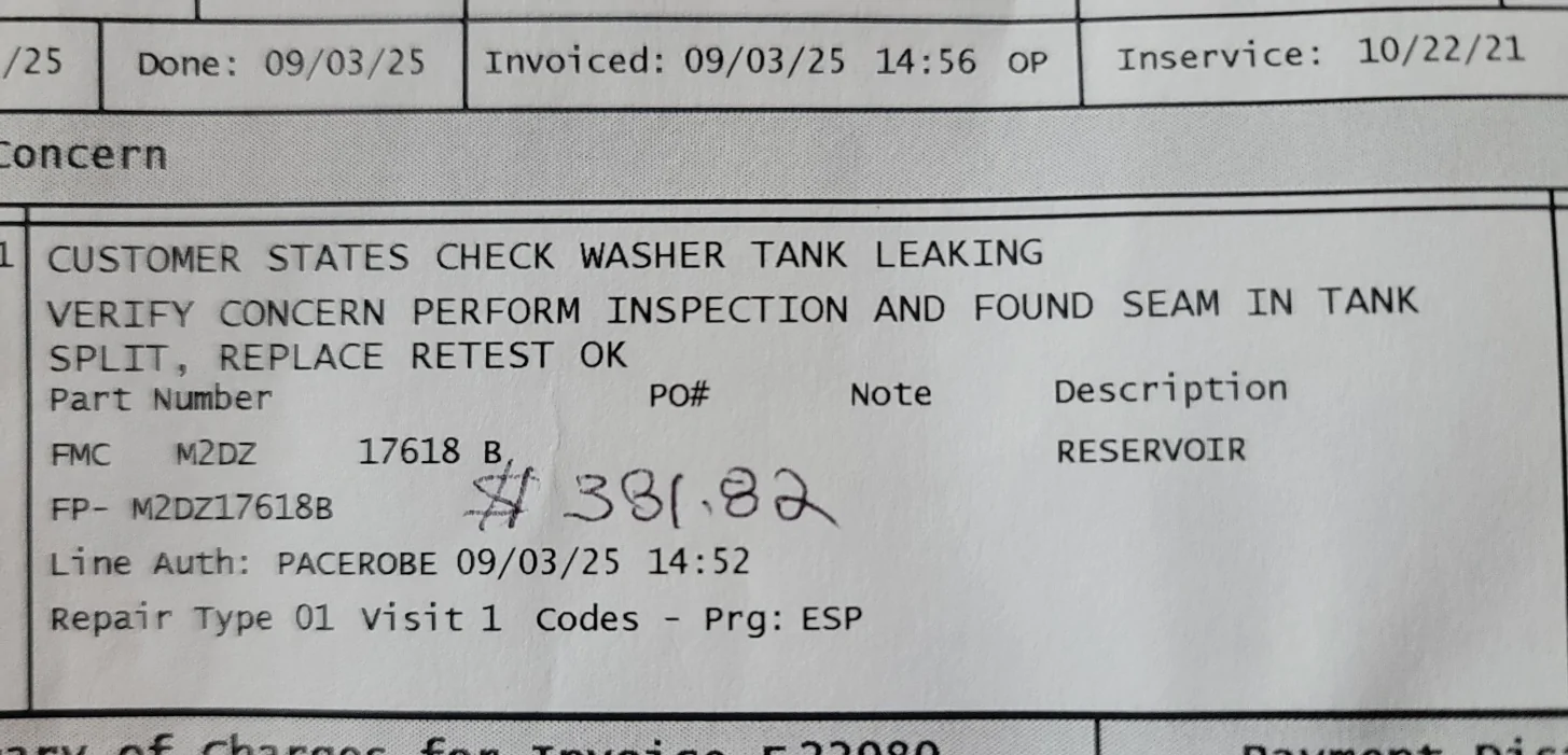

My 2021 washer tank split and repaired under extended warranty. Here's the part number from the invoice if that helps. And the price!
