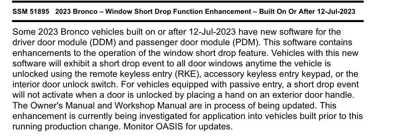

Broncos built before 7/12/23 do not have this feature.
Ford is working on making it available to earlier builds, but it isn’t out for all of them yet.

Broncos built before 7/11/23 do not have this feature.

This thread was informative about updating the DDM and PDM through Oasis at the dealership. Some have had it updated and work, you just have to explain slowwwly to the dealership what you were explaining it to a 4th grader.
I don't think this applies to 2 doors though.
https://www.bronco6g.com/forum/threads/new-2023-window-down-feature.85861/page-9
Terminology is a little mixed up. The DDM/PDM updates are done using FDRS, not Oasis. May help them understand a little better.

My 2022 bronco had some warranty weatherstripping done and just had this update/recalibration done to the windows. The only reason I know was because they only recalibrated the passenger side. I had to turn around to have the driver side done. I’m
