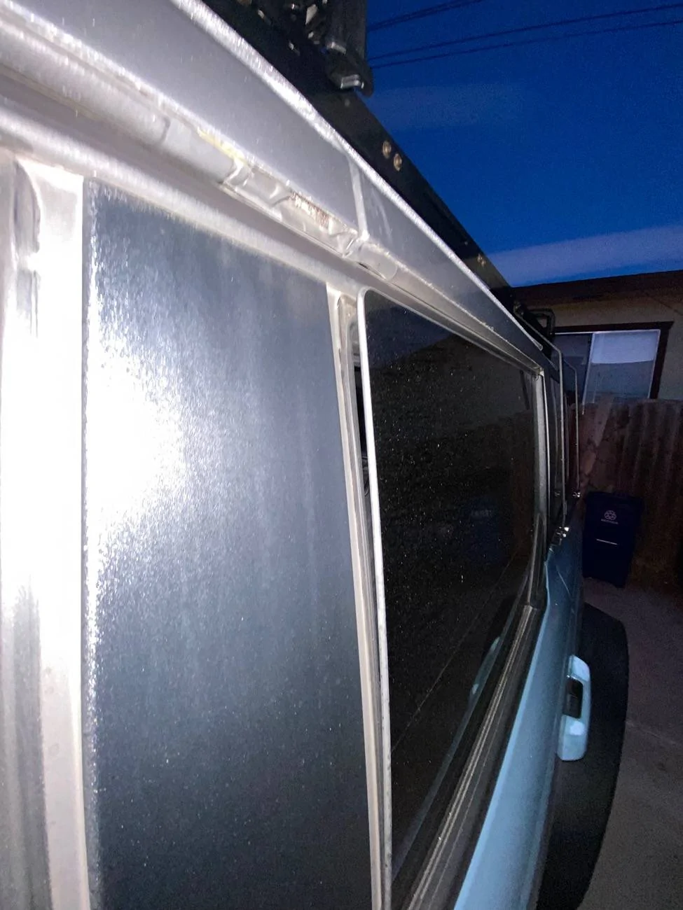

TLDR: Reset and Module update doesn’t work still have issues with rear passenger window getting caught and @Ford service/quality is đŸ’©
Had issues with my 2021 Bronco rear passenger window since 2022, past 6 months the issue happens daily where I have to reset the window every morning, took it into the Huntington Beach Ford dealership earlier this month and said it was a module that needed to be updated and they said they did the update and reset which I was 99% sure was not going to fix it, sure enough it happened the next day and was told to take it to the original dealership I bought the vehicle from to get it fixed because I first had an issue back in 2022.
2 days ago I took it back to Villa Ford in Orange and told them the issue and said the reset and module update wasn’t the solution it’s a mechanical/electrical issue, First thing the service advisor said to me after I explained the issue was is that an aftermarket roof rack trying to pin the blame on the rack as the cause of the issue and not have it warrantied
 which I responded it’s a @TrailRax roof rack which is supported by @Ford so that shouldn’t be the issue, then he goes on saying yeah it’s the hard top that’s the issue, well if it is then @Ford should be responsible to make a working hardtop and stand by its factory roof to not cause this issue or fix the problem lol
the tech did a reset and “module update” and said the other dealership didn’t do an update because if they did the tech at Villa Ford wouldn’t be able to do it so, Huntington Beach @Ford lied and didn’t do squat to my bronco other than do the reset which I have to do daily.
now I am wasting more time going back and forth with the dealership to get them to fix the window which at this point might just be to replace the regulator not some “software” update.
