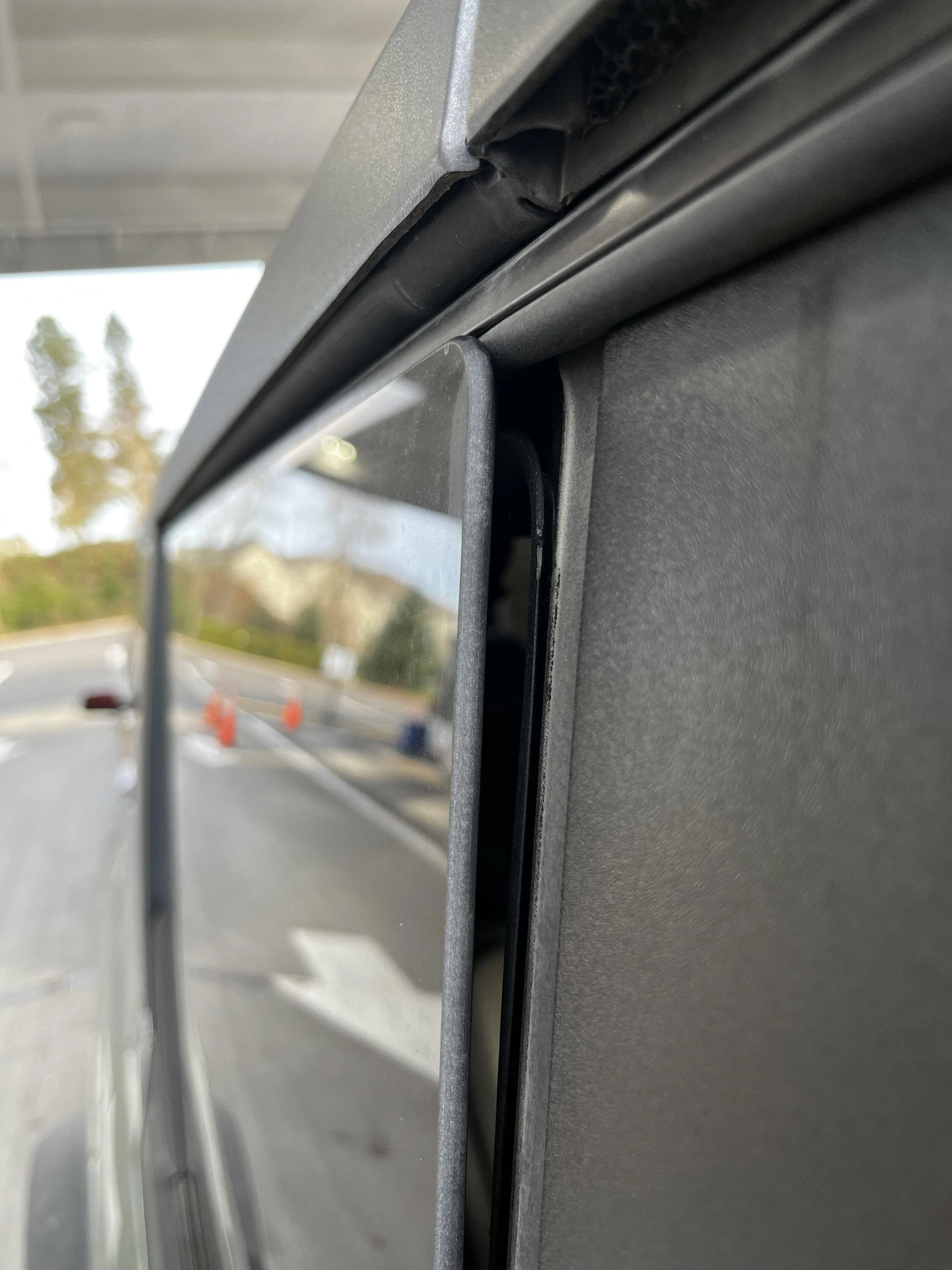

the problem I have had happen twice so far, and may be somewhat related, is that my windows STOP dropping when opening the door. And then when closing the door, the window is wedged open, and I have to manually drop the window and raise it again to properly seal the window.

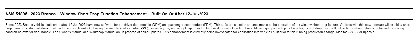

On 21’s there was no functionality of the window dropping other than physically opening the door itself. So the glass always catches some on the weatherstripping.
So once I saw how my loaner was functioning I searched and found this thread. Seemed like people were saying there could be a software update that might bring this to the early years. Was checking to see if anyone had successfully made that work.

Is there an update for 23's 2 doors to do this when unlocking the vehicle?
