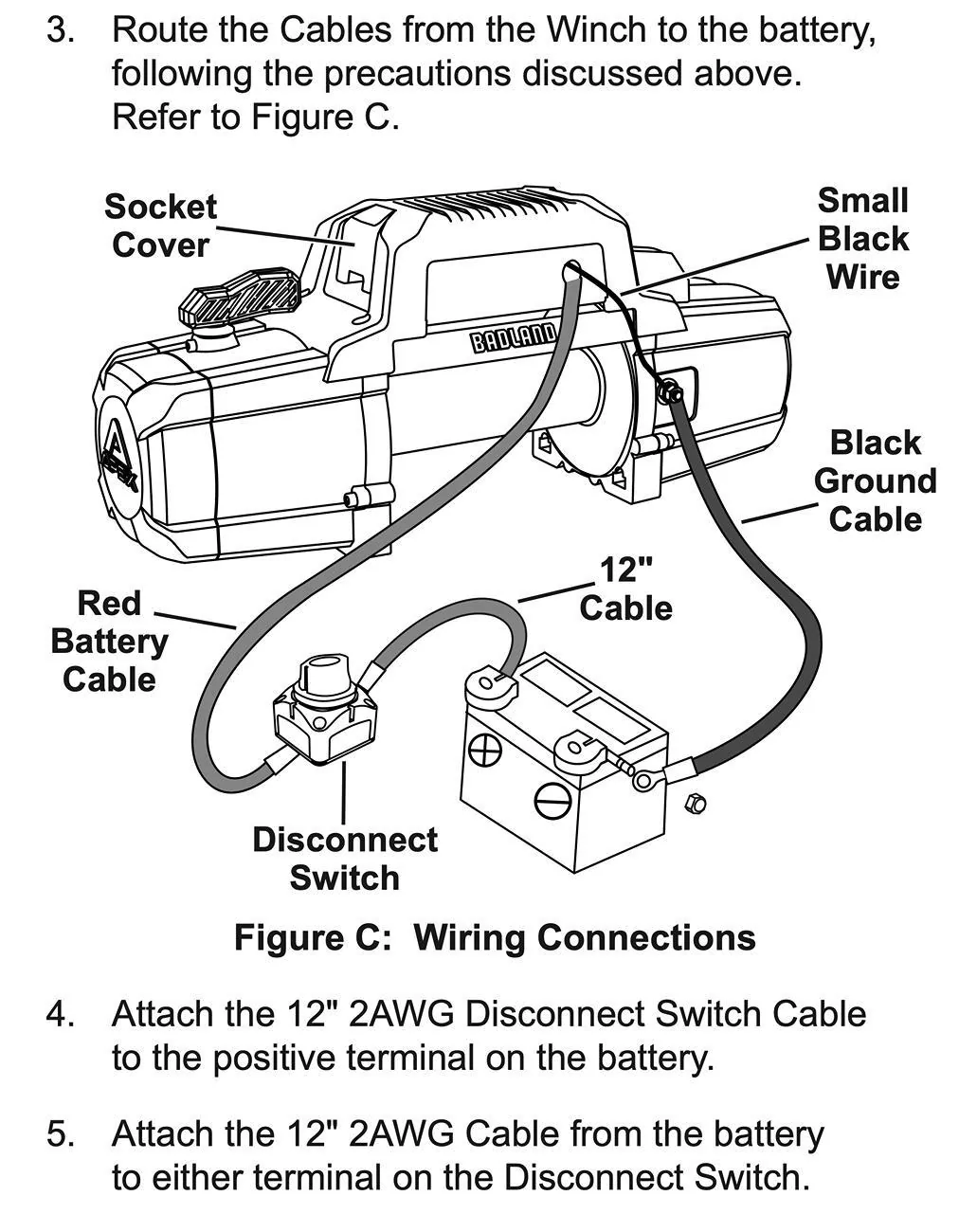

The diagram on the switch is to illustrate (perhaps poorly) that it's for a battery disconnect.
Regardless the instructions appear to be pretty clear to me. Especially the warning that if you don't know what you are doing, you shouldn't do it.

Looking at the switch, I only see 2 terminals there, but you say you wired (+) and (-) to it.
the switch is just to interrupt the (+) - there shouldn’t be any (-) at all to that switch.
(+) from battery to switch. From switch to (+) on winch control box. (-) on winch to chassis or battery ground. That switch does not have a solenoid operator, it’s just a manual disconnect (the diagram @HoosierDaddy posted would be for a relay type connection with a remote cutoff). Place the switch as close to the battery as you can conveniently mount it.
so.. how exactly did you connect the wires and … did your battery jump, explode or pop when you flipped the switch.
If you direct short the battery without a fuse it’s fairly dramatic
Lol that’s pretty clear that you shouldn’t dead short your battery to the switch 😂
sorry OP, have to laugh. Thankfully you’re okay and didn’t cause any damage to yourself or property.
edit: I lied, I see that switch, wtf is that!! I’d send that to HF, that’s confusing AF.
It's not that confusing. It's a drawing of a battery not a schematic on the switch.
It's an expensive test to see if you should be working with electricity or not...
