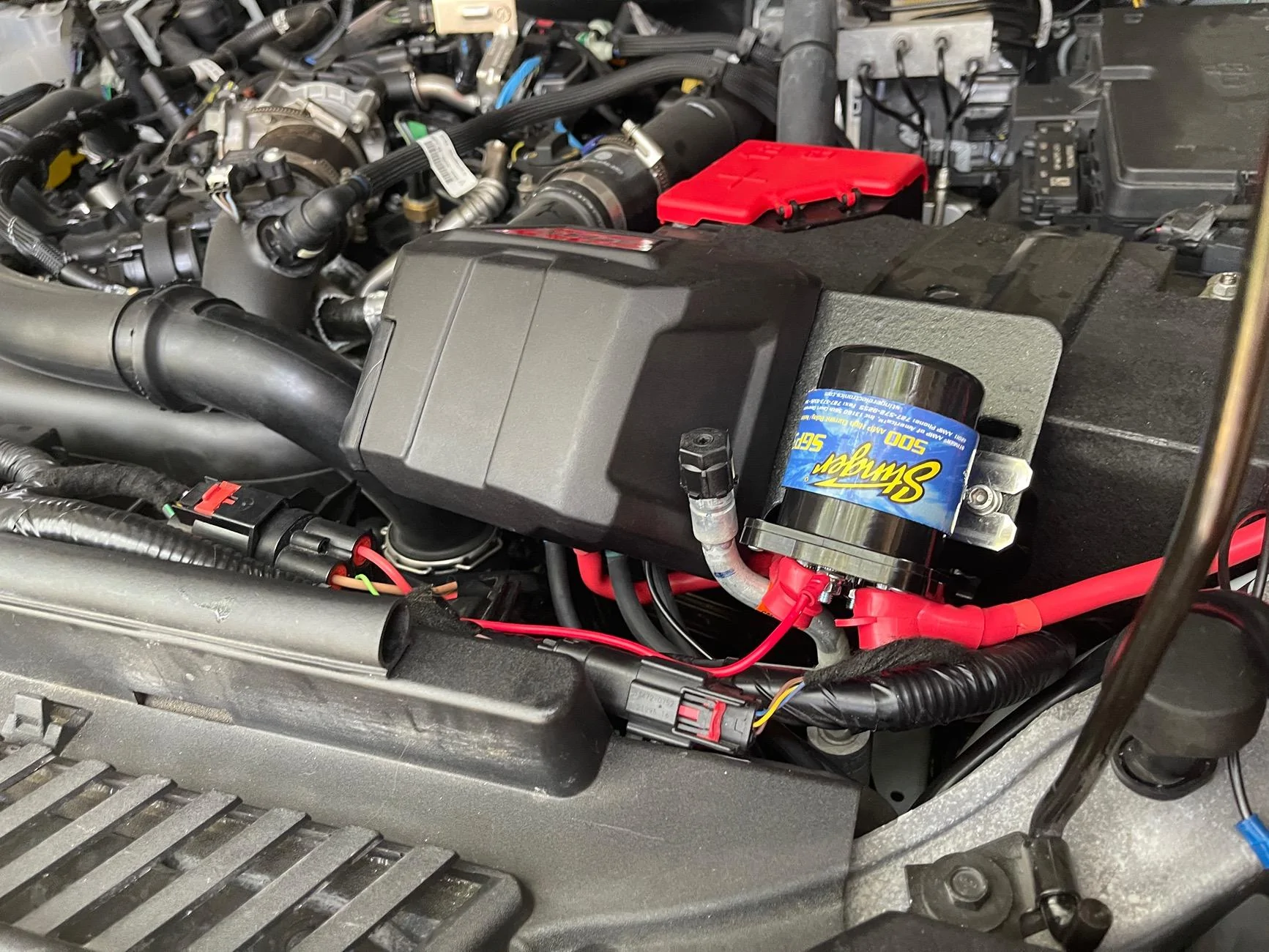

On a good note, it reminded me I needed to buy a Stinger relay as I am getting ready to finally install my winch. I got two of my higher amp up fitters that I wont be using for any roof lights so gonna utilize one of them.
I used a Stinger with my winch. I used an aux lead that is above grill on that side. I spliced the other end to Aux3 switch lead (both are near hood hinge on driver side).
