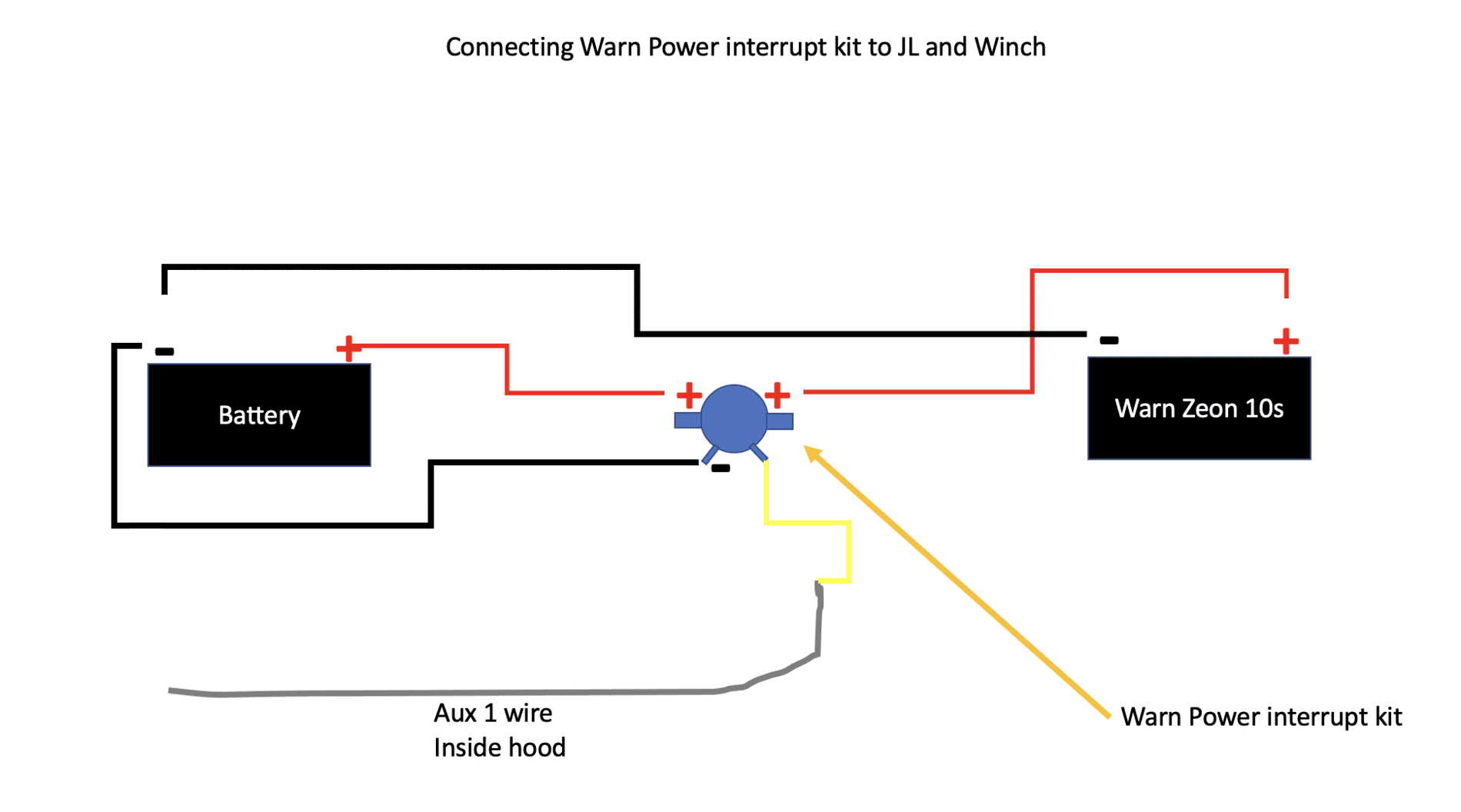

sometimes that diagram i posted shows ....sometimes not .... B6G gremlins.
Trying to fix THAT now!!! LOL

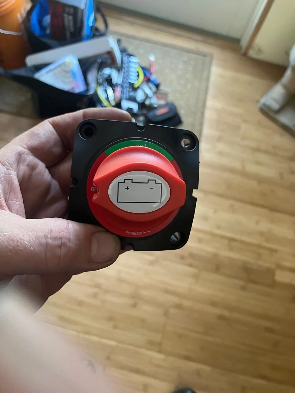

Ok - I'm gonna have to go buy a volt meter. I'm at the lake house and can't find in here.
The winch comes with a switch, which I mounted in the engine comp. + and a - wire from the winch to the switch. Then + and - wire from the switch to the battery terminals.
it's a Badland Apex from Harbor Freight.

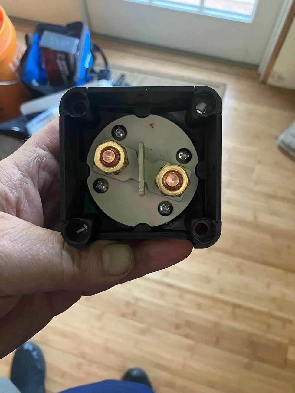

Looking at the switch, I only see 2 terminals there, but you say you wired (+) and (-) to it.
the switch is just to interrupt the (+) - there shouldn’t be any (-) at all to that switch.
(+) from battery to switch. From switch to (+) on winch control box. (-) on winch to chassis or battery ground. That switch does not have a solenoid operator, it’s just a manual disconnect (the diagram @HoosierDaddy posted would be for a relay type connection with a remote cutoff). Place the switch as close to the battery as you can conveniently mount it.
so.. how exactly did you connect the wires and … did your battery jump, explode or pop when you flipped the switch.
If you direct short the battery without a fuse it’s fairly dramatic

Sounds like you shorted the battery if you connected both positive and negative to that switch.
Yep - that's what I did. I fucked that up big time. Off to the auto parts store for a new battery....
