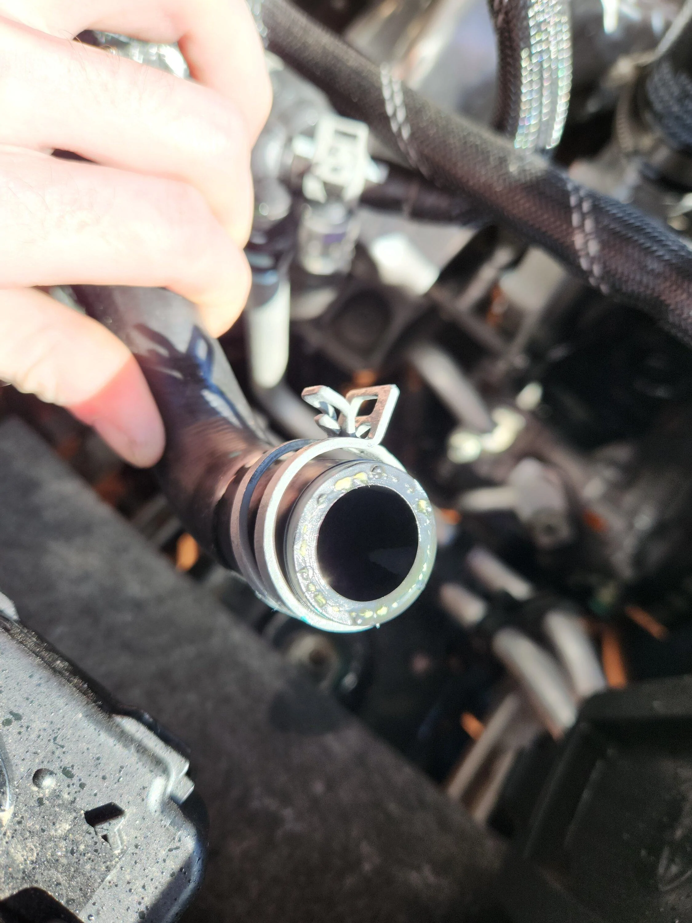

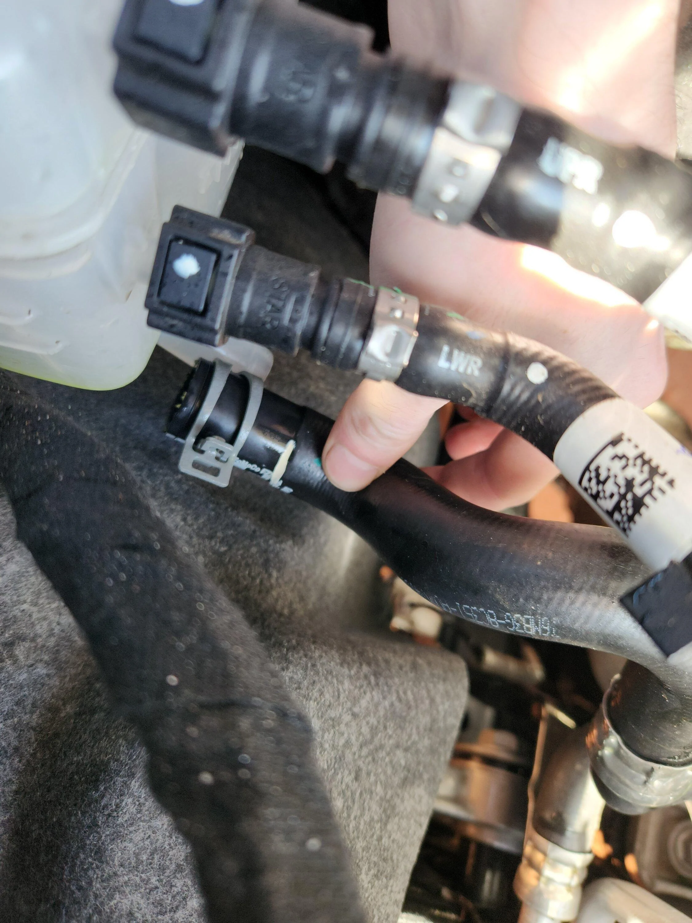

Drove the 23 badlands 2.3 down to Moab this weekend. Just over 1000 miles on it and no problems to this point. About two miles into our first trail (Gemini Bridges) we had a eruption of steam from under the hood. Eventually we found the hose going to the coolant reservoir had come off. It looks like the clamp was never released from the factory. We got it back on, refilled the system with water and was able to continue. Definitely something to look out for. Otherwise we had a great trip and the bronco did great through Hells Revenge

Something like this happened to another member, ironically also in Moab. Hose came off and they dumped all their coolant so quick it didn't get a chance to actually overheat. I think they ended up in limp mode back to civilization
