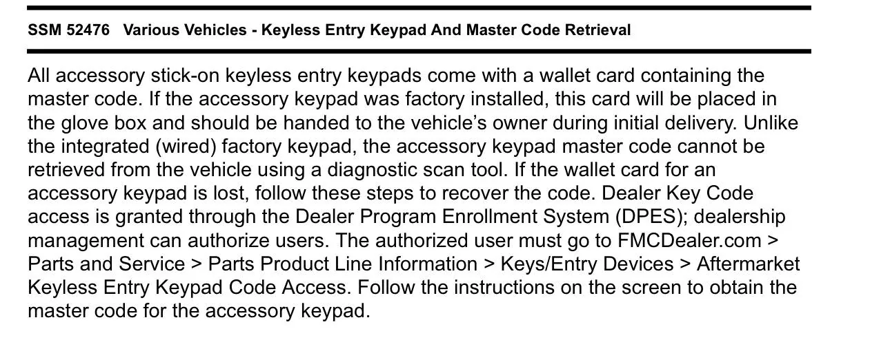

Ducati1098
9,964
23,152
Midwest
The only way to get the master code is from your dealer. FDRS, forscan, none of that will work.
Like previously mentioned, the card located on the BCM has absolutely nothing to do with the keypad.

Edit: Or you could try the thing @Brian_B mentioned where you just start entering a bunch of codes until you find the correct one. But that’s the only way around having a dealership retrieve it.
